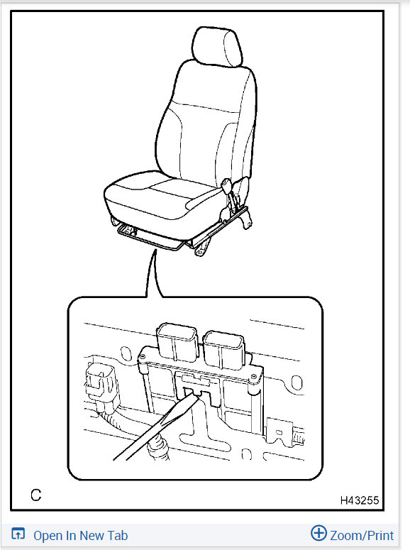

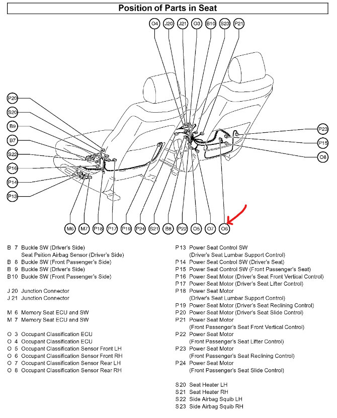

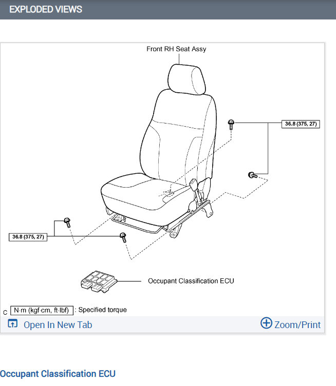

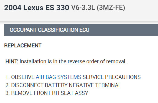

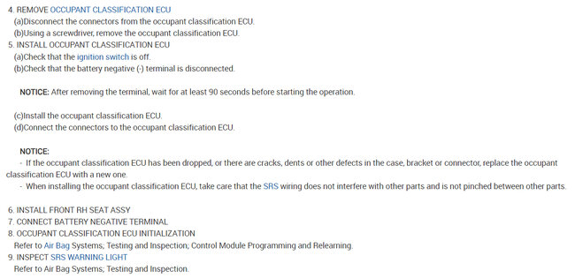

Yes, this is the sensor in the passenger seat which has gone bad, here is how to change it out:
B1615: This code usually indicates a malfunction in the front occupant classification sensor.
B1650: This code typically points to a problem with the occupant classification system.
