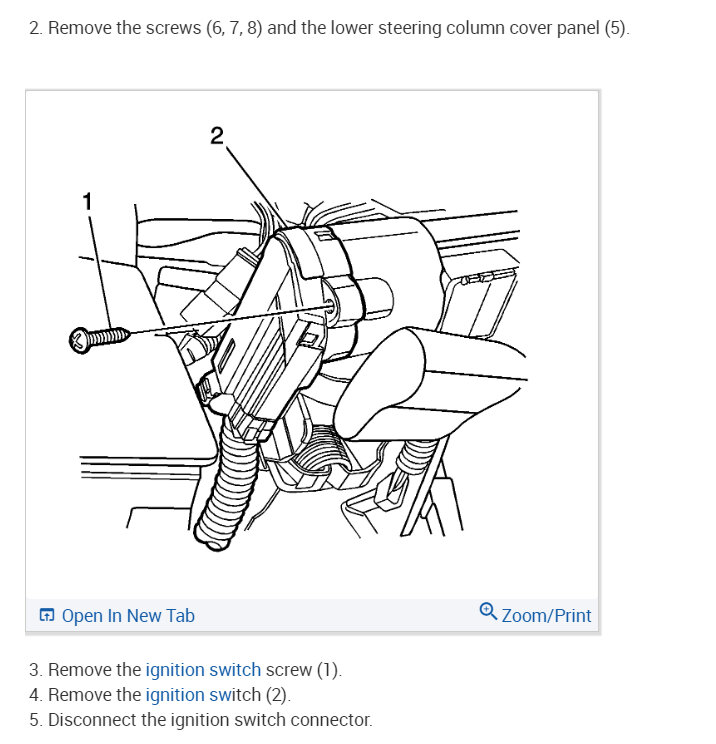

I have a 2007 TK Barina sedan that has a constant SRS light on, the displayed code on the reader was B1353, I cannot find what this code specifically relates to or how to clear it. Any help would be greatly appreciated.
Mar 12, 2023 at 2:17 PM
  • 55,433 POSTS

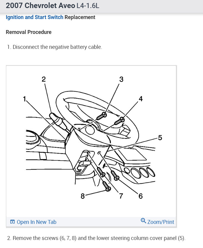

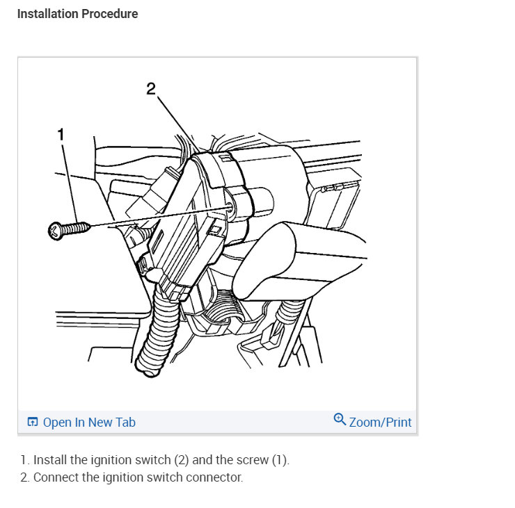

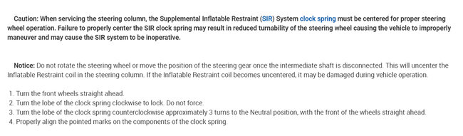

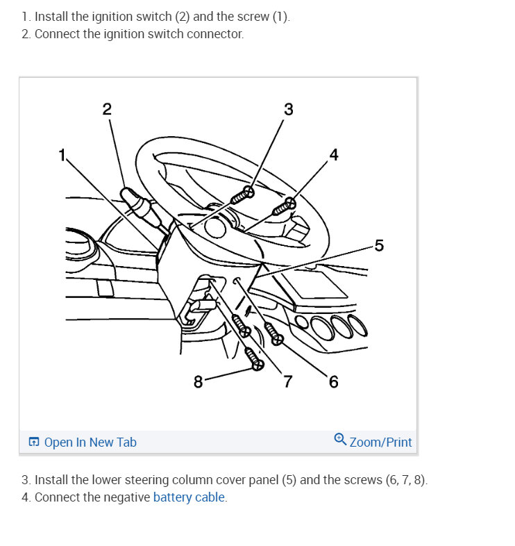

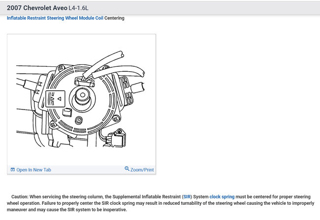

B1353 is a diagnostic trouble code related to the ignition key-in circuit. So, it sounds like the spiral spring behind the steering wheel needs to be replaced. Here is the instructions on how to do the job in the images below, you will need to remove steering wheel first. Also, this can be two problems in which case you will need to replace the ignition switch as well. Check out the images (below). Let us know what happens and please upload pictures or videos of the problem so we can see what's going on.
