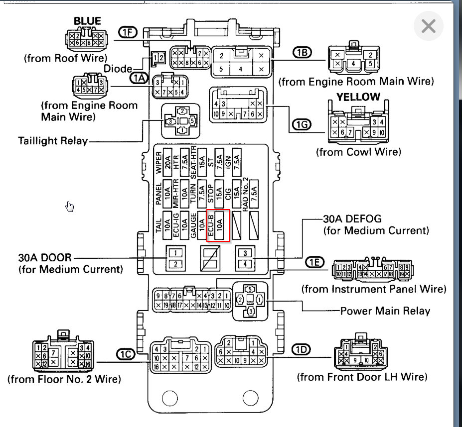

Recently purchased the car listed above TT 6 speed. For some reason, when I start the car the airbag/SRS light does not cycle like it should. It just stays off. I’ll fail state inspection until it cycles properly. How do I diagnose and or fix ?

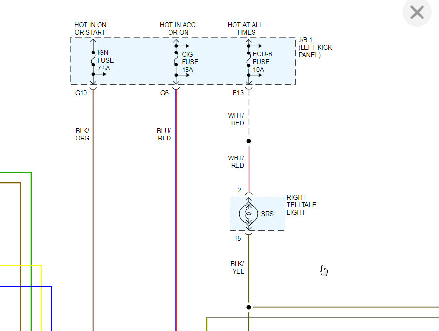

This is more than likely one of two things. It could be the fuse or I believe the bulb for that is replaceable like the others in the cluster. Let's start with checking the fuse and going from there.

Yep, bulb missing.
Part Number: 83119-24070 For those who need it.
Now, let’s see what the real issue was. Guessing crash data never reset.

Well that will do it. Thanks for the update. Let us know if you need help figuring out the issue. Its a pretty good assumption that there is an issue which is why it is missing.
