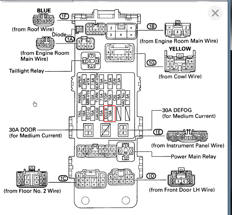

Recently purchased the car listed above TT 6 speed. For some reason, when I start the car the airbag/SRS light does not cycle like it should. It just stays off. I’ll fail state inspection until it cycles properly. How do I diagnose and or fix ?

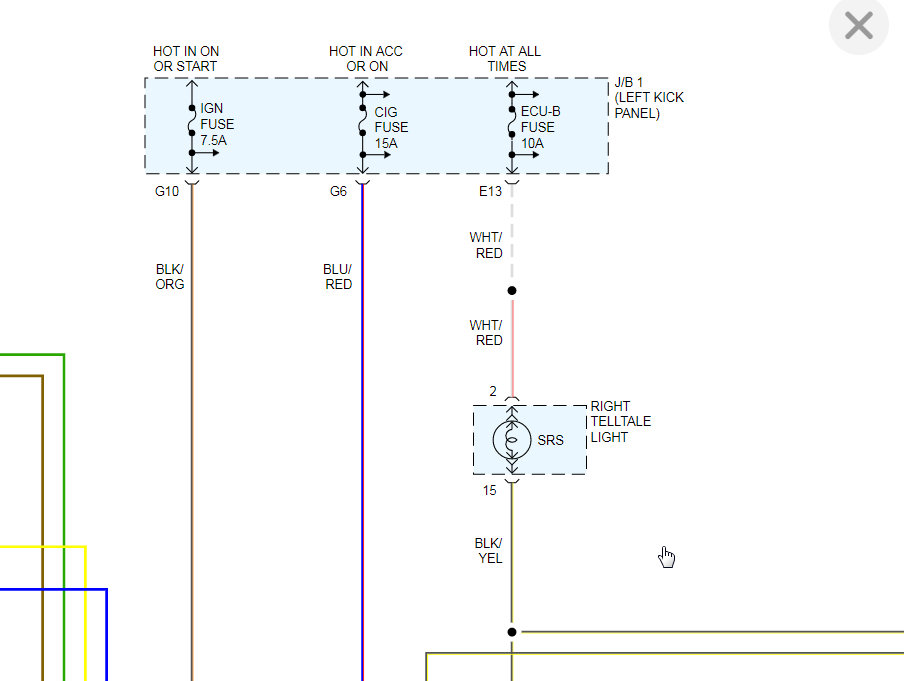

This is more than likely one of two things. It could be the fuse or I believe the bulb for that is replaceable like the others in the cluster. Let's start with checking the fuse and going from there.

Yep, bulb missing.
Part Number: 83119-24070 For those who need it.
Now, let’s see what the real issue was. Guessing crash data never reset.
Jan 11, 2020 at 6:51 PM
Well that will do it. Thanks for the update. Let us know if you need help figuring out the issue. Its a pretty good assumption that there is an issue which is why it is missing.
