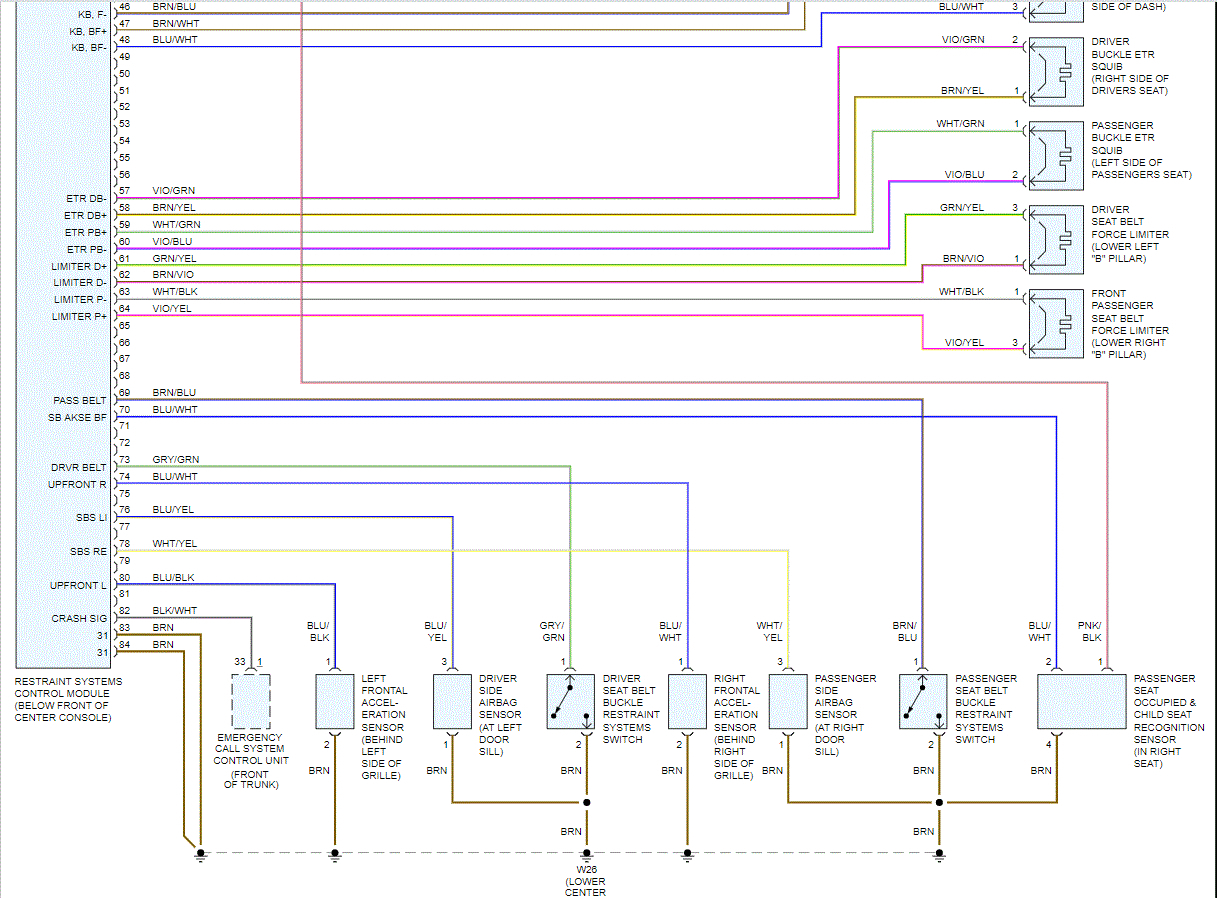

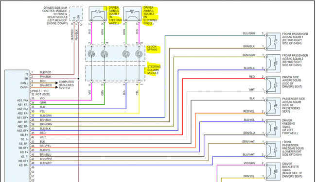

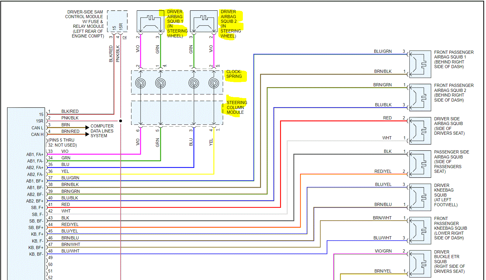

Also, I attached the schematics for the supplemental restraining system. I had to cut it in half to make it readable, but I did overlap them so you can follow from one to the other.
I highlighted the airbag squibs. Note that they both go through the clock spring to the steering column module. From there, they go to the restraining module. My first thought is the clock spring.
