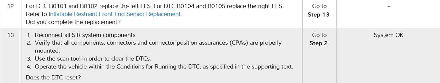

SRS Code and airbag light is on
2005 GMC ENVOY
189,000 MILES
DTM
Hi, my airbag light is on and the code is B0101 open in d squib . I have tested the airbag and the clockspring harness and both appear to be good (shorted when shorting pins are touching and open with resistance when pins are clear ) .
Any thoughts on this ?
Thanks !
Dec 8, 2016 at 3:37 AM
HMAC300
  • 48,601 POSTS
101 is electronic front sensor. see picture for instructions on what to do, but it should be replaced or short in that wiring. there is a campaign from front leather seat covers replaced that messes up the SRS they are aftermarket and it does effect 2005 Envoy, but was written in 2007 last vin is 52133749-52383526.

Thank you very much for your quick reply . Is there a test procedure for that front sensor that you are aware of ?
Thankyou !
Dec 8, 2016 at 4:59 AM
HMAC300
  • 48,601 POSTS
not that i am aware of unless you check the wiring and find that messed up via ohms to module.
