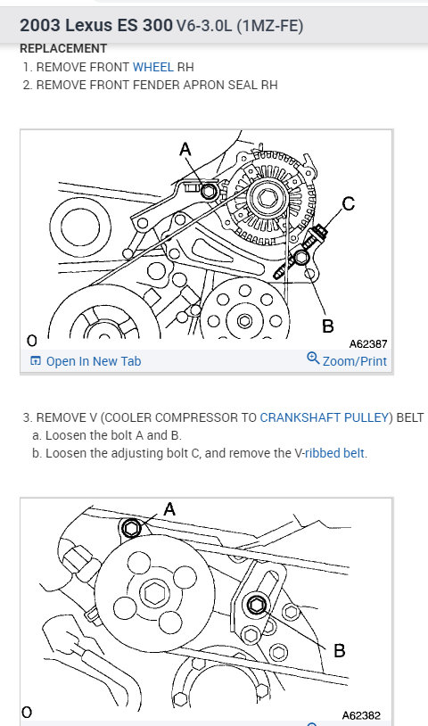

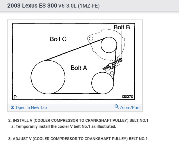

Upon cold startup there is a squeal only if A/C is on?
2003 LEXUS ES 300
133,500 MILES • 2.6L • 6 CYL • 2WD • AUTOMATIC
ROKSTENHA
The squeal stops when I rev the engine or turn A/C off. No squeal after engine warms.
Aug 6, 2022 at 12:20 AM
SQM
  • 6,383 POSTS

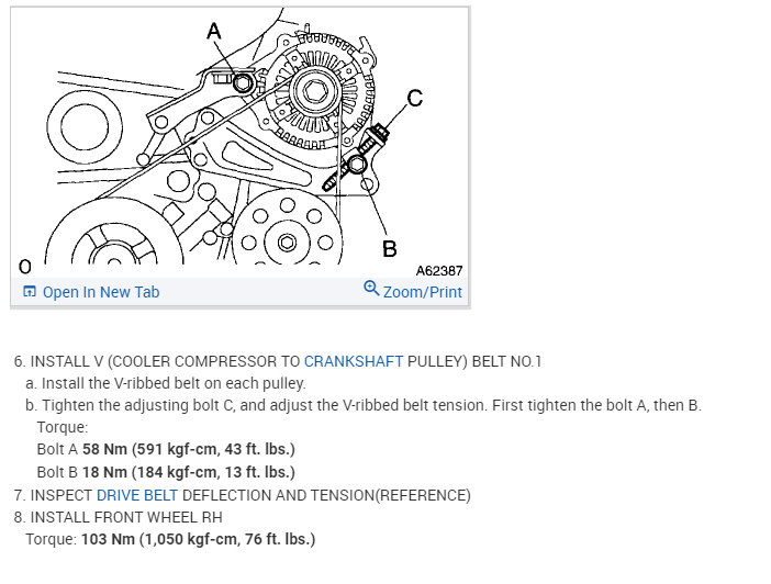

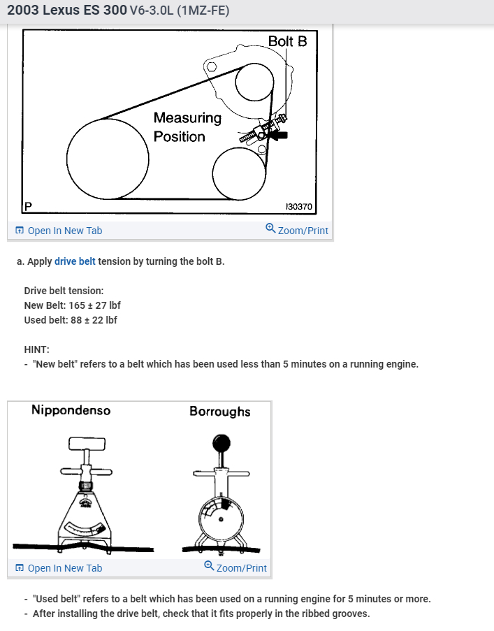

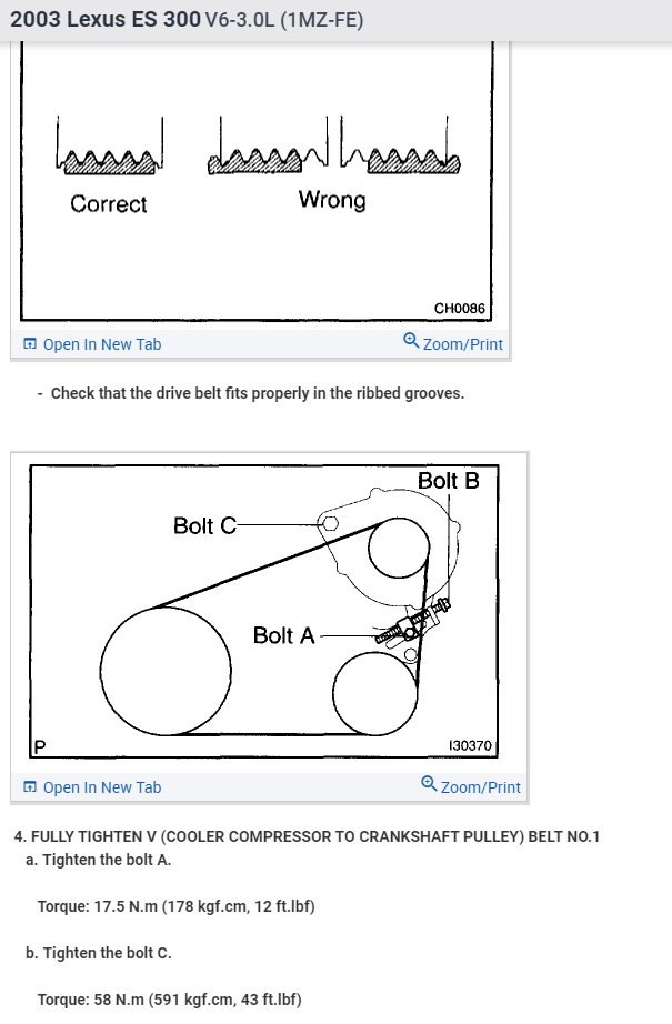

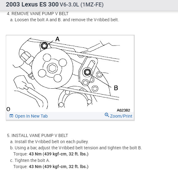

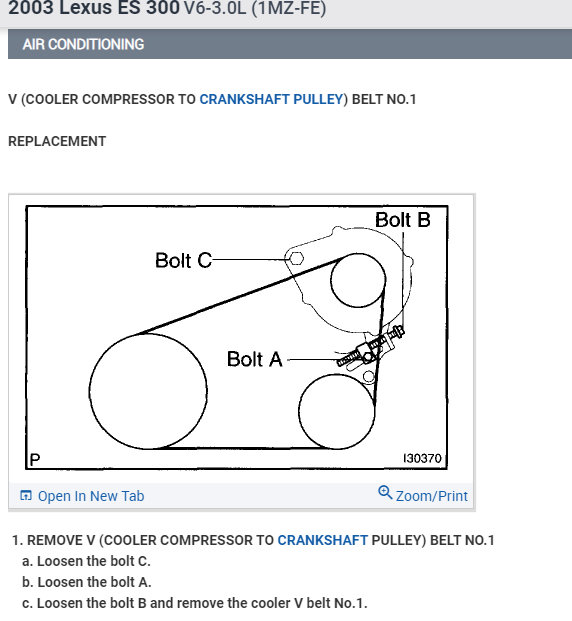

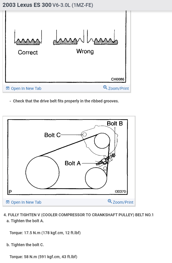

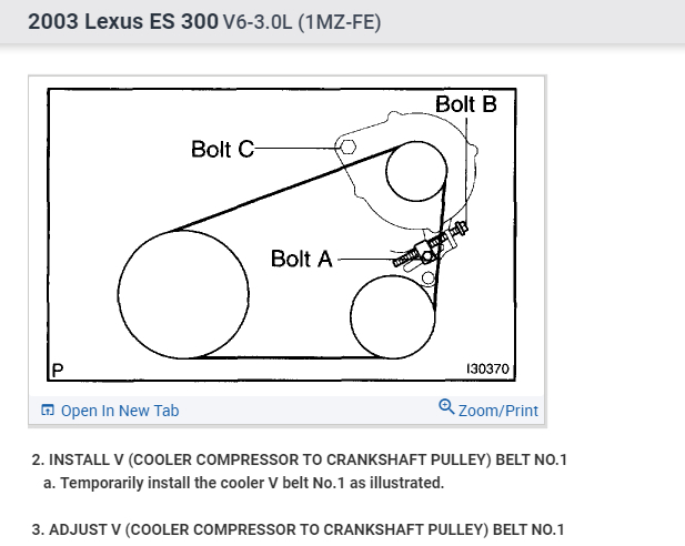

It sounds like the belt is worn and making that noise. If the squeal goes away after the engine has warmed up it is a sign of a belt that is slipping just enough to make the squealing noise. This is typically noticeable when the engine is under load, like when the A/C is on.
Take a look at this helpful guide:
https://www.2carpros.com/articles/car-squeaking-noise
I have attached the belt replacement procedures below for your reference.
Let me know of any questions.
