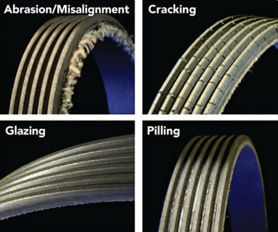

To check I have added a diagram on common belt issues. I would look more at glazing and the condition of the grooves. Modern belts don't crack, because they are made of a different material called EPDM so you might not see that depending on the last time it was changed.
When checking the pulleys pay extra attention to the flat ones and see if they have been smoothed out or look shiny. This could tell you where the belt might be slipping and could indicate an issue with that component. You can try using some emery cloth or fine grit sandpaper lightly to take the shine off them so the belt will grip the pulley better.

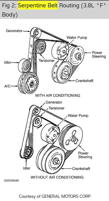

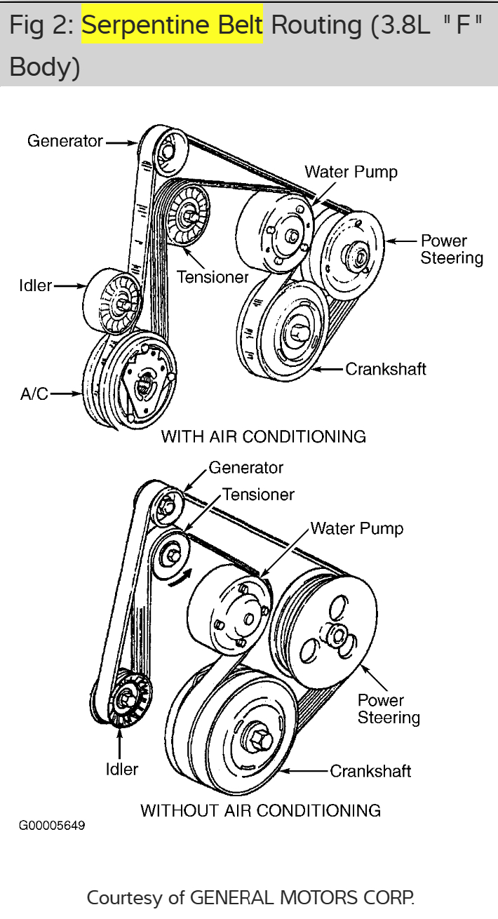

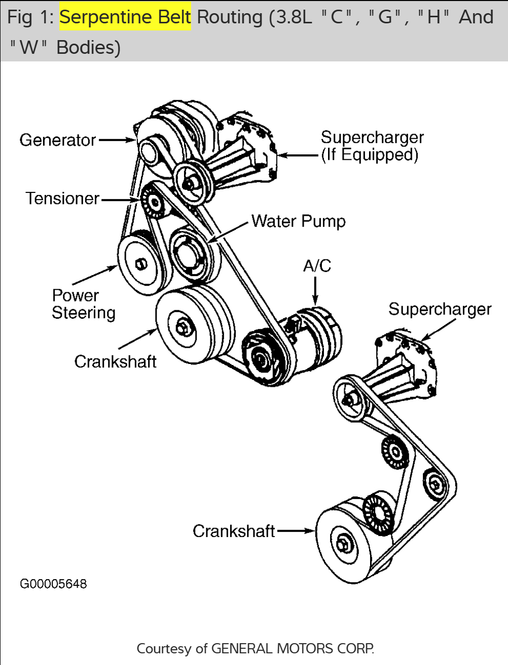

I will also add a belt routing diagram for you but there are a couple different configurations.
I would start there. Let me know what you find.
