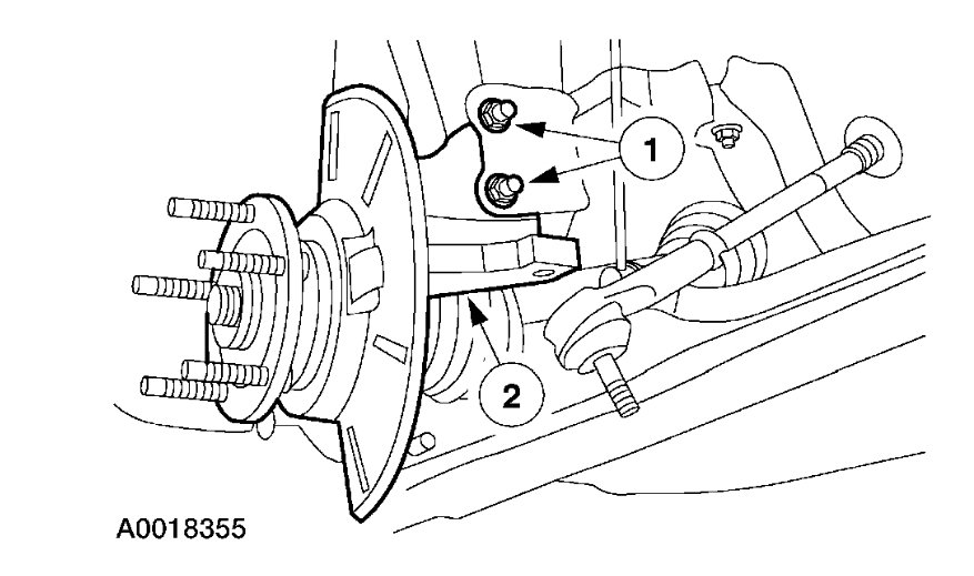

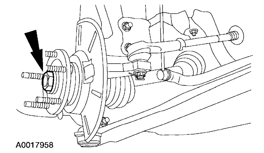

Good afternoon.
When you press the brakes, it takes some of the pressure off the wheel bearing. That confirms the noise as the wheel bearing.
I would replace both front. If one has failed the other will be close behind. This is being proactive.
The spindle will have to be removed and the bearing pressed out and in.

1. Remove the brake disc.
2. Remove the wheel hub nut.
3. Remove the tie rod end nut.
1. Remove the cotter pin.
2. Remove the nut.
4. Using the special tool, separate the tie rod end from the knuckle.

8. Remove the wheel knuckle.
1. Remove the strut-to-wheel knuckle bolts and nuts.
2. Remove the wheel knuckle.
