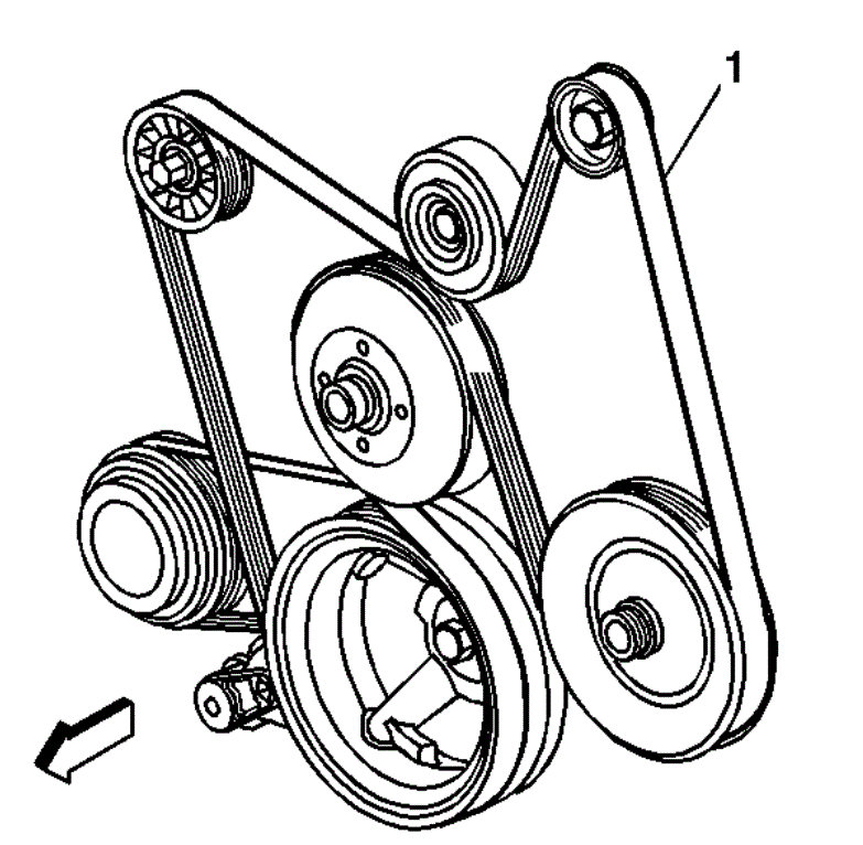

Changed water pump and idler pulley, now it's making that awful sound when driving. The power steering cap is star to leak fluid. please, can you help?
Apr 8, 2022 at 2:00 AM
  • 110,241 POSTS
I would be happy to help. Is the sound loud enough to record and upload for me to hear? It sounds like the belt may be bad, loose, or contaminated. Also, are you certain the belt is routed correctly? See pic below.
Also, let me know if there is anything you do that changes it.
