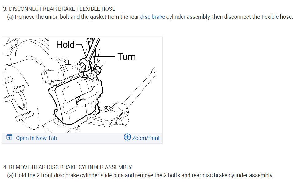

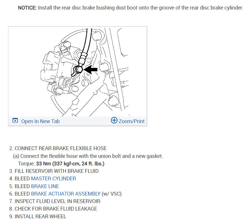

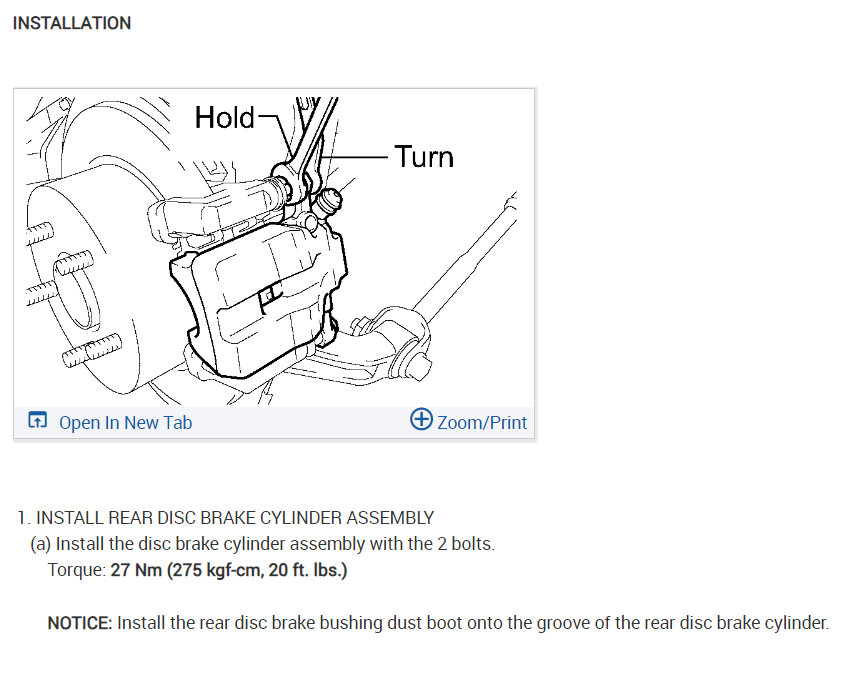

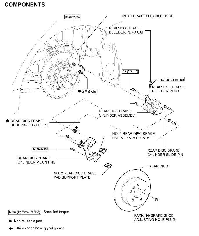

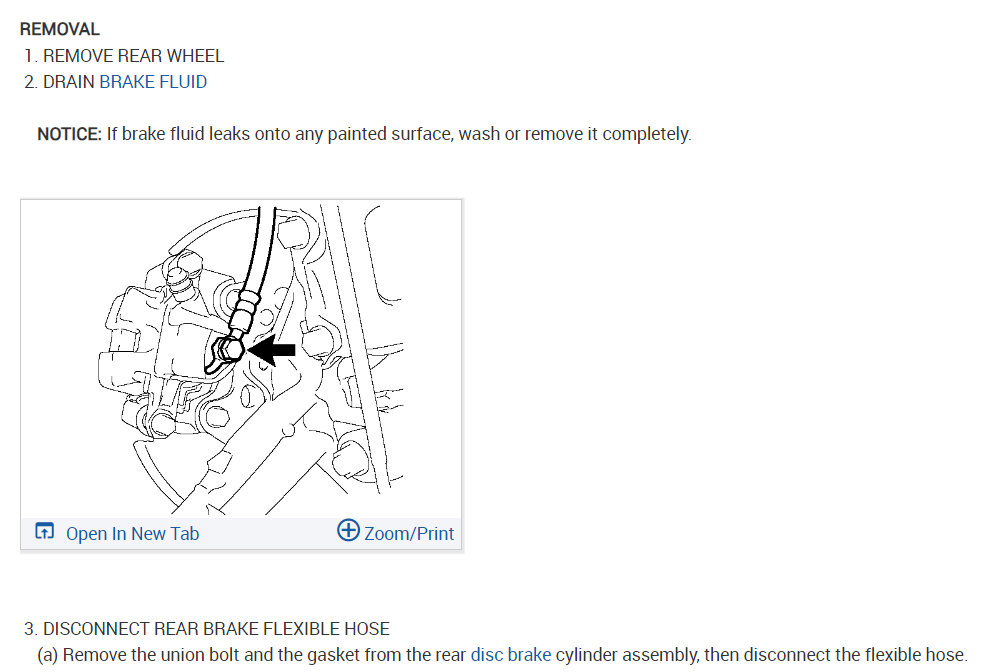

I notice that when I put the car in reverse and start backing up there is a fairly loud squeal coming from the rear of the car. I think it might happen when I apply the brakes as I am backing up. The brakes appear to work normally when going forward and stopping is decent although not a powerful grabbing of the brakes when I apply pressure to the brake pedal.
Apr 15, 2024 at 6:47 PM
  • 55,746 POSTS
Yep, this happens when the brake pads get too low and the warning "screamer" starts to touch the rotor which makes this noise, here is how to change the rear pads out in case you want to do the job yourself and save some money.
Here is a video to show you how as well:
