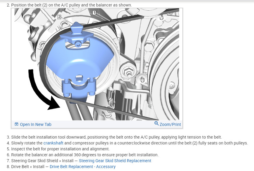

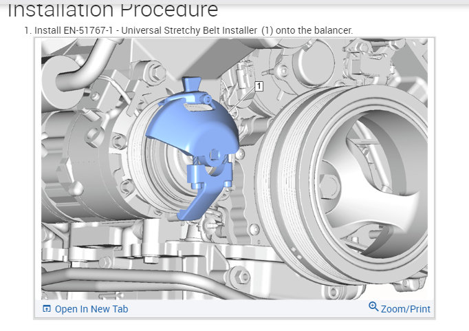

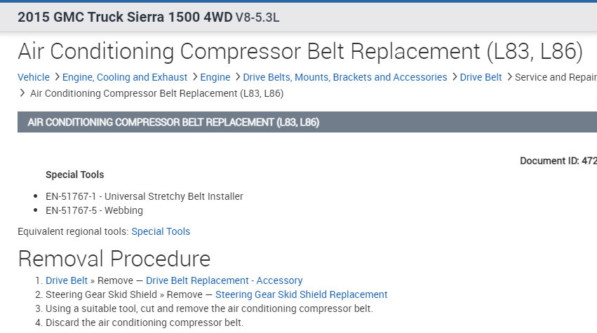

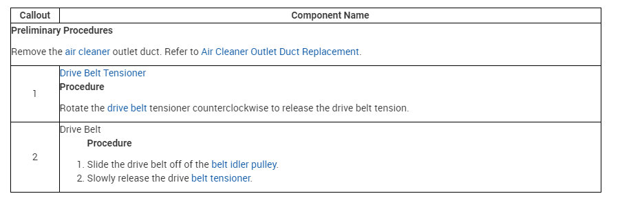

If you find it is the AC belt, this is an interesting one to replace. There is no adjuster. The belt is cut off and then using a belt stretcher, the new one is installed.
I attached the directions below if this is the issue.
Let me know what you find. Also, see if the sound lessens when the AC is off or worsens with it on.

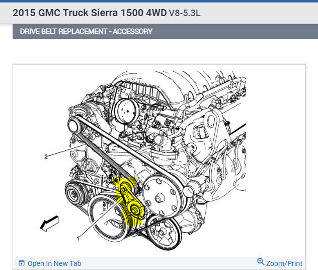

That sounds like the problem. The belt is really simple to replace on this. I attached the directions below if you want to do it yourself.
I highlighted the belt tensioner. Using a ratchet or breaker bar, turn the tensioner in a counterclockwise direction to loosen the belt. Remove the old one, route the new one, release the tensioner to get the belt on the last pulley and release the tensioner.
If you can, let me know if the belt takes care of the issue. Keep in mind, if the tensioner is losing its strength, it can cause this problem as well, so make sure the belt is tight.

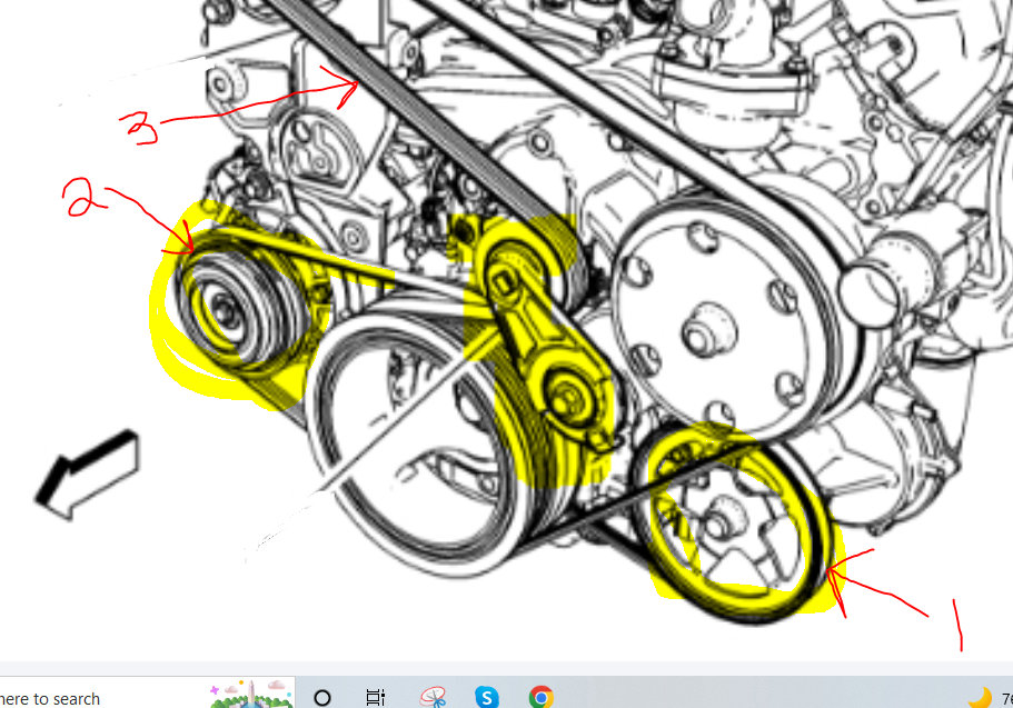

Is there anything that changes the pitch of the noise? For example, if you place a load on the alternator with many accessories or turn the AC on and off? There are three belts on this vehicle. Were all replaced?
Were any of the belt-driven accessories checked to make sure there isn't a bearing failing?
Also, I relistened to your original video. I'm confident that isn't a lifter. I really believe it is one of the belts. Did you pour water on them again to see if it stops? If you look below, I identified the three belts. The belt I identified as number 1 is the one I suspect since it is louder on the driver's side. Try the water trick on that belt.
Aug 28, 2022 at 1:13 PM
TYJACK12345321
  • 13 POSTS
We changed the serpentine belt. The other two belts and the pulleys were not changed but we did spin them and couldn’t get the sound to recreate. The video is very deceiving because the sound almost sounds like it’s from the front but I’m confident it’s coming from the right side of the engine. I will try the water trick tomorrow.

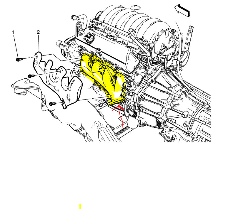

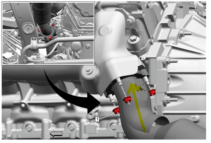

Update.. the dealership told me today that they found an exhaust leak on the drivers side between the gasket and manifold towards the Y-Pipe. They inspected the lifters and camshaft and all parts are functioning correctly.
Does this sound possible? Could you post a picture of my engine diagram like you did early on so I can understand what they are fixing exactly?
Sep 1, 2022 at 5:45 AM
  • 110,244 POSTS
It may have a leak. I didn't hear one, but it may not be noticeable in the video.
As far as the gasket, there are two exhaust manifolds, one on each side. I assume it is the driver's side they want to replace.
If you look at pic 1, I highlighted the exhaust manifold. I have a red arrow showing where the Y pipe would attach. Pic 2 shows the manifold and Y pipe, and the yellow arrow is pointing toward the manifold.
Let me know if that helps.
