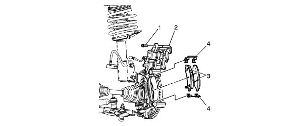

While driving I hear squealing sound, also hear sound when I press the brakes.
Jun 10, 2018 at 1:42 PM
  • 110,194 POSTS
Hi and thanks for using 2CarPros.com

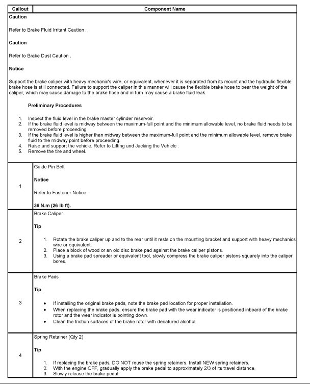

It sounds like the brake sensor is touching the rotor. That is the first thing I would check. Here are general directions for replacing pads if you determine they are bad:
Specific directions for your vehicle are listed in picture 2.
Let me know if you need help, have any questions or need additional information.
