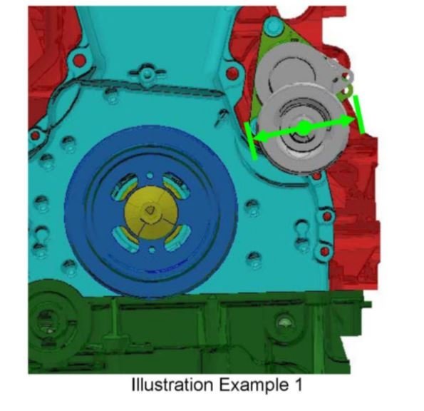

Good evening,
This sounds like the drive belt or the tensioner not keeping the belt tight.
https://www.2carpros.com/articles/how-a-serpentine-belt-works
https://www.2carpros.com/articles/how-a-serpentine-belt-tensioner-works
https://www.2carpros.com/articles/serpentine-belt-tensioner-replacement
I would replace both the belt and tensioner.
