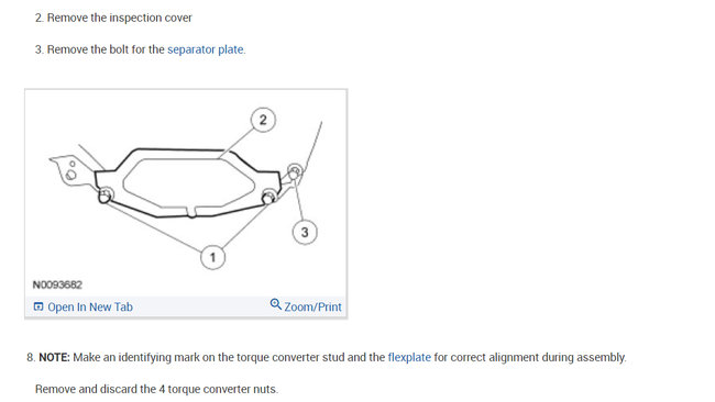

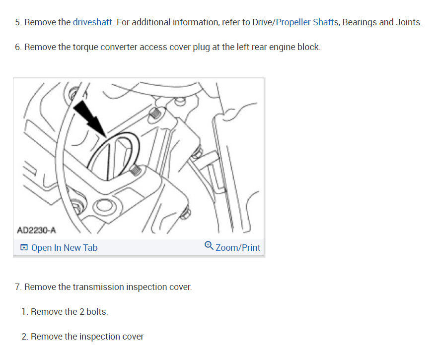

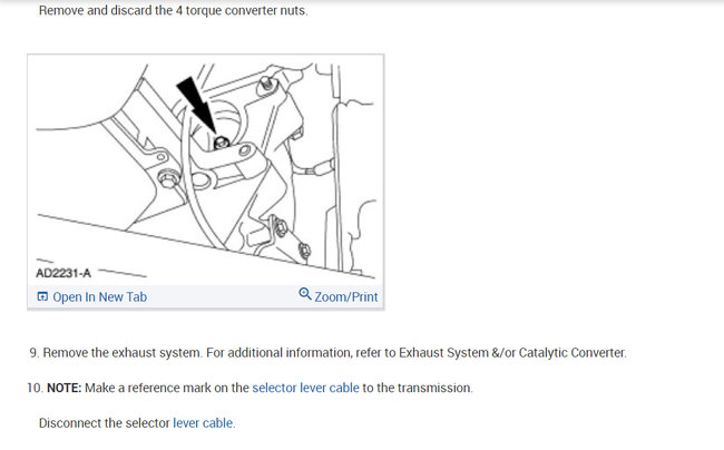

Okay, thanks
This sounds like something is hitting the flywheel at the back of the motor. Check the starter and make sure that the plate is not hitting the flywheel.
Either that or the bolts holding the flywheel to the torque converter are loose.
