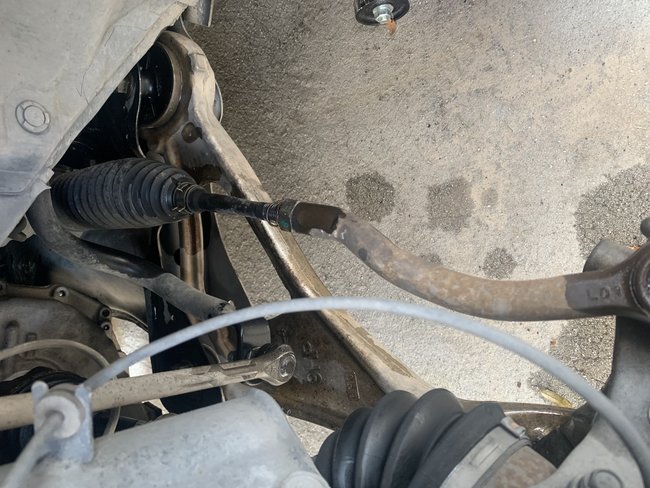

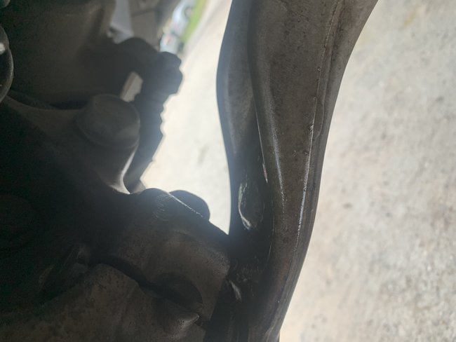

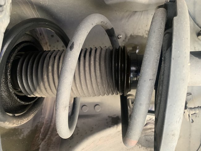

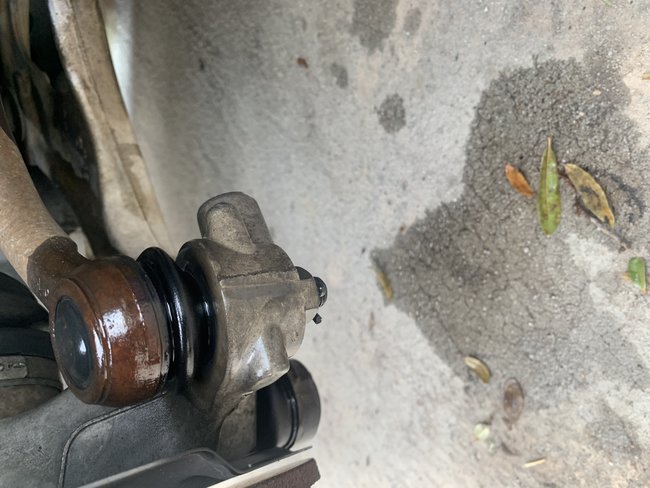

My car has been making a squeaky noise when I get inside of it as well as when I press the gas. It only seems to make the noise when I’m accelerating. It is still slightly noticeable when my foot is off the gas, and it gets noisy again when braking. Although I am due for a brake change, I know the difference in sound it makes when the clips rub on the rotor, so it is not coming from the brakes. I will add a couple of pictures and some videos of the sound. I added a little w-40 to some parts to try to make the noise go away but it is still apparent.

I watched the video and certainly heard it. Is there anything that changes to volume or pitch of the sound? For example, if you make a turn or hit a dip in the road? You indicated you could hear it when you get in the vehicle which makes me think bushing. If you bounce the front of the vehicle, can you reproduce the sound? Does it change in intensity with speed? Have you checked the stabilizer pins and bushings? Take a look at the attached pic below. I highlighted the stabilizer pin and bushing for one side.
Sorry for so many questions. I'm just trying to get a solid understanding.
See pic below.
