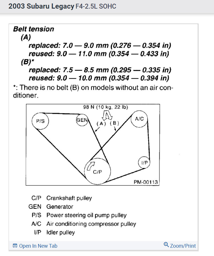

I just got my serpentine belt replaced 2 weeks ago now when I turn my wheel a very loud squeaking comes from it. I have tried to loosen and tighten it, but the noise stays. i think it might be the pump, but I'm not quite sure. also my battery is fine. I just had it tested.

Did you use a high quality belt? Also can you confirm the tension is correct? Here is a guide to help you step by step with instructions in the diagrams below to show you how on your car:
Can you please shoot a quick video with your phone so we can hear the noise? that would be great. You can upload it here with your response. Check out the diagrams (below). Please let us know what you find. We are interested to see what it is.
