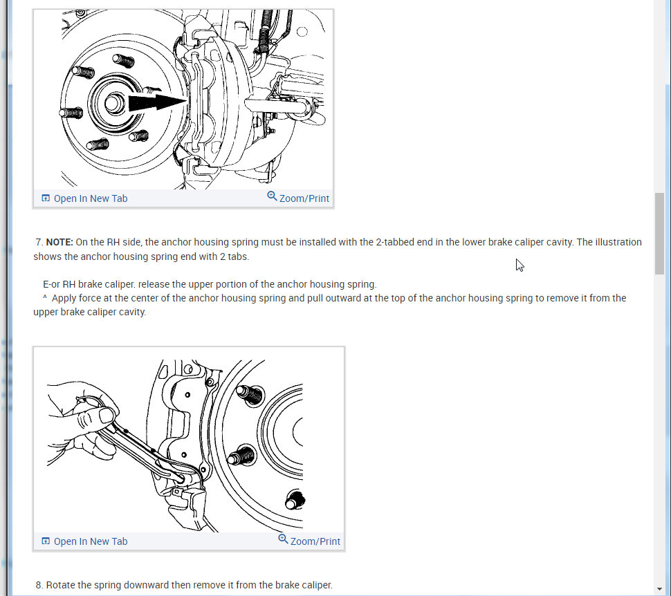

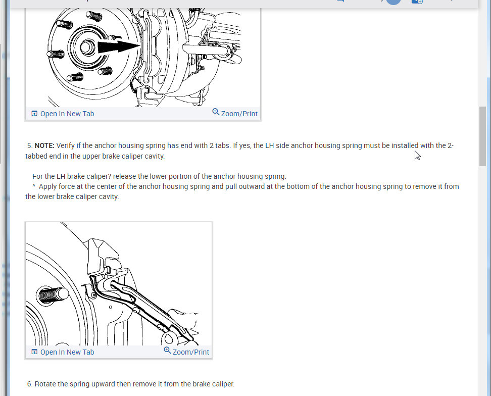

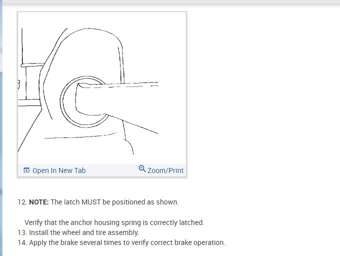

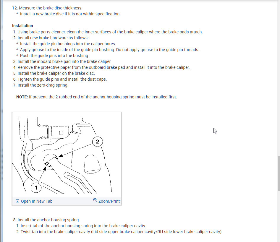

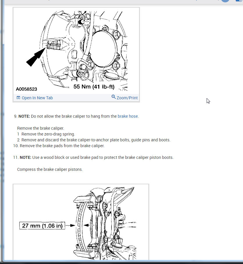

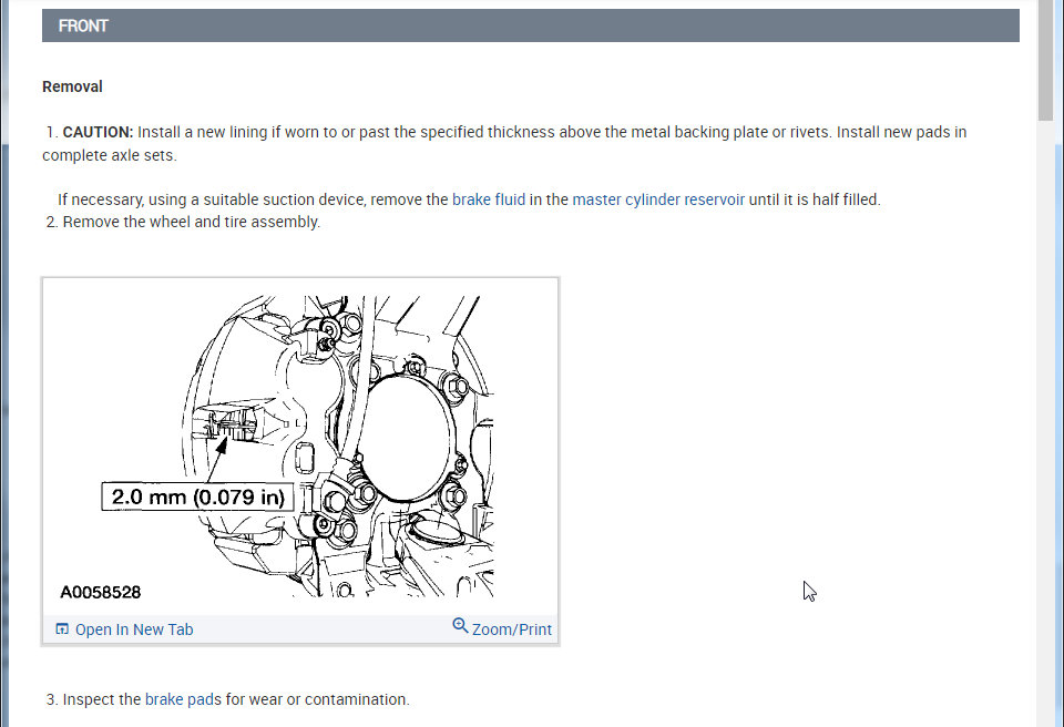

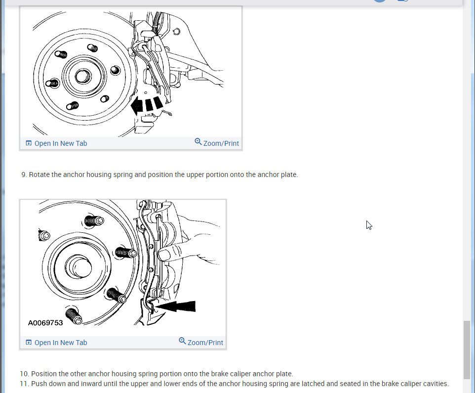

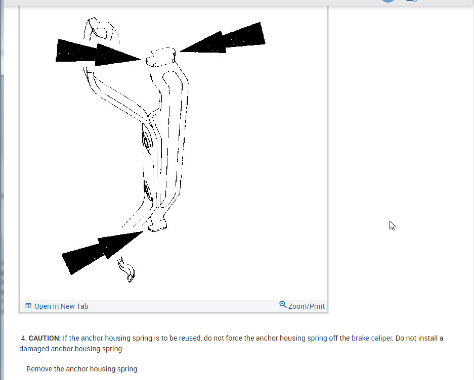

This sounds like you have brake issues. If they are making noise when you press them then most likely they just need to be replaced.
Here is a guide that goes through in general how to do this:
Then I attached below the process from the manual on how to replace them from the manual.
However, if you just bought this from a business then I am sure they have some sort of short warranty. Even if it is just a few months of a warranty, most do back their used cars so I would take it back and ask they take care of it for you.
