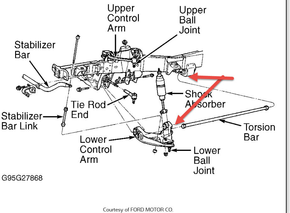

Squeaking noise coming from the the front end.
THOMAS KRAMER
  • 2000 FORD EXPLORER
  • V6
  • 4WD
  • 206,000 MILES
It sounds like it might be the bushings but I'm not sure if it might be the shocks it only does it when I drive straight if I turn I don't hear anything I would like some insight on what it may be!

Could be ball joints if you have grease fittings try lubing those and lube where arrows are for torsion bars then have front end checked if it doesn't go away.
