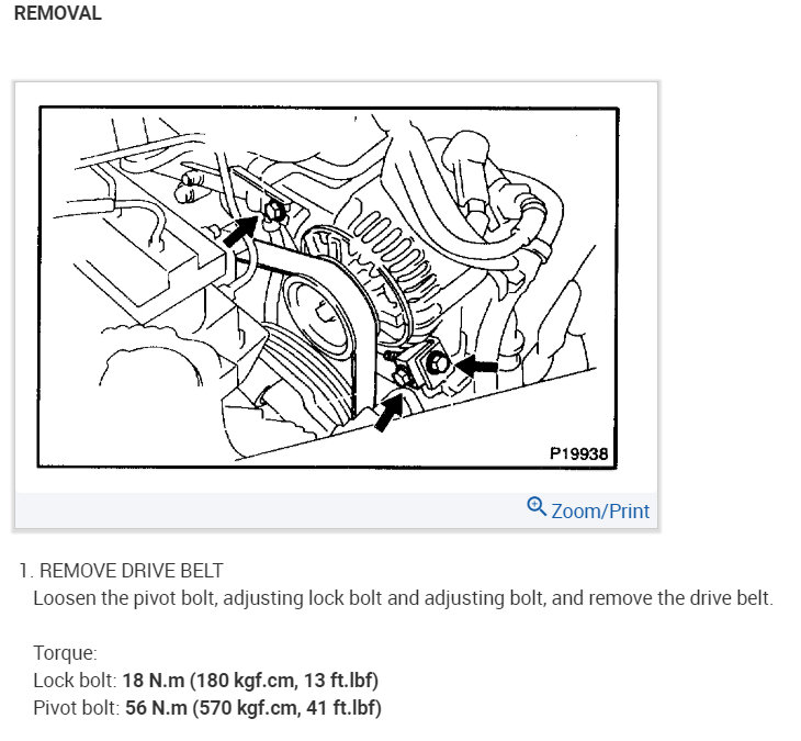

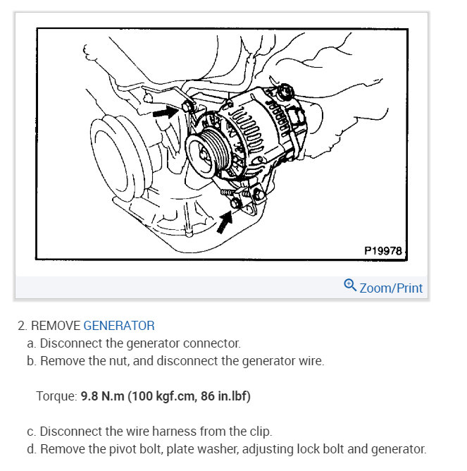

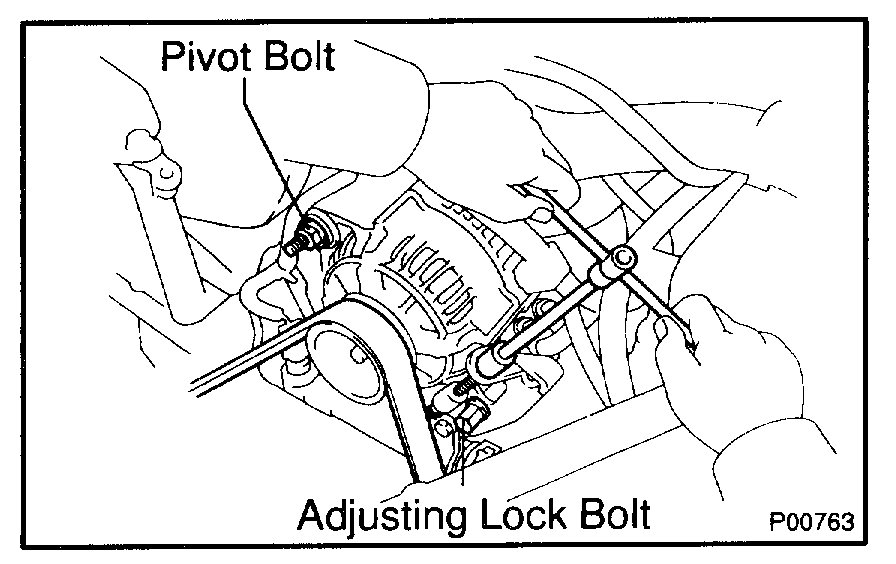

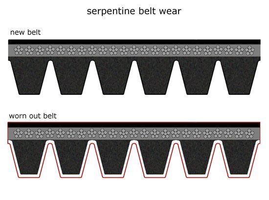

In the words of the Grinch, Make it stop! God I hate that sound.
That is belt squeal, What happens is that the belt ridges will wear into wedge shapes and no longer grip the pulleys properly and you get squeal. It gets worse with the AC on because that increases the load on the belt, plus it raises the electrical power used so the alternator also increases its load.
New belts and cleaning the pulleys with a wire brush to remove any belt debris on them should quiet it down. There are two versions of the front drive on that car, it looks like you have the earlier two belt system with a wide serpentine belt in the front and a narrower belt in the rear. As you will have the front belt off, replacing both is a good idea.
The tensioner bolt will either be on top or down to the side. The pivot bolt needs to be loosened first though. The power steering will be similar but on the back side.
