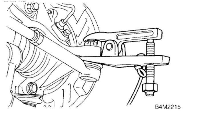

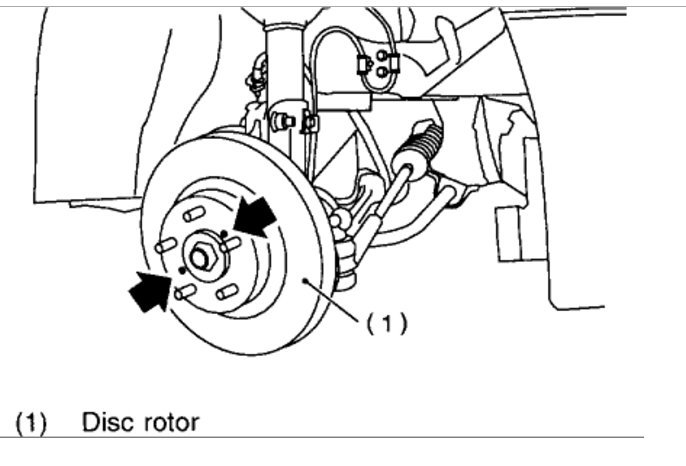

put it into reverse and it squeaks rhythmically upon moving, with one little pop/tap/knock when speeding up or slowing down a bit, but not when the car is still. Sound comes from under passenger seat undercarriage. It continues when put into first, but quickly goes away. My mechanic is booked until August and he had a listen he thought it was dust in the brakes (not coming from tire location though) or the rear drive-train. I will have it looked at in August, but in the meantime, was planning a fourteen day vacation drive 1,800 miles max all told. Now this full time single mom is worried I will get stranded all five of us (two kids, two dogs and myself!).
Jul 19, 2017 at 10:08 AM
  • 55,628 POSTS

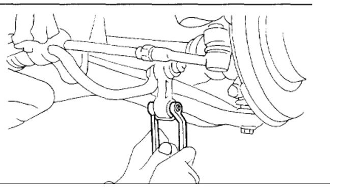

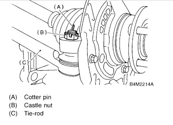

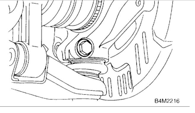

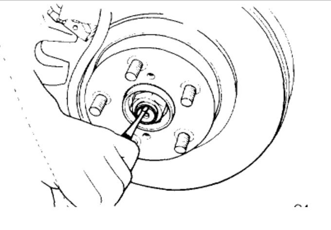

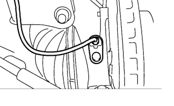

It sounds like you have a drive axle on the passenger's side that needs to be replaced. Here is a guide to show you what you are in for when doing the job:
https://www.2carpros.com/articles/replace-cv-axle
Here are some diagrams (below) of how the job is done on your car.

Thanks for the reply Ken... I do feel that the sound is further back than the halfshaft and is closer to the center of the drive train. Do you think it might be a U joint?

Noises for us are difficult because we cannot hear them over the internet unless you do a video of the noise which many people have done. the noise could be an axle bearing as well. We will need to pinpoint the origin of the noise to properly diagnose it.

It sounds like it is sounds in the transmission or a bracket that is loose somewhere on the engine or transmission. I would jack the car up
and check underneath about where the noise is coming from. Move some stuff around and use a flashlight.
