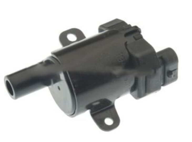

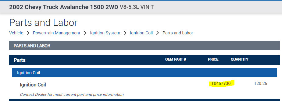

I am replacing O-2 and knock sensors along with harnesses etc. and want to do spark plugs and wires also. However, I did not know there were round and square ignition coils. How do I determine which I have? Does the VIN help identify that?
Jan 29, 2024 at 8:28 AM
  • 110,251 POSTS
They should be the round ones. I looked up the OEM part number and attached it in pic 1 for you. Also, picture 2 shows the coil.
If you purchase an aftermarket coil, just cross reference it to GM part number, 10457730.
