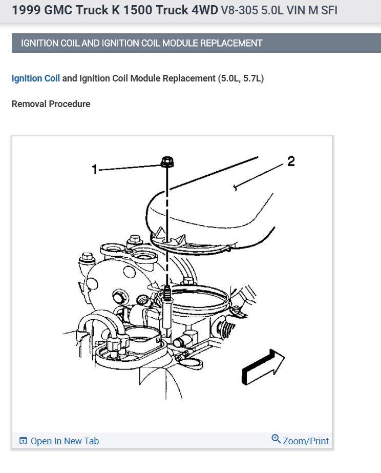

Sierra 3500 had motor and transmission replaced 2 years ago. ran great then fuel pump went out, replaced it, the cap, the rotor, plugs plug, wires, coil. now it idles great but once you drive about 10 miles it starts sputtering backfiring kinda exhaust smells awful. but then you let it sit a minute and it’ll run fine again. the gauges when the key is off mark everything as if it’s on when key is on all are at mark they should be when key is off. we have spark, we fuel. so what could be causing this? we live about 50 miles from the nearest town so it’s not like we can run in to the parts store or junk yard real quick. please if anyone has had this problem before or knows how to fix it let me know. This truck was a Cab and Chassis a utility bed was added later 5.7 vortex 1 ton 3500 4 wheel drive.

I’m sorry but we live about 50 miles from the nearest town and our F250 is getting a new transaxle so we’re like stuck here the tune up was done 2 weeks ago all oem parts were used the weird thing is it was half a—Ed running before the tune up then it didn’t run at all until yesterday it started ran went approx 25 miles down our dirt road and then it started missing real bad sputtering wanting to stall then finally did we have 60 plus psi for fuel but no spark to the coil almost as if something jiggle lose or shorted out or something I don’t get it

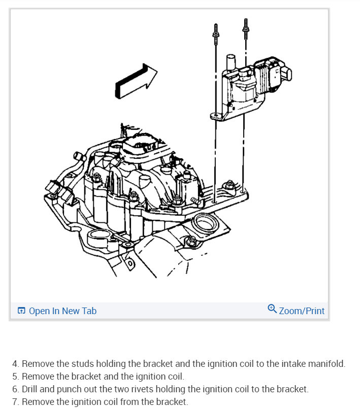

It could be an ignition module going out. but let run the codes to see what comes up. please refer to the link above and report back. Also in 2000 there is not suppose to be a distributor can you confirm you have one please?

Lets run the codes to see what comes up and if no codes are present lets replace the ignition module and coil. here is how in the diagrams below:
