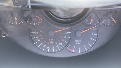

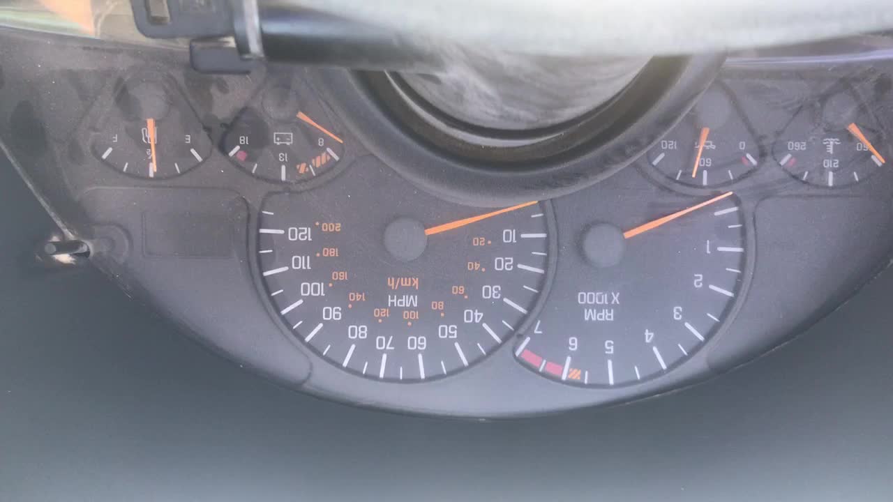

Here is a video of a start up on the gauge cluster. I applied no pressure to either pedal and sat still. The oil pressure gauge is crazy because the harness is wrong at the front of motor. And as far as the voltage gauge, it reads funky but my alternator puts off 13.9 volts at battery when tested at parts store, and appeared healthy. The rpm's is the main thing.

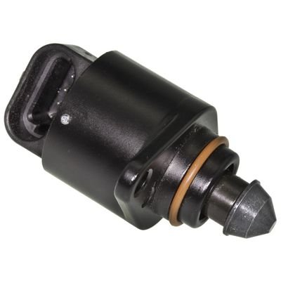

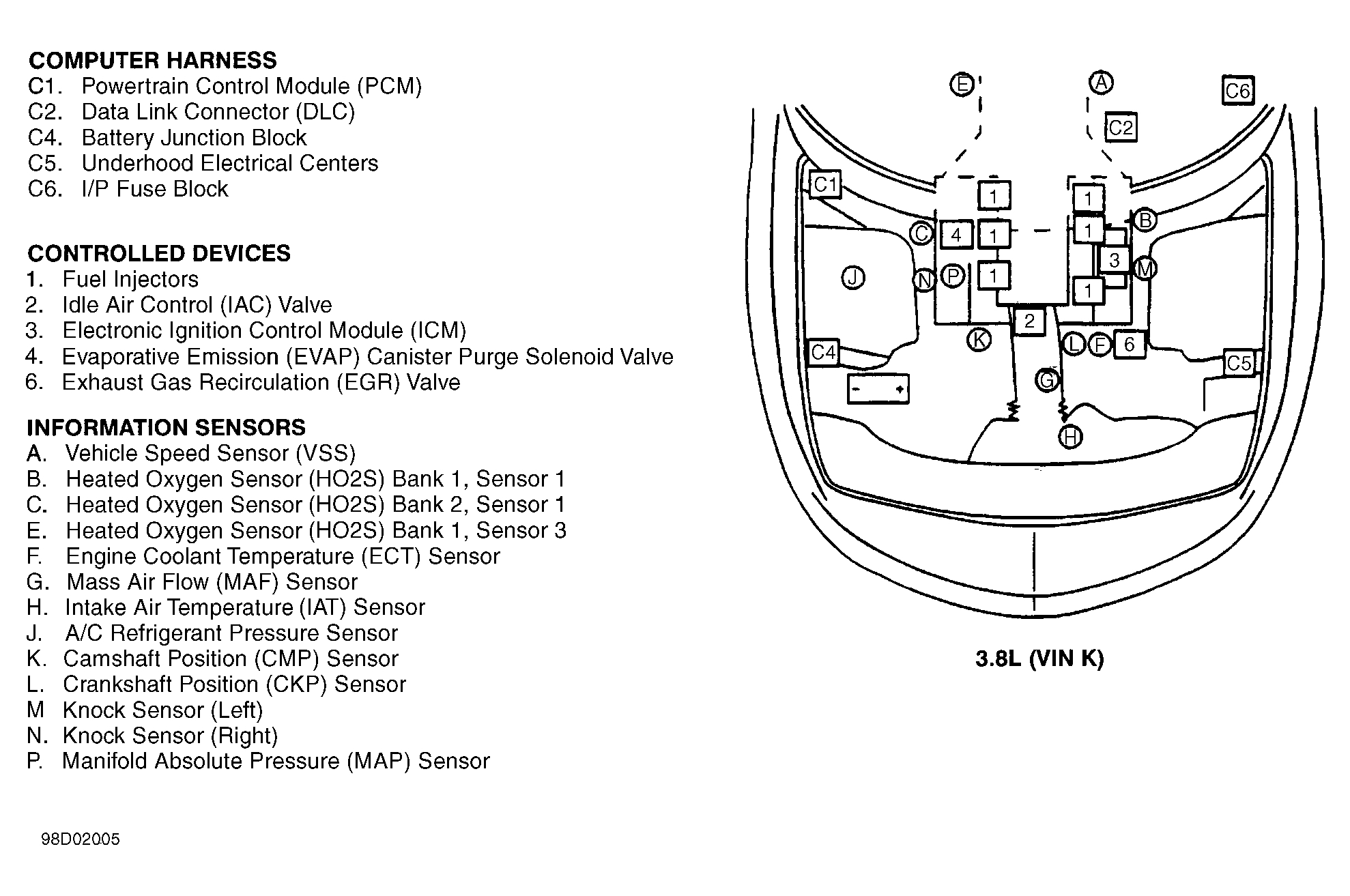

I watched your video and the idle could be the result of a dirty idle control air control valve (IAC). The component I am referring to is located on the right front of the intake manifold. I have attached a picture of its location and a picture of what it looks like.
The IAC is responsible for maintaining the engine's idle speed. If it is dirty, it can cause a fluctuation in the idle speed. First, I would recommend removing it and checking for excessive carbon build up in the manifold and on the IAC itself. Keep in mind, there are both a gasket and an o-ring which could be leaking, causing a vacuum leak. A vacuum leak can cause the idle, a random misfire, sputtering. Also, make sure the throttle plate on the throttle body is clean.
Check this and let us know what you find.

Okay, I know exactly what your talking about. When I cleaned the throttle body I pulled it off and cleaned it a little too. Did not really inspect o-ring. Just left it as a questionable replacement needed. Will look into pricing and get to work.
Thank you very much.

Okay, the IAC got changed a couple days after my last post. I cleared codes and about a week after that I got the codes p0172 and p0175. The change in running condition was huge initially. After about three weeks I started to notice the rpm bounces periodically. I have cleared the codes a few times and it comes back about each week.
Recently it has seemed like it stutters before it gets moving correctly off of a stop. Getting out and going a little faster helped the first couple times with rpm bounce and stutters after that, not so much. Rpm's still bounce periodically.
