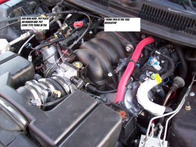

I have a 98 trans am. 5.7 liter automatic. The problem I am having is it is making weird noise, it idle low(500rpm, it suppose to be around 1000), loss of power, and when at full stop it hesiatate when running again. I started having this problem about a week ago, but the low Idle since I bought the car(about a year ago). At first the idle wasn’t that bad it would shake alittle(low compression because my car would sound quite at a stop light). It only did that in drive, it would not have this problem in reverse nor nueteul. I wanted to fix it so I started fixing thing that would be causing the problem. First I removed throtte body and there was a lot of carbon build up. Nothing, problem remained. Second I changed the Idle air control valve, new MAf sensor, speed sensor. But nothing. Third I gave tune-up, changed oil, sparkplugs(irdium), and wires. When in the process of doing this, I notices oil in the spark plug chamber(a lot). I think that is why I am getting the low Idle. I know that it could be one of 2 things, the pistion rings could be bad or the valve path is leaking oil because of bad seals.(how can I tell?). A month later I stated hearing this noise(bang, bang, like if something is hitting). This only happen in drive, but now even when in park. I just don’t know what to do. I don’t want to take it to a mechanic because where I live(Laredo) no one knows what to do and I also get the run around(like it the fuel filter, Im sure, I put a new one a week after I bought it) any help on this matter, would be great. Oh and it now making a clicking know, I think it’s from a valve.

do you know what your fuel pressure is? also check your fuel volume

how would I check the fuel pressure, is there something I could buy.
oh and I forgot to add something to , I found a vaccum hose with 3 exits disconnected, I tryed finding what they connected to. the leads coming from the passenagers side valve cover. I caped it for the mean time. could this be the problem.
Mar 31, 2008 at 7:29 AM
RHALL77
  • 3,361 POSTS
it could be the problem there should be a vacuum diagram under the hood to tell you where they go. as for fuel pressure there is a gauge you can buy. tool trucks for sure have them and some part stores.
There is a valve on the fuel rail that it hooks into. it looks like a valve stem on a tire.

https://images.2carpros.com/forum/automotive_pictures/133498_enginemod_1.jpg
Mar 31, 2008 at 7:50 AM
RHALL77
  • 3,361 POSTS
is there any spots on the intake that you can see where it goes (vacuum lines) If the cap is green no thats not the fuel rail.thats the EVAP system

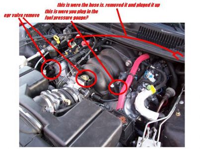

https://images.2carpros.com/forum/automotive_pictures/133498_engine_2_1.jpg
Apr 7, 2008 at 8:51 AM
TYRANTXZERO
  • 33 POSTS
Sorry about pic. I just wanted to show you were the egr was and the fuel regulator.
even withthe egr on it was still giving me the low idle.

have you checked your IAC (idle air control) to see if it was sticking.
Apr 8, 2008 at 12:50 AM
TYRANTXZERO
  • 33 POSTS
I thought that what was wrong, so I bought a new one.. about a month or two ago. I also thought it was the throttle positiion sensor, so I also bought a new one. no dice.

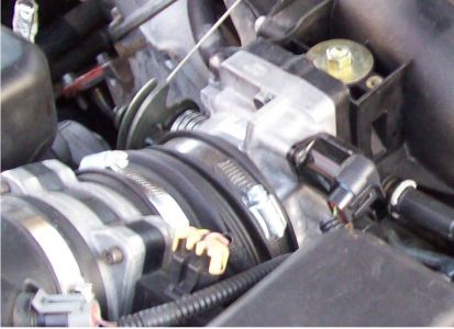

can you get me a closer picture of the throttle body when you get a chance i wanna see if we can cheat a little bit.?
Apr 9, 2008 at 2:27 AM
TYRANTXZERO
  • 33 POSTS
is this a good pic I coud remove the air intake, so you could see the whole throttle?
https://images.2carpros.com/forum/automotive_pictures/133498_throttle_1.jpg
Apr 9, 2008 at 4:15 AM
RHALL77
  • 3,361 POSTS
this isnt the correct way to fix it, but since i am not there to see what the car is doing you can try this. there should be a stop screw on the throttle cable side that you may be able to turn up to raise your idle. i cant see in the pic if there is one or not.

I know what screw that is, how much should I turn it, or how high?
Apr 9, 2008 at 4:52 AM
RHALL77
  • 3,361 POSTS
i would say just enough to get the idle where you want it and it doesnt interfer with the throttle position sensor reading.
