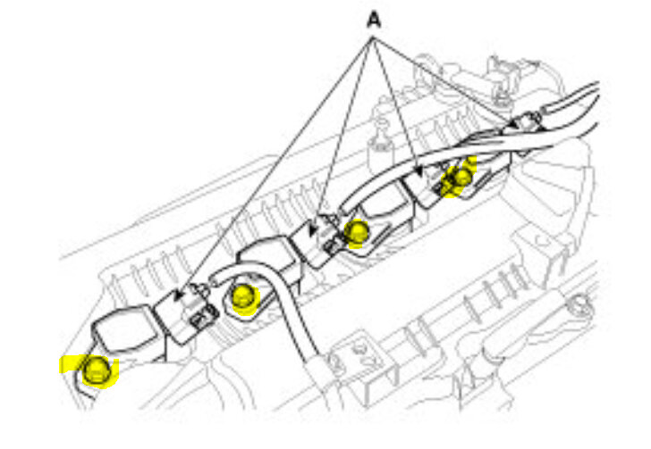

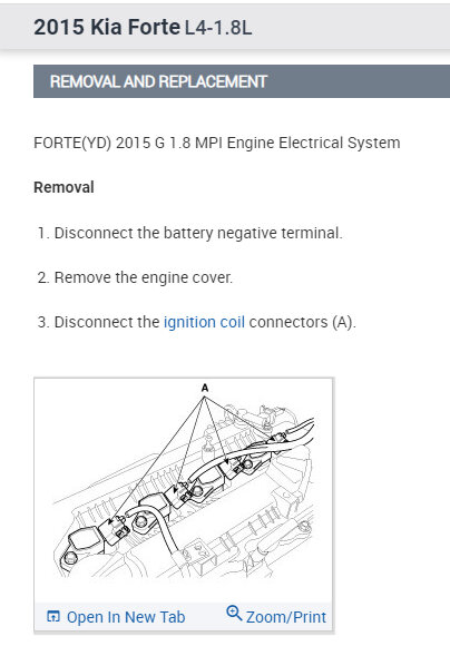

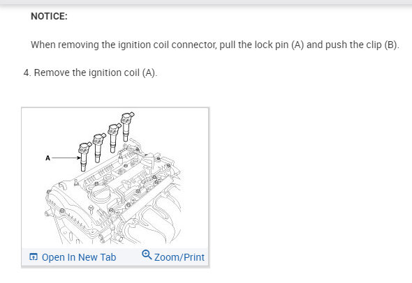

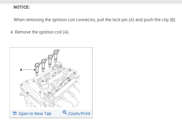

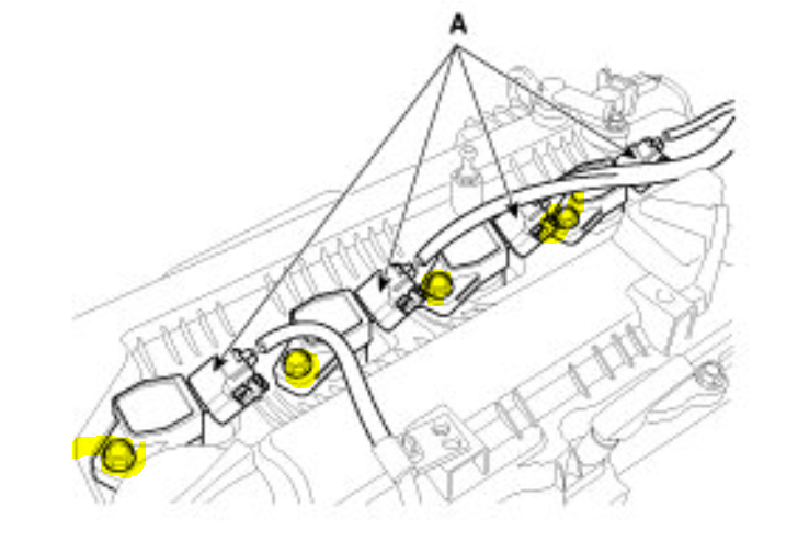

If you are comfortable doing it, here is what we need to try. We need to switch the coil packs between cylinders 1 and 2. The purpose is to determine if the coil pack is the issue. If the coil is failing, the misfire (P0301) will move to cylinder 2 (P0302). If you still have a misfire at cylinder1, then we need to check the spark plug.
I attached 3 pics below. The first two are the directions for removing the coils. They forgot to mention you need to remove a bolt. LOL In pic 3, I highlighted the bolts.
You only need to worry about cylinders 1 and 2. Cylinder 1 will be the one closest to the serpentine belt (front of the engine). Simply, remove the plastic cover from the top of the engine. Gently pull upward on it. I don't believe there are any bolts or screws holding it. It should snap into place.
Once that is removed, you will see the coil packs. Switch them and let me know what happens. Also, pay close attention to the rubber part of the coil that attaches to the spark plug. If it is wet with oil, that could also be the cause of the misfire.

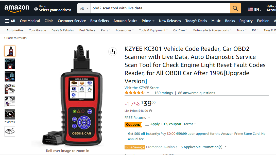

As far as a scan tool, you can get one with live data for under $40.00. I attached a pic below from Amazon showing one.
See pic below.

Wow cool. I had no idea those cheaper ones would be sophisticated enough. That's good news.
Opted for this one:
https://www.amazon.com/gp/product/B00UJV3E12/ref=ppx_yo_dt_b_asin_title_o00_s00?ie=UTF8&psc=1
A little bit more but has a little better reviews and more of a track record and will be here tomorrow!

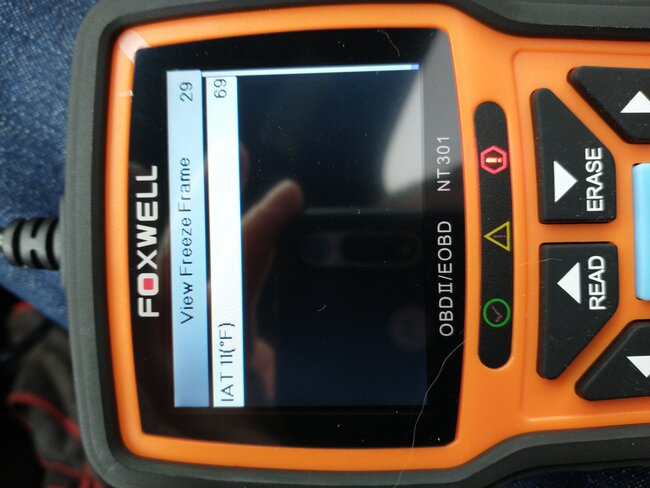

So, I got my live scan tool today. It came later in the day, so I didn't have much time to mess with it. I did get a confirmation of the cylinder one misfire and went into the live data a bit. Now you're talking about the freeze frame. Does that happen when you have it in live scan mode, and does it just freeze frame all the info when the fault happens?
Mar 12, 2023 at 9:30 AM
  • 110,244 POSTS
It will automatically save the freeze frame data when the issue occurs. The scan tool doesn't even need to be connected. If the scan tool you have does retrieve freeze frame info, you should be able to check it now.

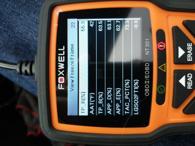

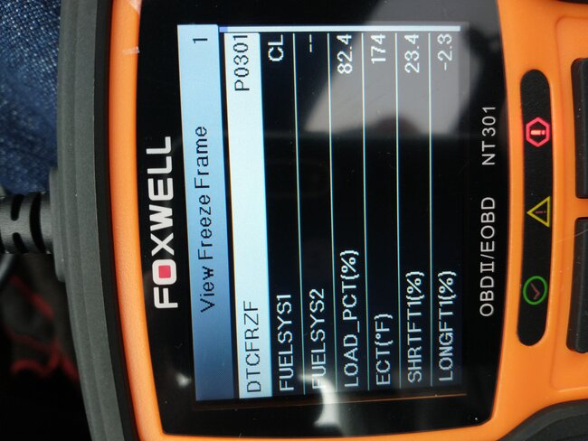

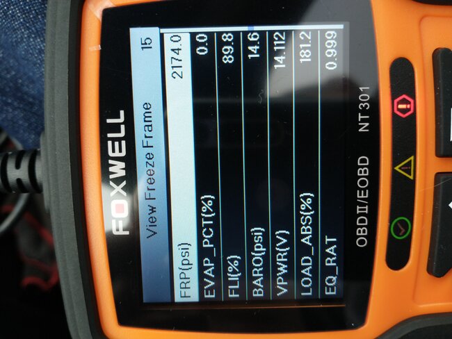

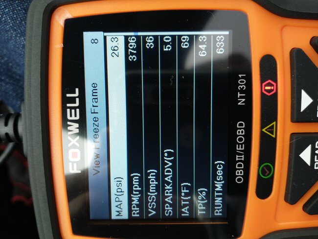

So, this is actually the second freeze frame because I erased the codes and had to go and get the engine light to come on again. Sorry for doing it this way for some reason I can't print the freeze frame data from the PC.
They are in no particular order.

I need to know something. Two things stick out to me, the IAT and STFT. (Intake air temperature and short-term fuel trim).
The STFT is high. In a perfect world, it would stay at 0%, but yours is at 23.4% which indicates the computer is trying to add fuel. Under normal conditions, the trims should stay between -10% and +10%. This can be the result of a weak fuel pump or an engine vacuum leak. However, the IAT makes me question it. The IAT temperature indicates 69F. I'm not sure where you are located, but that should be approximate under-hood temperatures. If you are in a very cold climate, I guess it could be okay.
I need you to check one more thing. See what the engine coolant temperature sensor indicates. It should be around 5 degrees difference. If it isn't, I suspect the IAT is failing.

I believe what you're looking for is the ECT, same thing right? It shows 174 on the freeze frame data. And if it matters, I took it for a ride and watched the STFT and it varied about 7 points max either side of 0, and mostly around 2 points. It also showed similar IAT temperature.

No sorry, meant to say it was similar to the pic, in the 70s. And yes, it was at operating temperature.
Mar 14, 2023 at 12:27 PM
  • 110,244 POSTS
The IAT is likely faulty. It should be showing a similar temperature as the ECT or under-hood temperature.

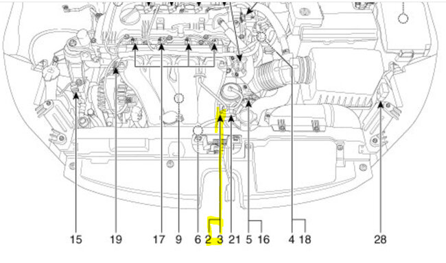

The IAT is integral to the manifold absolute pressure sensor (MAP). I attached a pic below showing its location.
Check the wiring to it, make sure the connector is in good condition, and I would recommend removing it for inspection. There shouldn't be that big of variance in the signals. Five- or ten-degrees difference I could suspect. This is way beyond that point.
Let me know what you find.
Mar 14, 2023 at 12:47 PM
