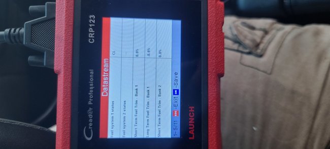

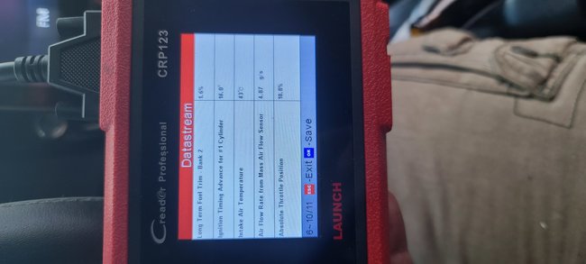

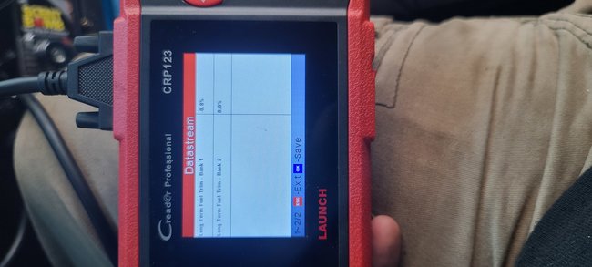

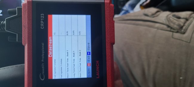

So, I changed out the Throttle body sensor and shifting is better now, but the idling is still rough also power is lacking. I sent a video and photo of what my scanner picked up as per your request. I was going to purchase a compression test kit today, but the auto shop was out. I'll think of getting it when it's in. Also, I noticed one of the cylinders sparking when running with a very light ticking noise. I snugged on the plugs to make sure it was fitted in good, and it was. I'm not sure what to make of that.
Dec 27, 2021 at 3:45 PM
Long-term trims are on the money. I doubt there is a vacuum leak.
