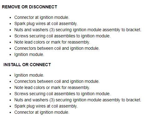

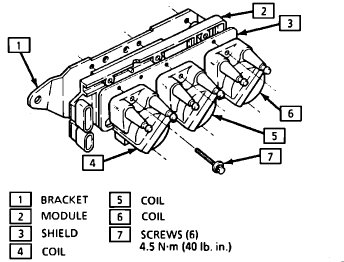

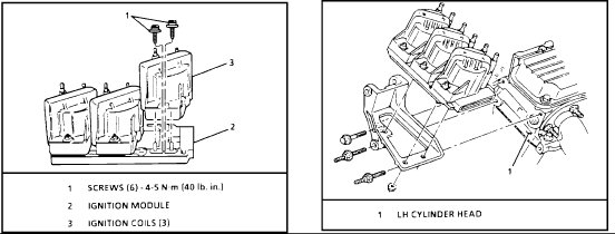

Yes, it could be the fuel pump. But let me address some other possibilities first. (1) Those cars are super picky about their spark plugs and wires. What spark plugs did you use? Did you change the wires too? (2) Have you run a spark test on it at the coils yet? Coils can pretty randomly go out on these cars.
First off, checking for sparks is pretty simple. Just get a spark tester and hook it up to one of the plug wires (where it connects to the coil). Here is the in-line spark tester that I have: https://www.amazon.com/Lisle-20610-Inline-Spark-Tester/dp/B0002STSC6/ref=sr_1_3?ie=UTF8&qid=1501325755&sr=8-3&keywords=spark+tester - it's also available at the local parts shops.
If you find one or two plugs that are bad, replace their individual coils. The images below contain instructions on replacing the coils.

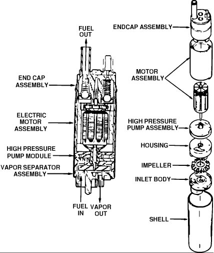

Fuel pump information is below.

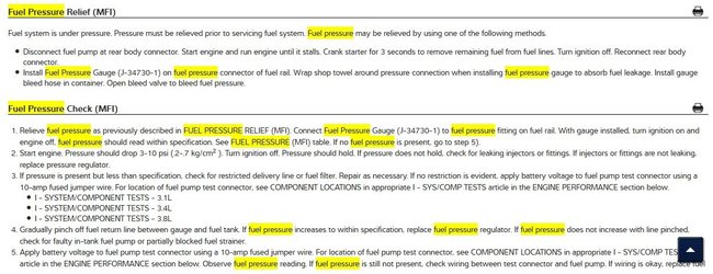

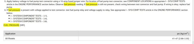

Fuel pressure can be tested by borrowing a gauge from the local parts store (AutoZone, Advance Auto, O'reillys). Herei s a general how-to guide that we've written up: https://www.2carpros.com/articles/how-to-check-fuel-system-pressure-and-regulator
I am also attaching AllData's information regarding fuel pressure and how to test it in the images below. Run this check and see what comes up. You should get 41-47psi with the key on and engine off.

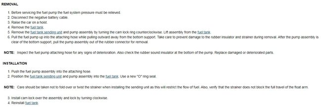

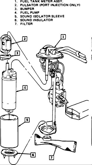

And no, you cannot replace this pump without dropping the tank. For simplicity's sake, I will attach AllData's instructions for replacing the pump in the next post momentarily.

Okay, here are those instructions. Again, if I were a betting man, I would probably put money on it being spark related and not fuel related. I have dealt with more than a couple of bad coils on GM 3.1 and 3.8L engines.

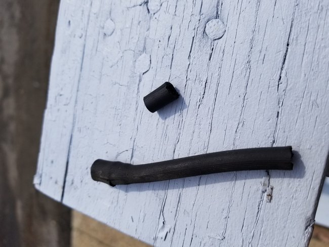

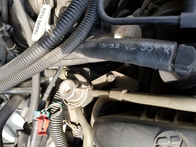

When we opened the hood today to check the regulator, we found that the vacuum hose on the regulator was cracked. I am attaching some pictures. I hope that this is the issue! While checking yesterday, we did not see that! I will post back if that is the problem.

This is the hose that was cracked, that we replaced. It was the problem! We seem to have had our share of vacuum lines cause problems. Thank you so much for the answer, and here is another problem to check for if you are having the same issue.

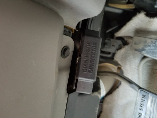

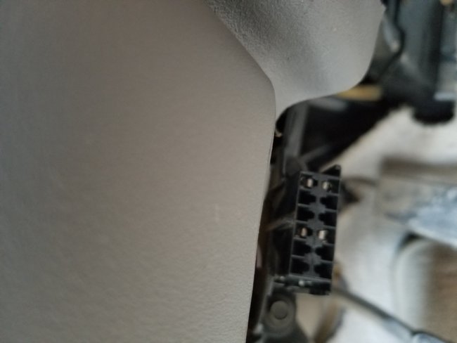

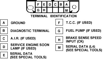

Okay, I am attaching two pictures of the port. There are only four spots to connect the paperclip. We went across the top two, the bottom two, then across the first two top to bottom, then the other side. He even went diagonally. No lights blinking. The service engine light just stayed on. No other light blinked, other than the low coolant light, but it was so dim, you could barely see it. It blinked like three times, and went out. More like a flicker. Not sure where to go from here.
May 15, 2018 at 10:03 AM
HARRY P
  • 2,292 POSTS
You should be able to connect those top two and then turn the key and get the codes. Maybe try using a different jumper wire or a paperclip (my favorite tool for this job). If that does not work, then you will have to find a private mechanic that has been in business for a while. They will have the old school scanner for that car.

You are one of the lucky few, that is the OBD port used on some 1993 to 1995 GM cars that use the SFI/TPI systems with a MAF sensor. It is a transitional system that GM used in those years and decided that the ALDL connector did not need to have the diagnostic access pin in the connector. The attached shows the possible pins and what they are used for. Test pin B is missing on yours. But the upside is that with the correct scan tool like an older Snap-On brick, the OTC Genisys and 2000 plus the Tech 2 with adapter can access that system and get OBD II type data feeds from it as it uses an OBD II system laid over the original OBD controls.

Thanks for the information Steve W. That seems to be the problem. No one seems to have that adapter. The darned local GM garage does not have it! We drove our beastie about twenty minutes south last night, and we had intermittent hardly noticeable hesitations, and only one sputter incident. It seems to be calming down some, but we changed the fuel filter, the plugs, plug wires, and tested the spark. I think the terminals are good, but we will check those too. We had some of that 'weirdness' when we got the car. Just ongoing ghosties.
