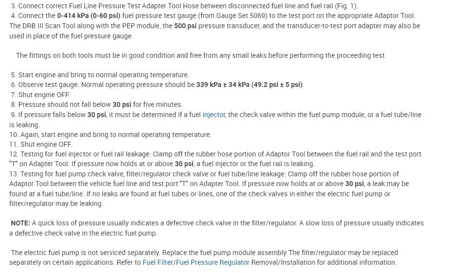

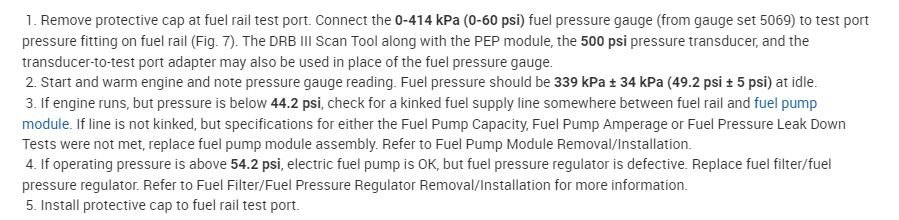

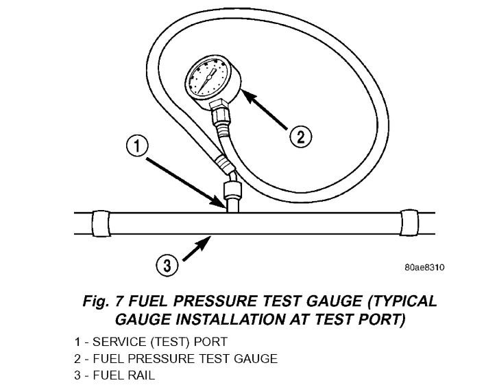

First cranks up runs fine. Runs about 2 to 3 minutes,sputters then shuts off cranks back up then does same thing over again. Help
Feb 23, 2020 at 1:14 AM
Good morning,
I would start by checking the fuel pressure when the truck shuts off. I attached the procedure below for you to check. It sounds like a fuel delivery issue.
https://www.2carpros.com/articles/engine-stalls
