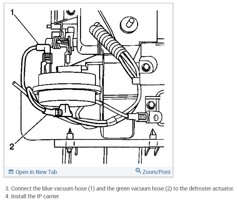

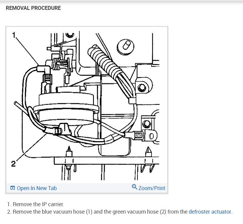

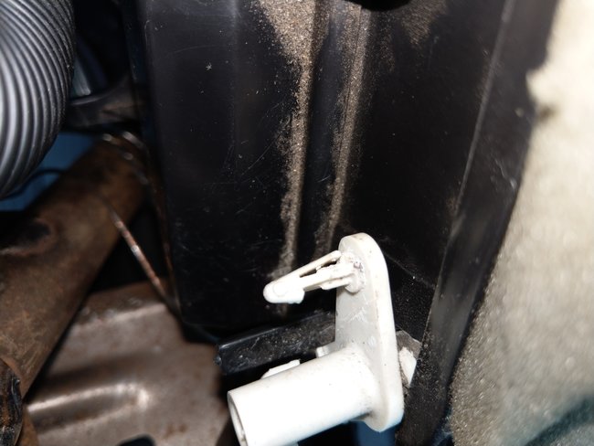

I need to know how to put a spring on the left side of the AC heat box. It is were the actuator opens the door that moves the air down to your feet.I took the spring off but can't remember how to put it back on.
Jul 7, 2019 at 4:00 AM
  • 55,845 POSTS

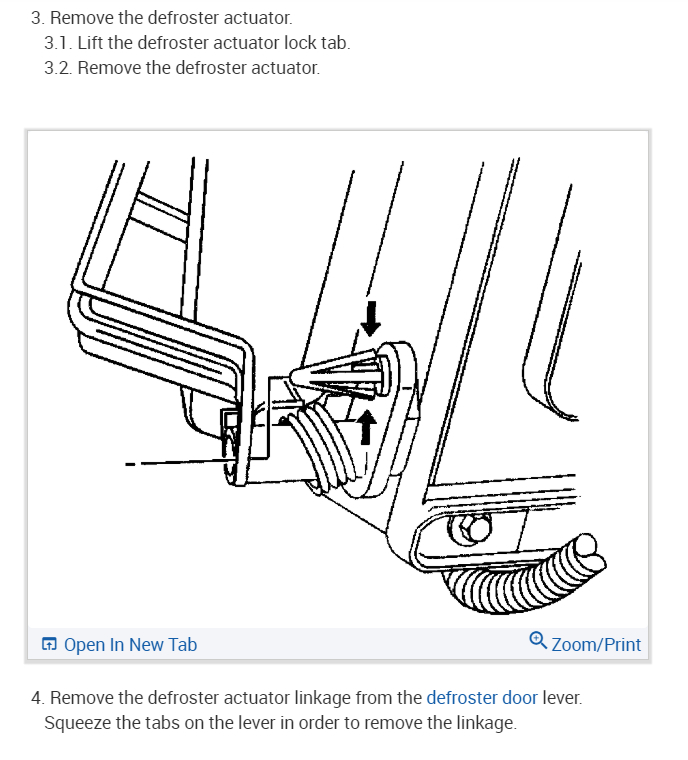

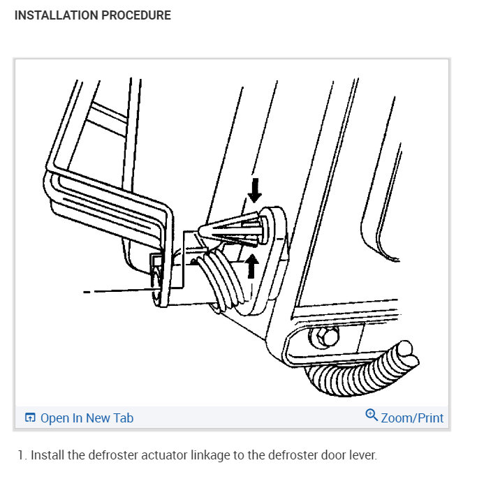

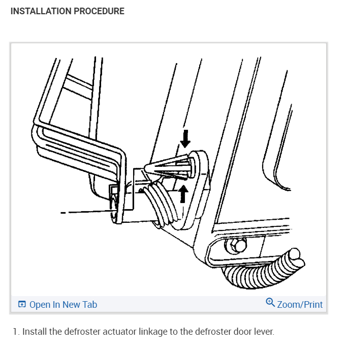

Here are instructions and diagrams to show you how to reinstall the spring. Check out the diagrams (below). Please let us know if you need anything else to get the problem fixed.

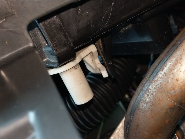

Okay, so I gave it other shot but no luck. Those pictures don't really show you how the spring is on there. I need to see a picture of the spring in more detail. Whatever you can do to help will be great. Thanks
Jul 9, 2019 at 3:30 AM
  • 55,845 POSTS
This is all we have on it. can you can more close up pictures so I can walk you through the repair?
Jul 9, 2019 at 3:49 AM
JEEPYJCO
  • 7 POSTS

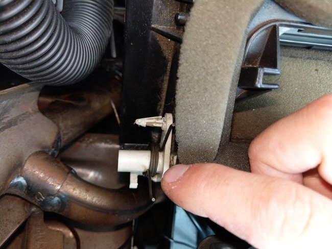

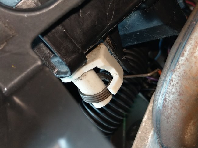

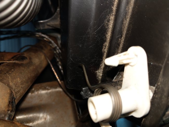

Okay, here are a few more pictures.
Jul 9, 2019 at 4:03 AM
  • 55,845 POSTS
Nice work. you can see the big part of the spring goes behind the white hook of the arm and I can't see the other end of the spring but it will against the anchor (black) to help pull the door shut. Please let me know and give more picture once it is together.
