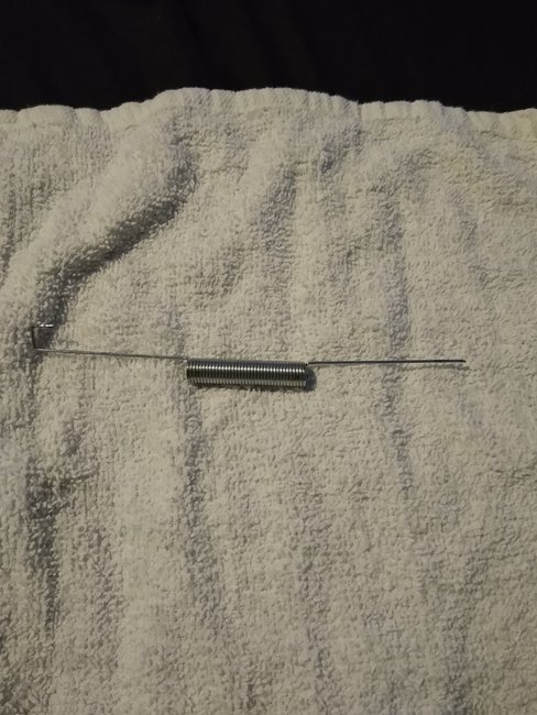

I also saw this spring - (see image) -on floor under steering wheel- this was 2 months ago so I don't know if related?
What so you think?

As for the spring that appears to be a spring for the rear drums but even then it is a little thin so if there are no issues, I would not worry about it at this point.
Let's start with locating the leak and go from there. Thanks
