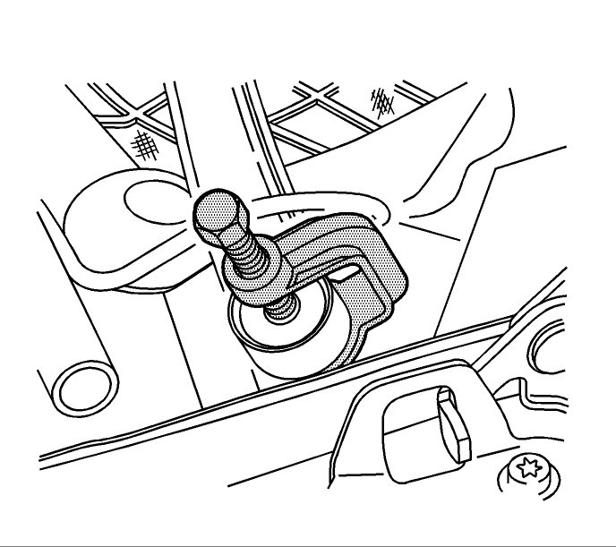

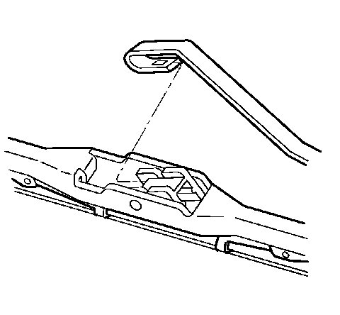

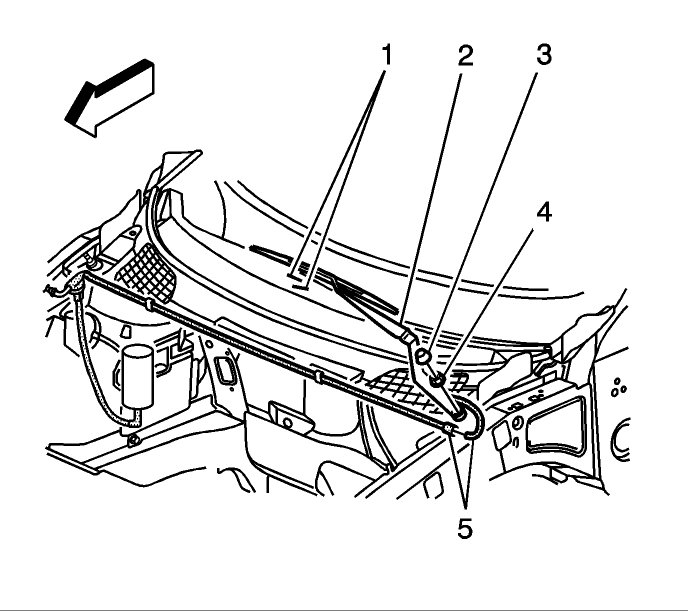

The way that wiper arm is made you cannot easily get to the small piece inside it to reattach the washer hose. To repair it you need to remove the entire wiper arm. Then remove the nozzle assembly and route the hose through the arm and attach it to the nozzle. Then feed the nozzle back in and lock it in place. The catch is that it is very easy to break the nozzle.
That is why I would suggest just replacing the entire arm. It is not a difficult item, you need to have the new arm prior to working on it though. The process is to raise the hood fully, then remove the rubber cap that covers the retaining nut. Then you remove the nut. Now the hard part, removing the arm from the wiper transmission, There is a special puller but I generally just tap the long arm the wiper attaches to and they pop free of the tapered shaft. Or you can usually borrow the puller from many parts stores. Once the arm is free you can disconnect the washer hose from the T and remove the wiper blade assembly from the arm.

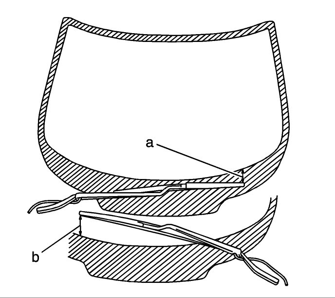

To install the replacement you reverse the process. Make sure the wiper blade is attached before you install the arm, you use the far end to align the blade to the mark on the lower blackout strip on the windshield. Tighten the nut to 35 ft lb (good and tight) Reconnect the hose after routing it down the cowl. Test. Enjoy the clear view.
