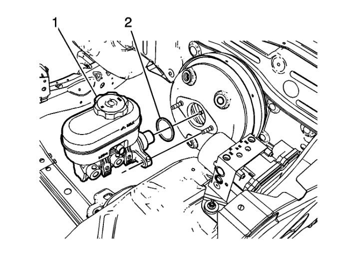

Had to have the master cylinder and booster replaced in February. Had normal brake pressure until recently, when all of the sudden, no brake pressure. Pumped brakes a couple of times and got enough brake to stop. Turned engine off, pumped brake pedal until I felt hard pedal pressure, restarted engine, no problem. A few days later, same thing. Now I notice at a full stop, my brake pedal, slowly goes down. Pump the brakes 1 time and good pedal, but still slow loss of brake pressure.
Wednesday, May 13th, 2020 AT 5:37 AM
  • 52,797 POSTS
Good morning,

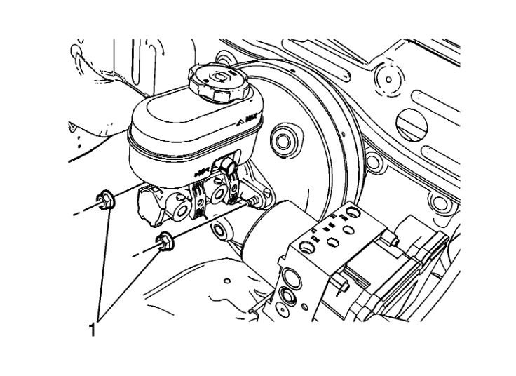

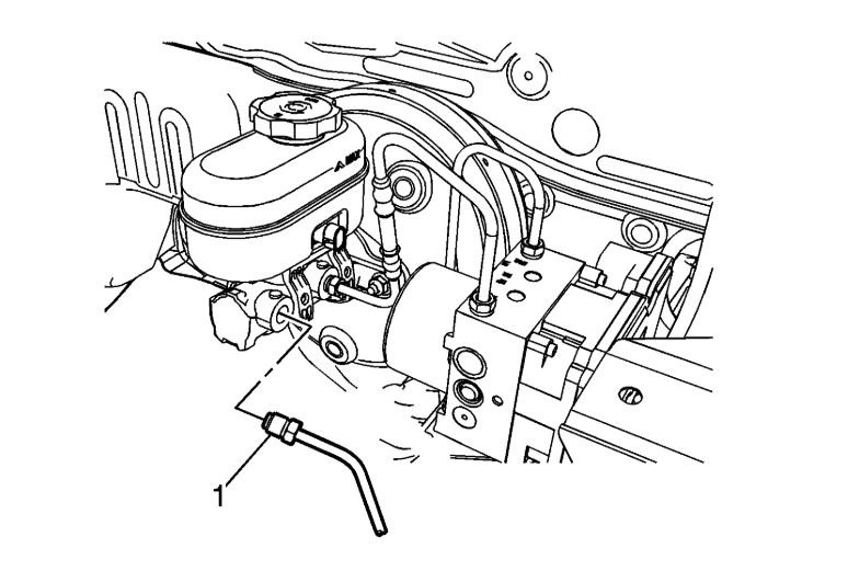

This sounds like the master cylinder is failing. The seals internally are not holding.
https://www.2carpros.com/articles/brake-pedal-goes-to-the-floor
I would replace the master cylinder and flush the old fluid out of the system dirty fluid is what caused the seals to fail.
https://www.2carpros.com/articles/how-to-replace-a-brake-master-cylinder
https://www.2carpros.com/articles/how-to-bleed-or-flush-a-car-brake-system
You are going to need to bleed the system when you are done. I attached the procedure for you to bleed the ABS. You must do it with a scan tool.
