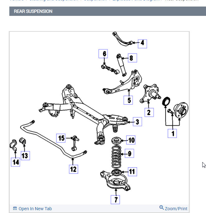

I attached a picture of the rear suspension below. Can you tell us what bushings he replaced and if you see the part that he is blaming now?

He replaced the rear axle/wishbone bushes. The part that is damaged looks similar to part 8 on the diagram. Looking at videos it seem to be the part that's jacked up during the process of changing the bushes. The bolt connecting it to the wheel is bent looking as if forced back in. The wobble is spontaneous and happens if hitting uneven surfaces or on tight bends. Thank you for your help! It's much appreciated.

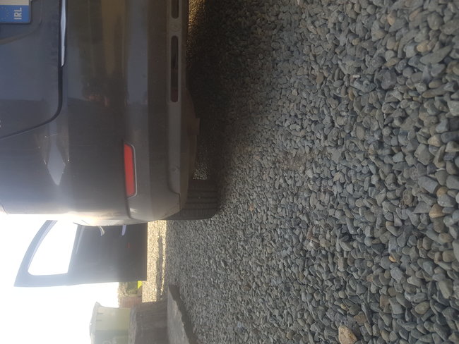

The wheel is also noticeably uneven as it sticks out more at the lower end.
Apr 2, 2021 at 11:16 PM
Okay. You mentioned a video but I did not see one attached. Can you just get a picture of what is bent including the wheel? Clearly if you can see the wheel is not even then that is the issue.
So if number 8 looks like it is the item that is bent then that would make sense why this happens when you hit bumps because this is what absorbs the shock when you hit them.

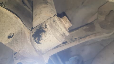

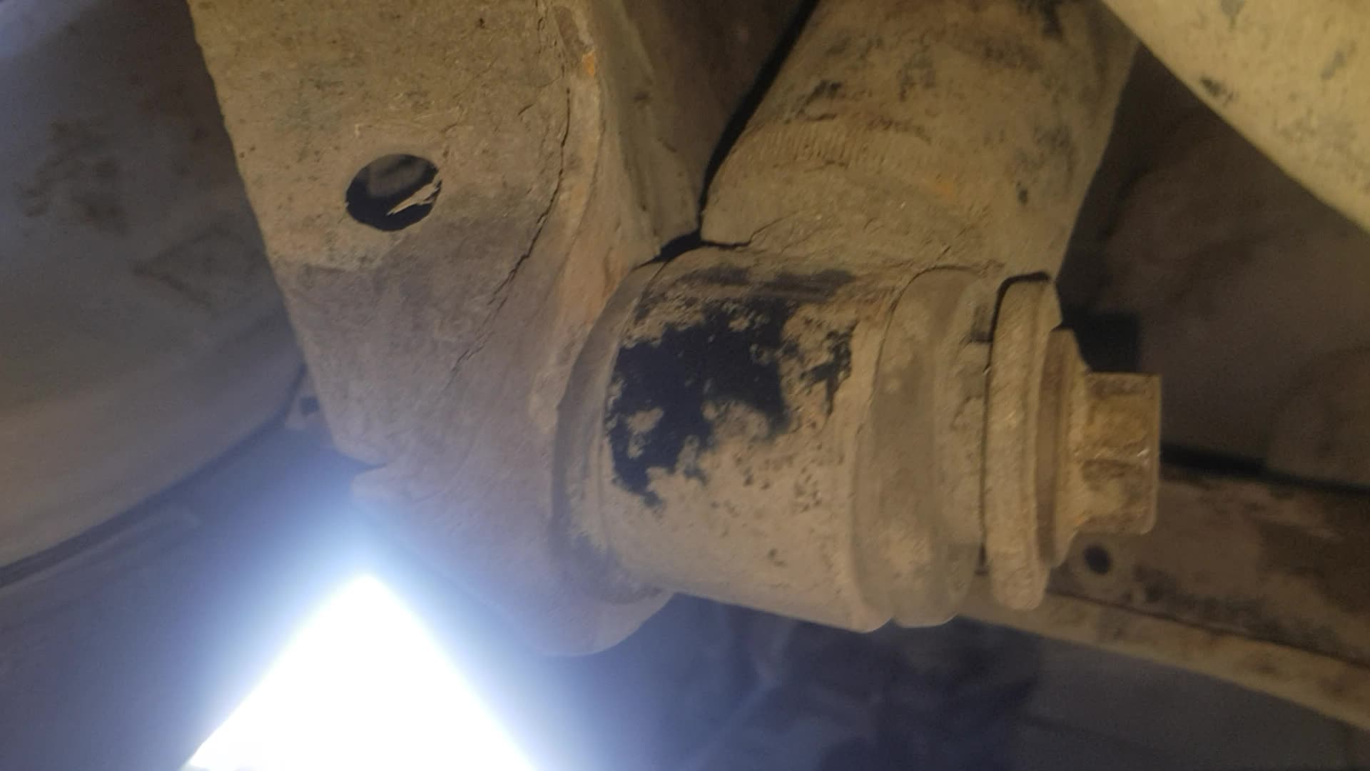

See attached the picture of the wheel and the part that seems bent and may be causing the issue, thanks so much.
Apr 3, 2021 at 12:57 AM

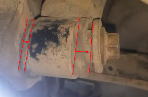

That wheel is not as drastic as I was imagining so thank you for the picture. However, that is leaning in a bit at the top and if this is the same wheel that this shock is on in the video then that is definitely something that needs to be fixed even if it doesn't fix this issue but I suspect it will.
That shock is not positioned correctly as it should be equal on both sides as shown in the picture below. Plus you can see how the bushing is squeezing out the one side. So this is not correct and needs to be fixed.
Thanks for the pictures. that really helped.
