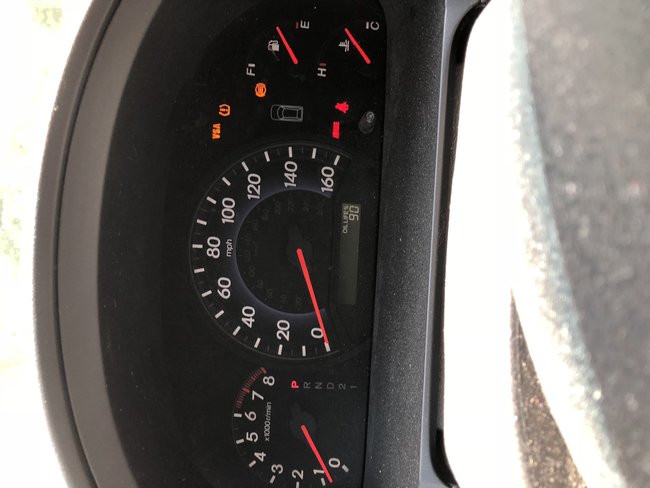

When driving sometimes many lights come on. If stopped still running and parked running ten minutes working good, one or two or there times a day.

There are many lights that can come on.
There is check engine light, ABS light, charging light among a few.
Can you post or upload a picture of the lights you see?

Got it.
You have the ABS, vehicle stability control and red brake light. That indicates a fault in the ABS system. There is a code stored and you need to have the code read to help determine the cause of the failure.
You can get a parts store read it for free. Once you know the codes then I can help you pinpoint the failure.
The other light is a low pressure indicator for your tires. Make sure all your tires are pumped to the proper spec on the side of the tire.

Okay, thank you. I will go get code then let you know. Thank you
