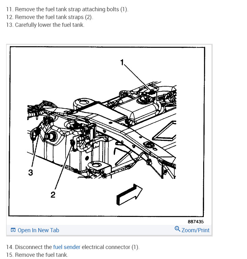

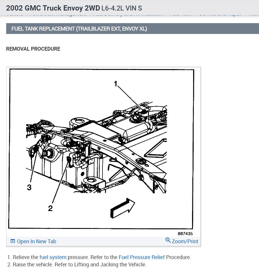

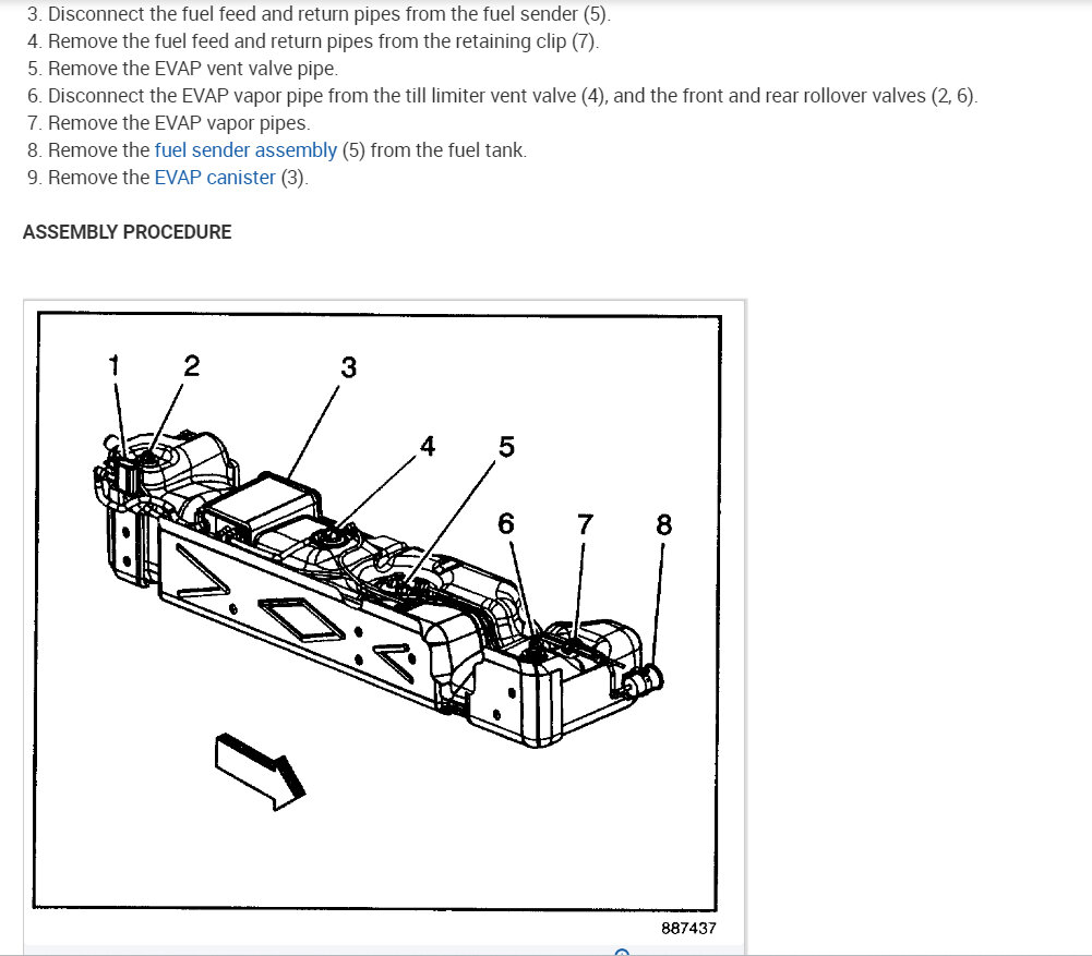

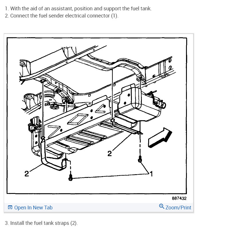

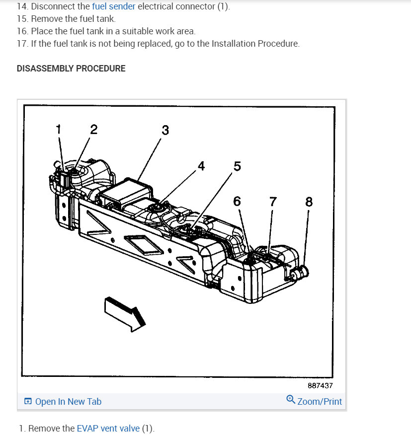

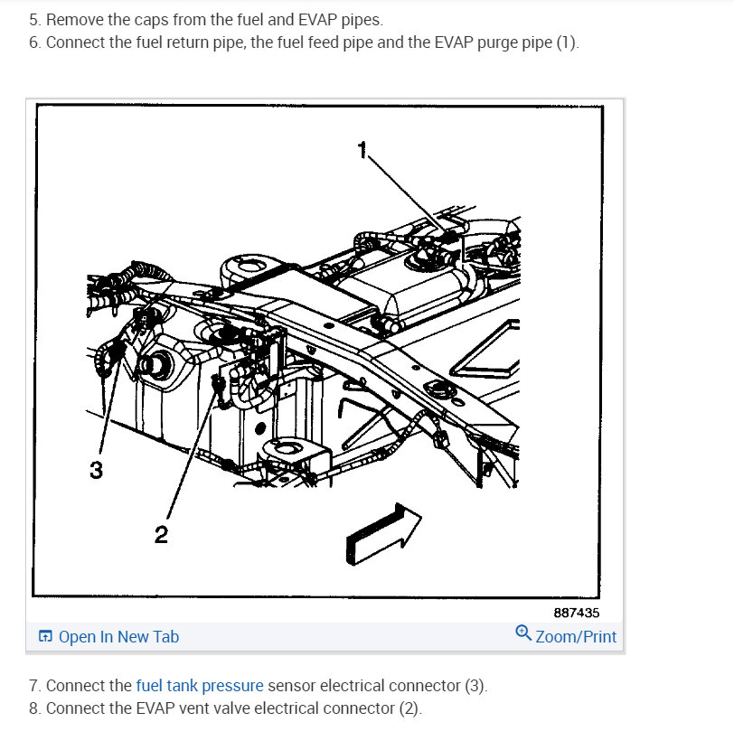

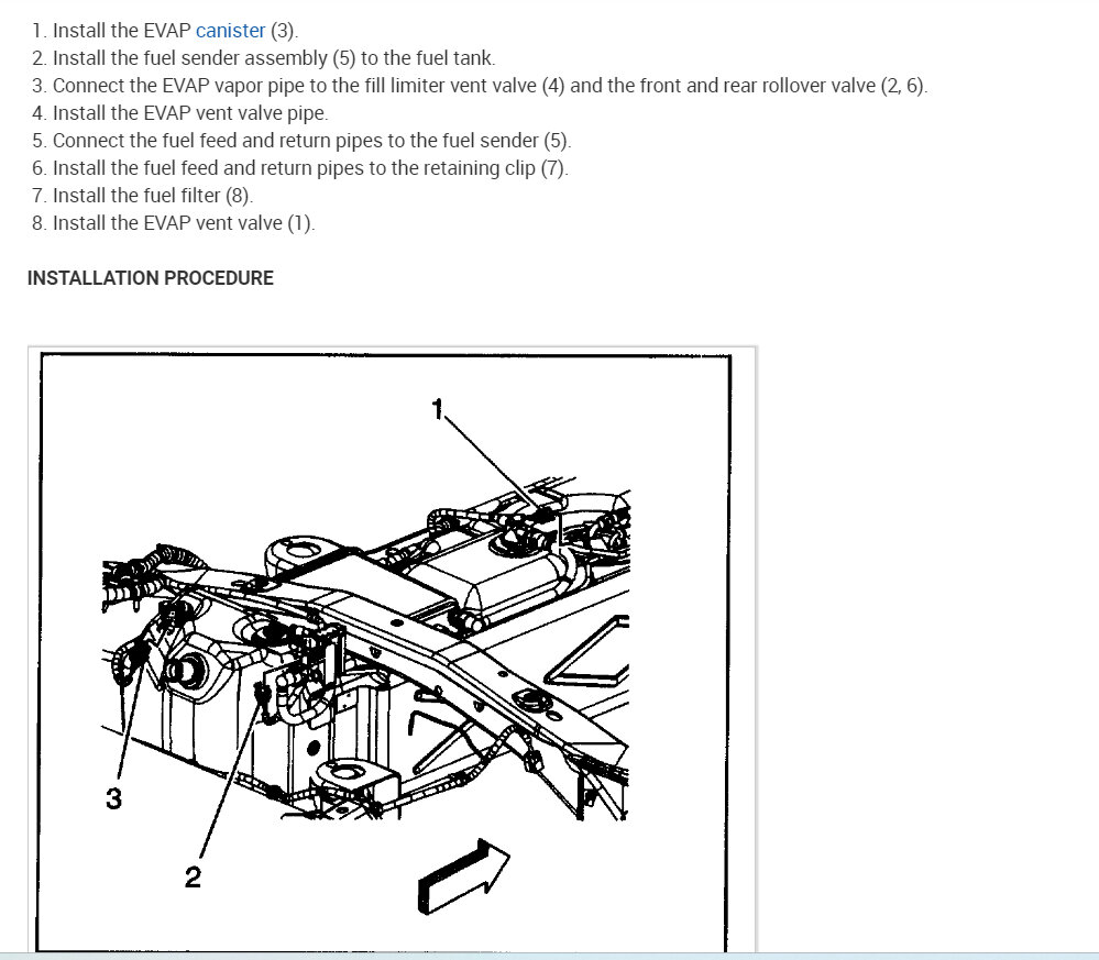

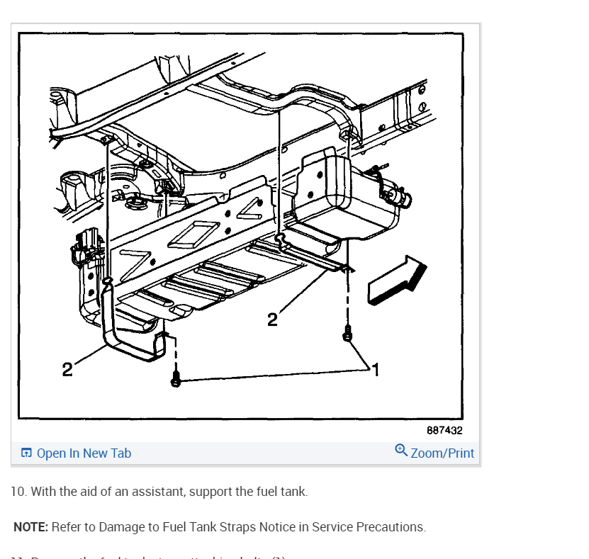

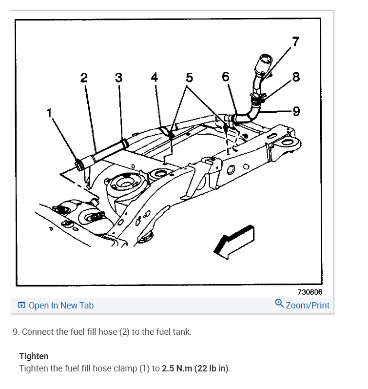

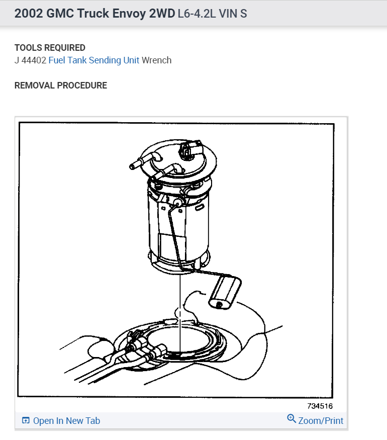

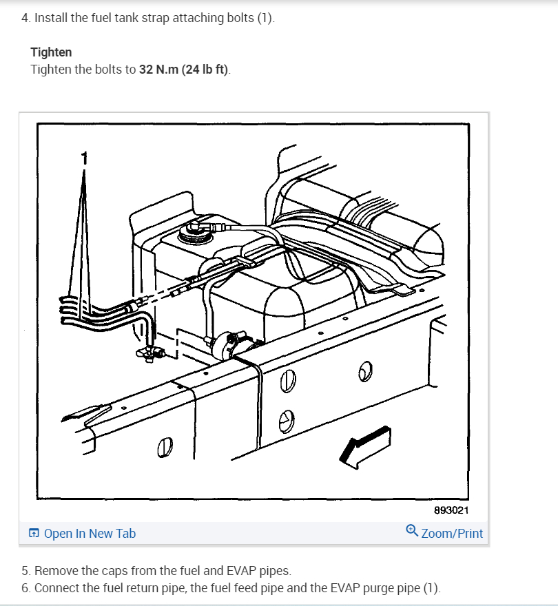

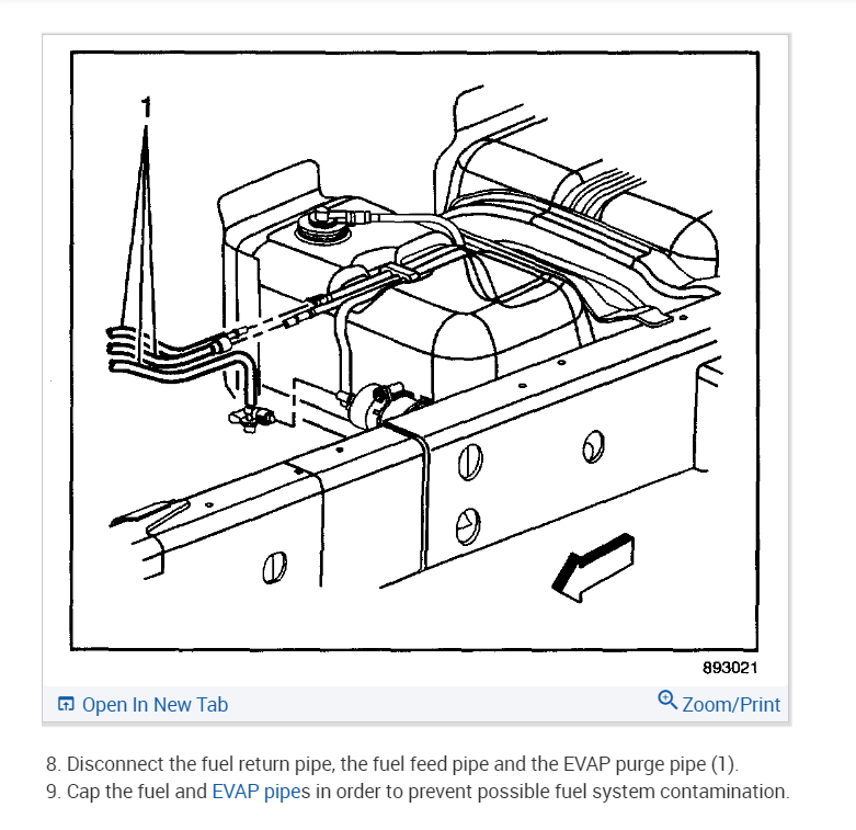

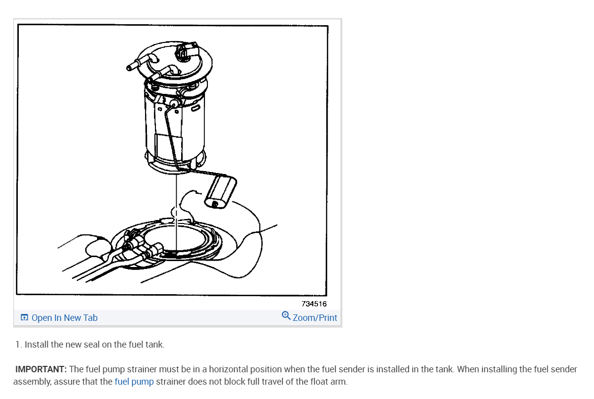

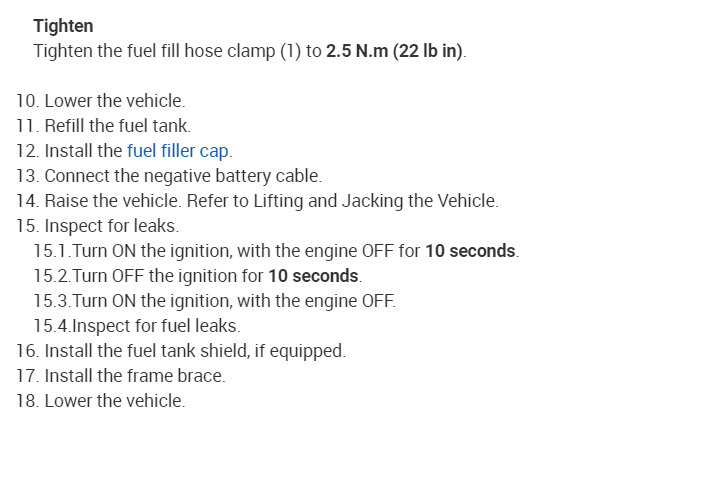

It does sound like the fuel pump is going out or the new pump is defective. To be sure we need to do a fuel pump pressure test. Here is a guide to help and i have included how to do the test on your car and the pressure spec as well. You can rent a fuel pressure gauge at the auto parts store for cheap or free in some cases.
Fuel Pressure .................... 48-54 psi
KOEO Key on Engine Off
I have included how to change the pump out in the images below in case you need them. Check out the images (below). Let us know what happens and please upload pictures or videos of the problem.
