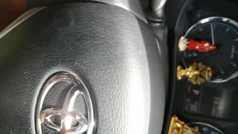

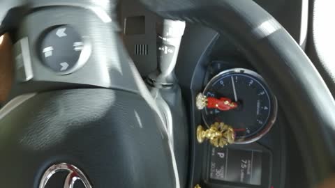

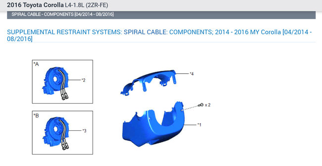

Hello.. Am having some issues on my steering. It's as if there is something oscillating whenever when I turn my steering. As if a marble is oscillating from left to right.. Is it a spiral cable problem? Please advice.

Hello, I'm Danny.

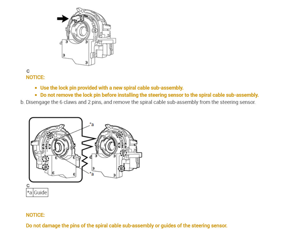

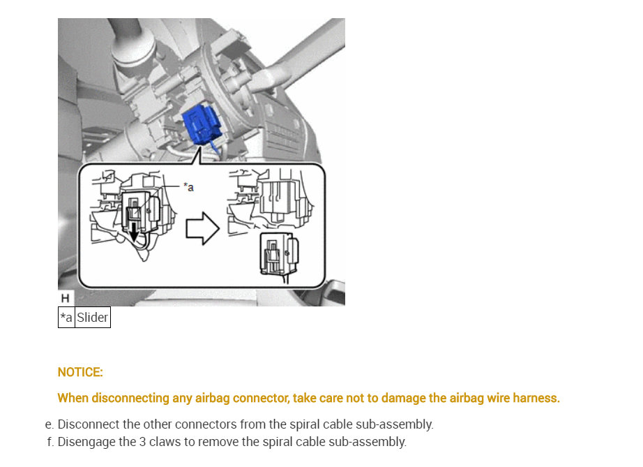

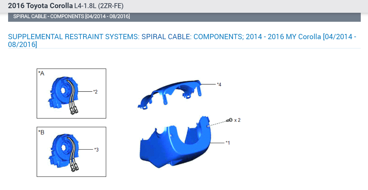

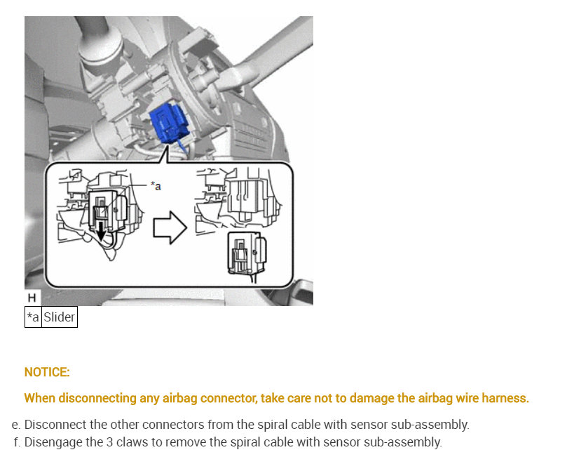

It sounds like you may be having a problem with the air bag clock spring. It is located in the steering column mounted underneath the steering wheel. Here are tutorials showing your possible symptoms and how to replace:
https://www.2carpros.com/articles/symptoms-of-a-bad-airbag-clock-spring
https://www.2carpros.com/articles/steering-wheel-clock-spring-removal
Hope this helps and thanks for using 2CarPros.

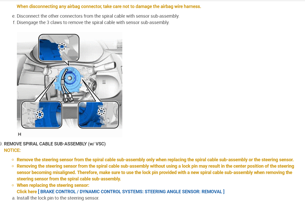

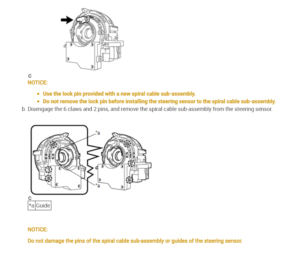

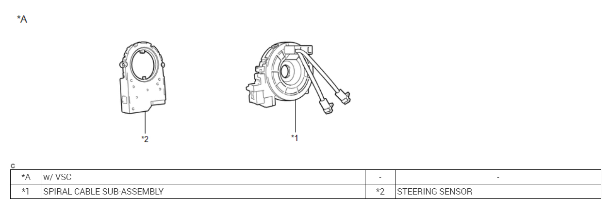

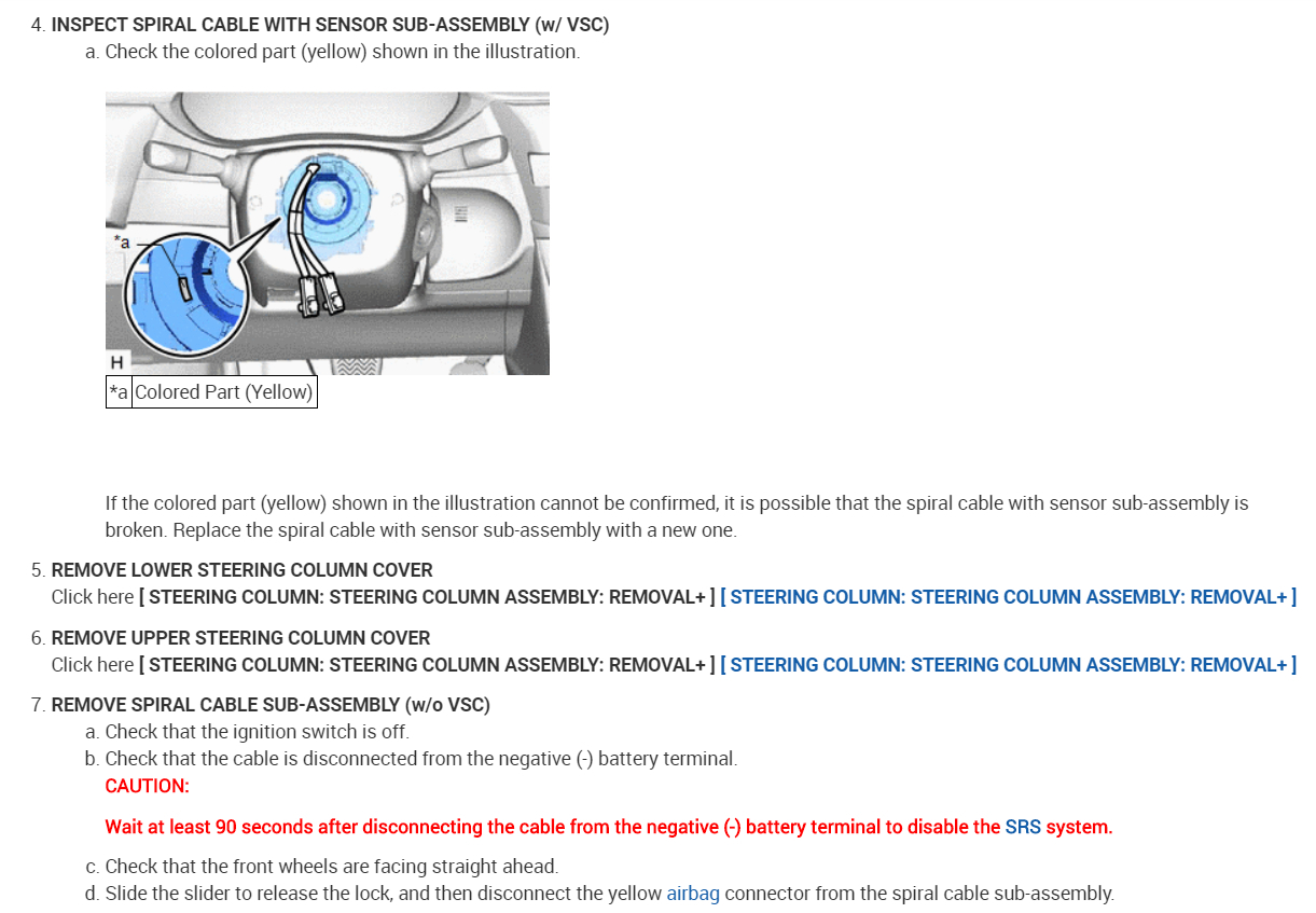

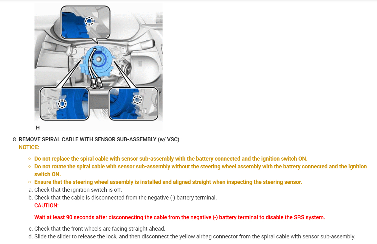

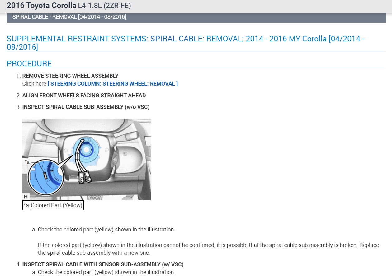

Here are the instructions on how to replace the clock or spiral spring for you to see in the diagrams below. Can you please shoot a quick video with your phone so we can hear the noise? that would be great. You can upload it here with your response. Check out the diagrams (below). Please let us know what you find. We are interested to see what it is.

The noise is as if a marble or a piece of rock is stuck inside the steering badge cover and it is oscillating from here and there. Will try to send you a video as soon as possible.

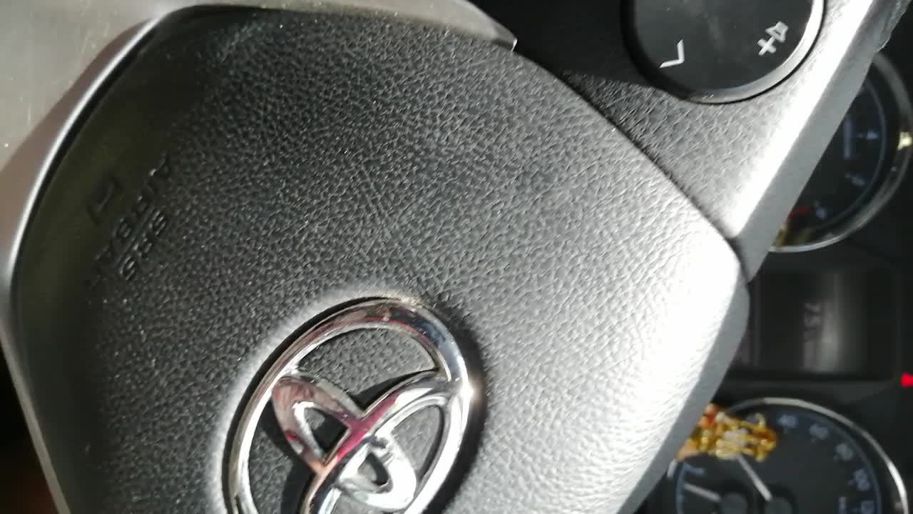

At nearly 1 minute of video.

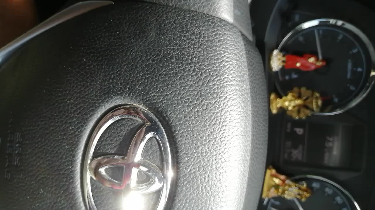

Another video.

Thanks for the video. it does not sounds like the clock spring. can you jack the front of the car up off the ground and try the video again please? Here is a video to help you:
