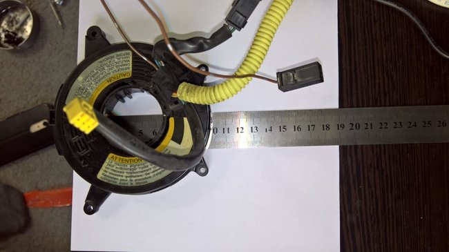

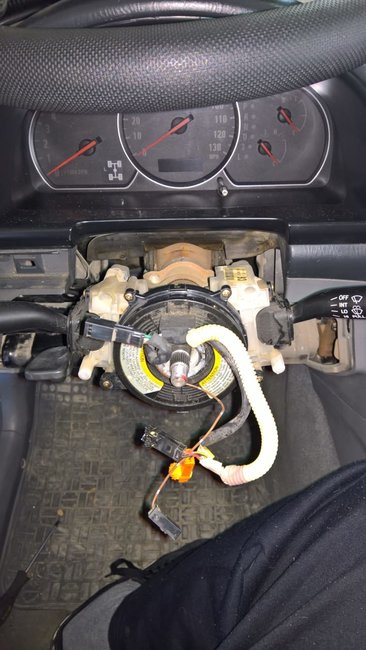

Hello friends,
I need to buy a used or new clock spring but without the turn signal and wipers switch arms. My vehicle comes with cruise and radio steering wheel control. I don't know the OE. Can you please provide me with OEM part number for just the clock spring?
How is the Chinese Clock Spring and where can I find it?

I found online few without the turn signal and wipers switch arms but sellers could not confirm it will fit my vehicle. The new complete assembly is over US$350.00. Can someone recommend trying Chinese Clock spring, and from where I can buy it?

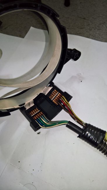

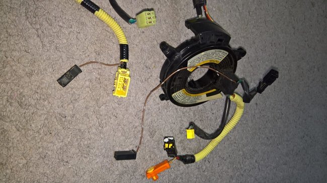

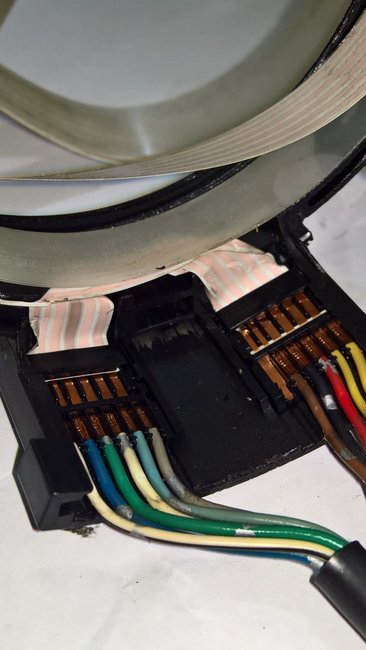

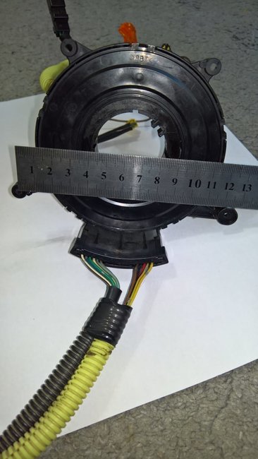

For the past two weeks I was searching for a second hand clock spring online as well as in the local market with no success. Fortunately I heard about an electronic technician who can fix it. In a light speed I went to him, saw his workshop and tools, thought why not trying, my clock spring is damaged after all. He did a great job by replacing the inside ribbon, professional soldering and proper assembling for only US$25.00, I am so happy now my airbag light went off, horn, cruise and radio control back to work and the good thing airbag didn't blow in my face. I just wanted to let you know.
