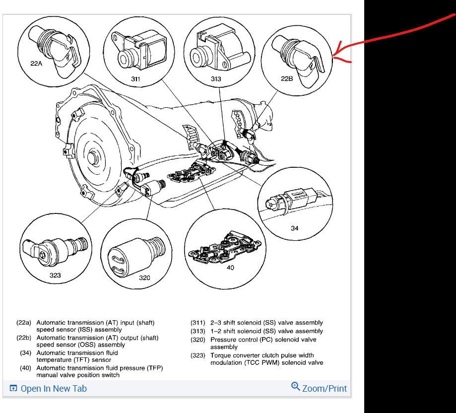

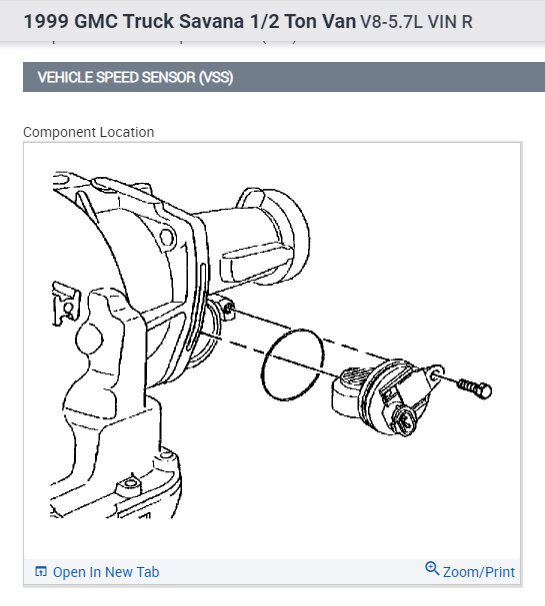

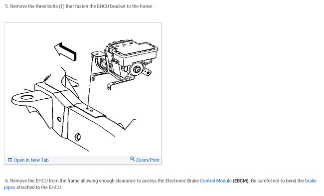

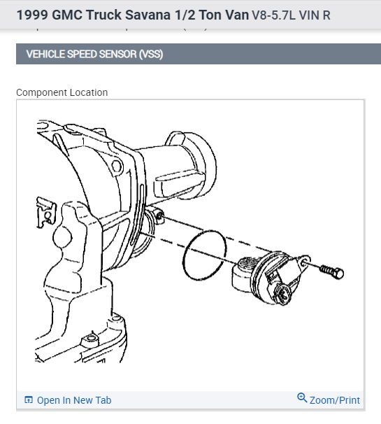

There is a vehicle speed sensor at the rear of the transmission. See pic below. By chance have you checked it? Also, if you have a live data scan tool, you can check if the sensor is sending the wrong signal while driving.
Feb 14, 2023 at 3:27 AM
  • 55,402 POSTS

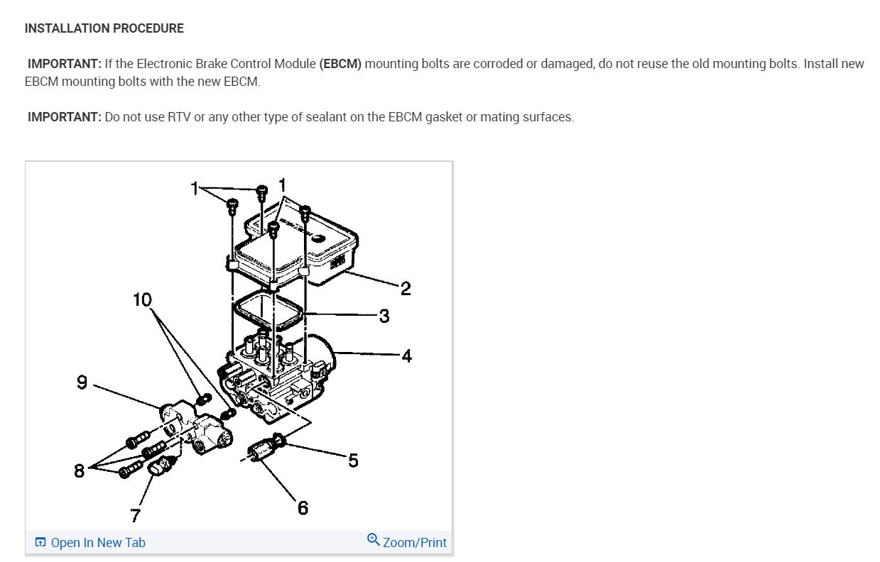

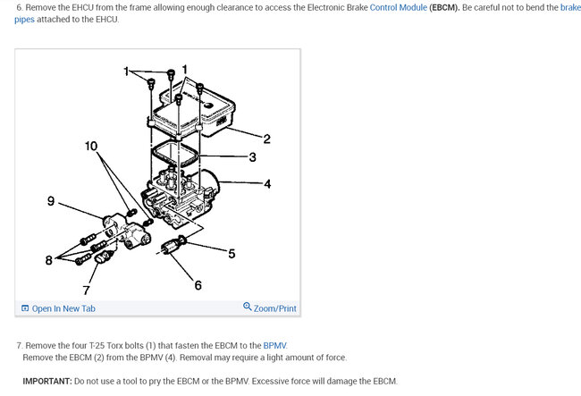

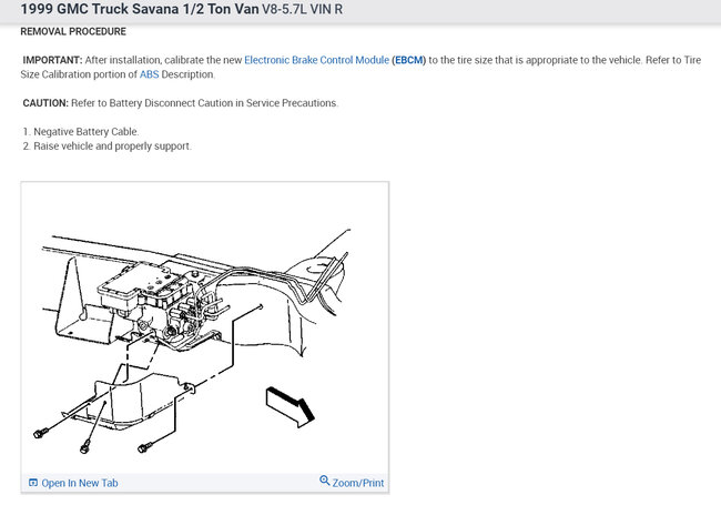

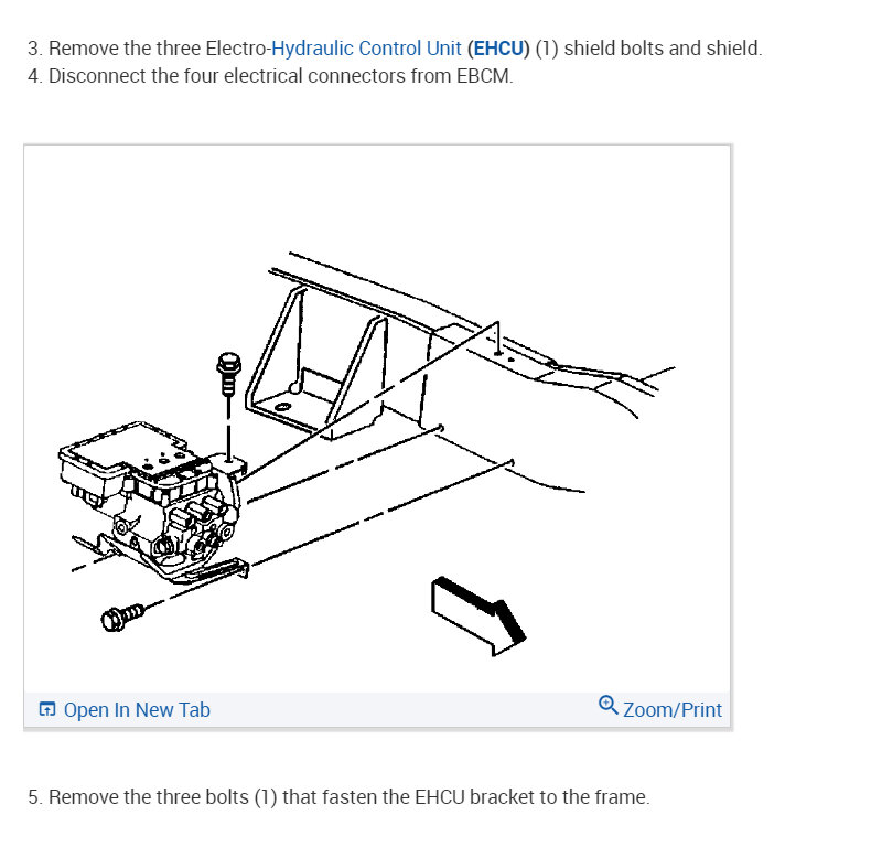

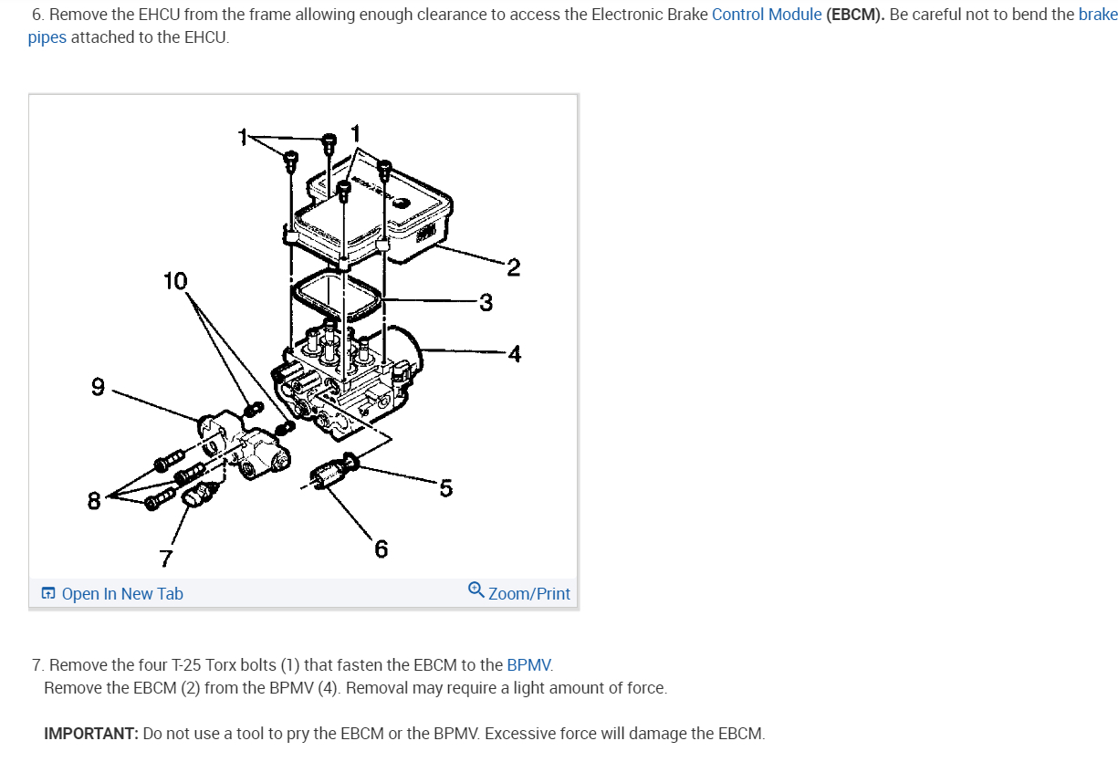

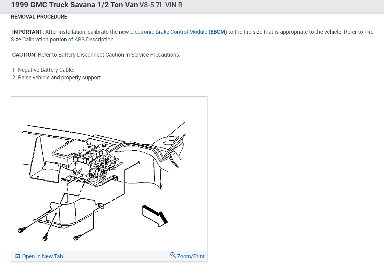

This can be caused by one of two things, the VSS (vehicle speed sensor), the ABS module which is what I am leaning towards because of the ABS light. We should run the codes, here is a guide to show you how:
https://www.2carpros.com/articles/anti-lock-system-testing-and-repair-abs
The first thing we should replace is the VSS (vehicle speed sensor) because it is cheap. Here is the location so you can check the electrical connector and sensor and I have included how to change out the ABS module in case you need it. Please check the images below
