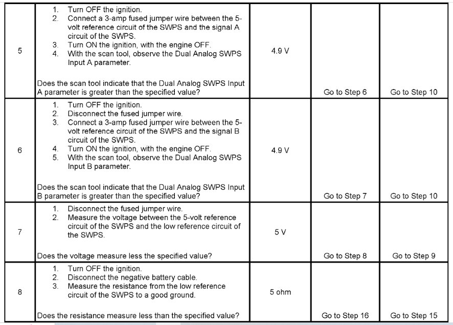

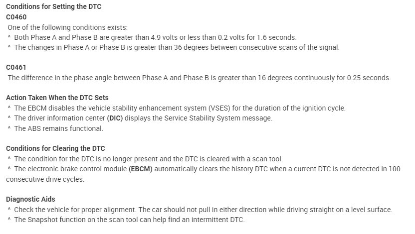

check engine light is not on. service engine and service stability come on display above radio just push button and it goes away. engine works okay, transmission works ok. took it to AutoZone they plugged in scanner. diagnostic trouble codes were power train system -secondary DTCs-po573-00-brake switch circuit 1 high voltage. anti-lock brake system- b3903, c0460-steering position sensor malfunction, c0461-steering position sensor range and u100-class 2 data link malfunction. The odometer has 150000 + miles on it the scanner reads 1385 miles. Can you help? i can't afford to take it to the shop and spend hours looking for the problem unless that's my last resort. i would appreciate any help you can give me, thanks.

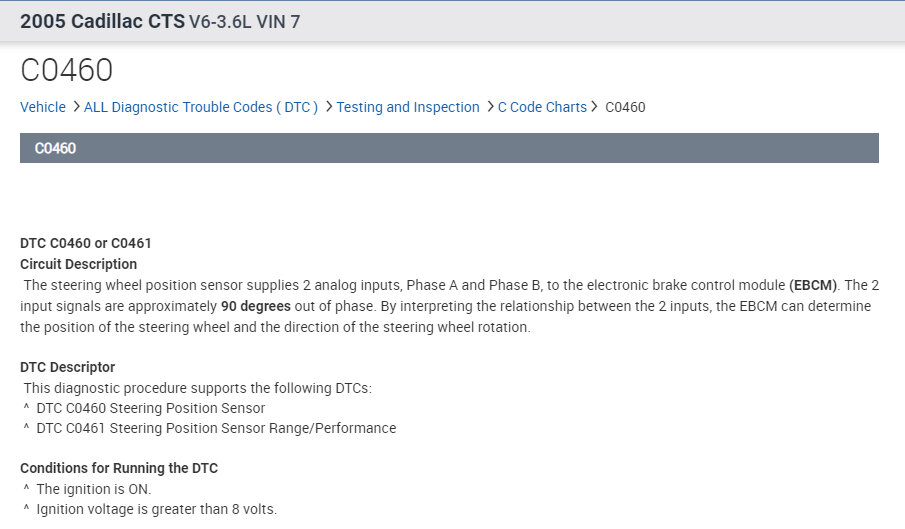

  • 110,246 POSTS

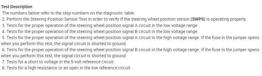

I looked through all the codes you provided, and they are all interrelated. At this point, I feel you should start with checking the steering angle sensor to start.
If you look below, I attached the directions specific to the C0460. You will see how thing things tie together.
Let me know if you are comfortable performing the diagnostics.

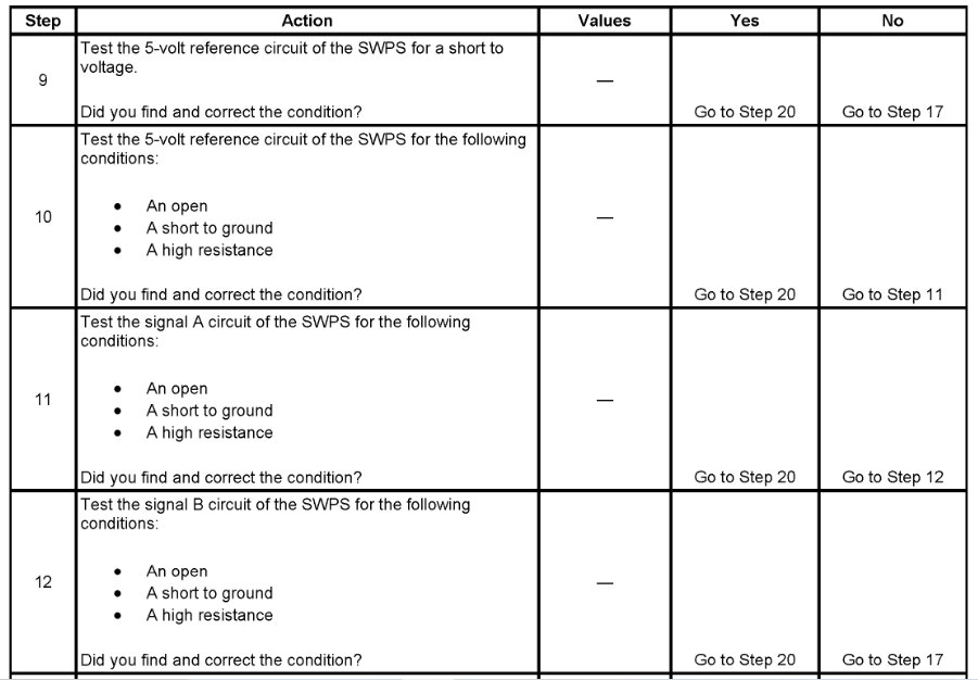

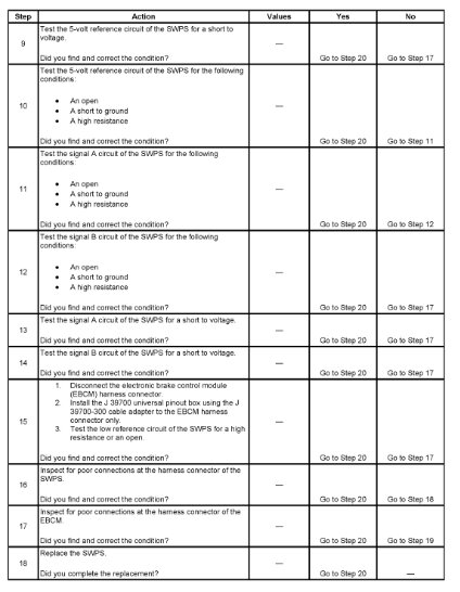

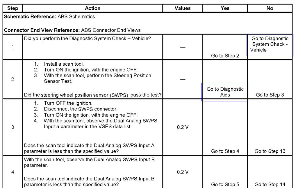

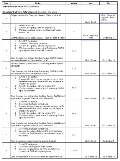

DALE MCCUMONS
  • 11 POSTS
Hi Joe, thanks for your help. The pics you sent the typing is very small and some are out of focus. i tried adjusting them but my printer is old.do you have a link to some that are in better shape. i can't read all of these i would appreciate it. thanks
Oct 22, 2022 at 1:44 AM
  • 110,246 POSTS

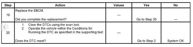

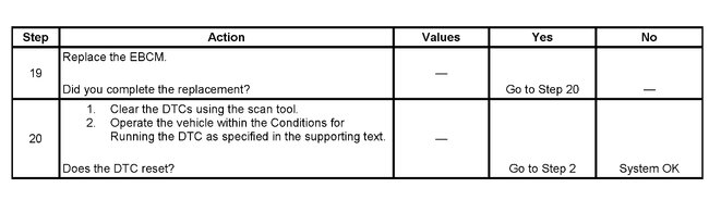

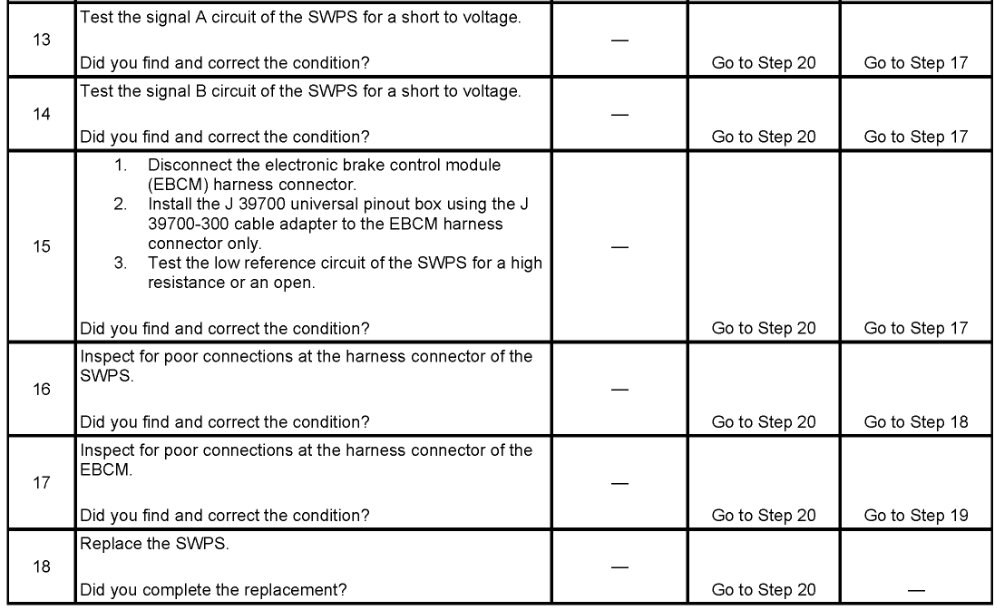

I suspect it's the diagnostic charts. I recopied them below and did half a page at a time, so it is a lot bigger. Let me know if that helps. Also, if you need other pages enlarged, let me know.
Oct 22, 2022 at 2:43 PM
