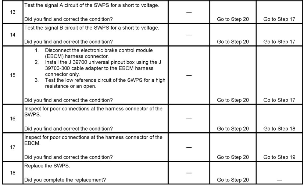

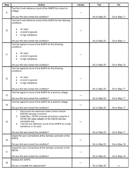

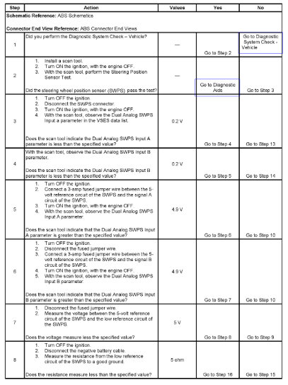

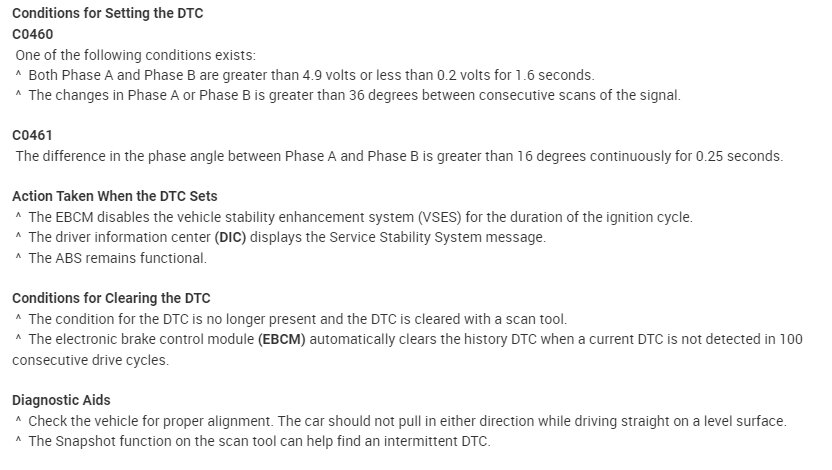

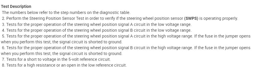

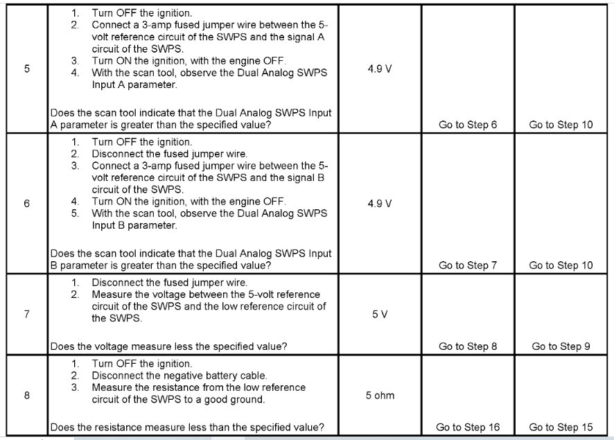

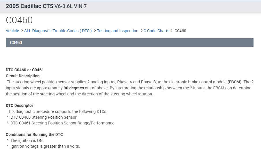

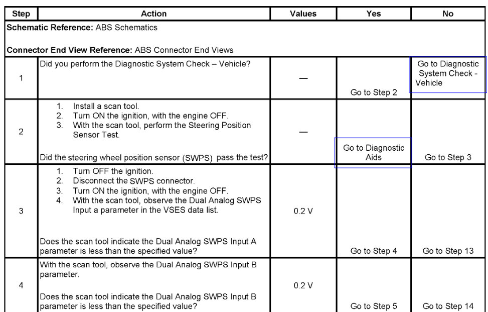

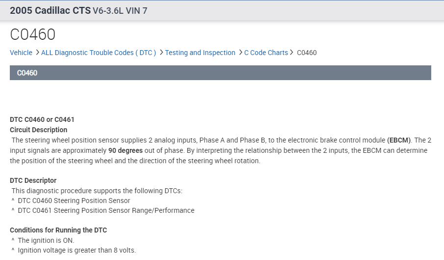

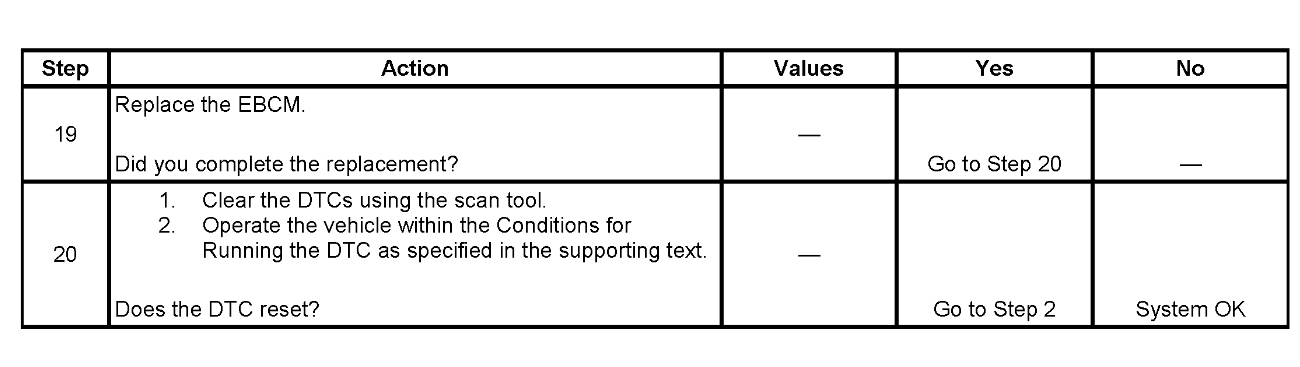

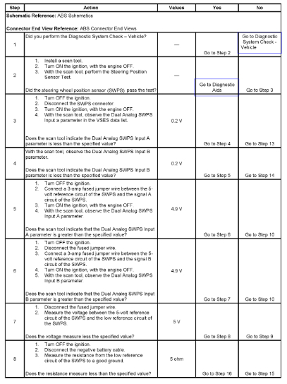

I looked through all the codes you provided, and they are all interrelated. At this point, I feel you should start with checking the steering angle sensor to start.
If you look below, I attached the directions specific to the C0460. You will see how thing things tie together.
Let me know if you are comfortable performing the diagnostics.

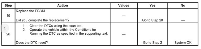

Hi Joe, thanks for your help. The pics you sent the typing is very small and some are out of focus. i tried adjusting them but my printer is old.do you have a link to some that are in better shape. i can't read all of these i would appreciate it. thanks
Oct 22, 2022 at 8:44 AM
  • 110,194 POSTS

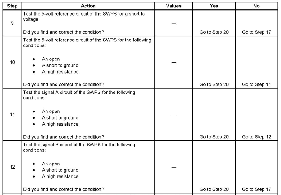

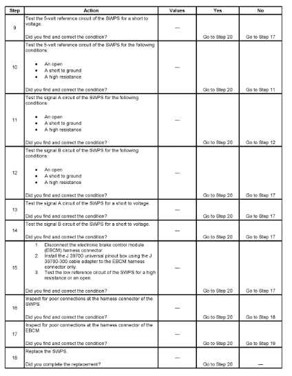

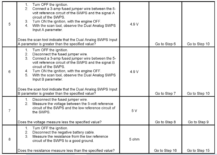

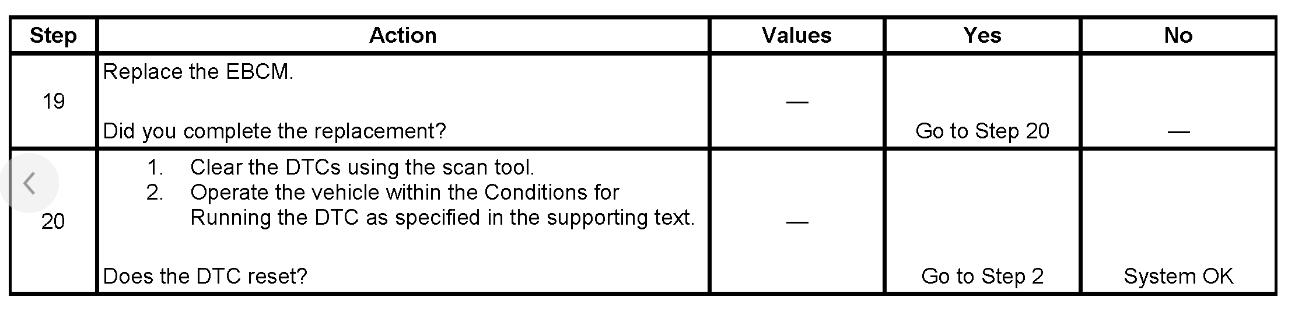

I suspect it's the diagnostic charts. I recopied them below and did half a page at a time, so it is a lot bigger. Let me know if that helps. Also, if you need other pages enlarged, let me know.
