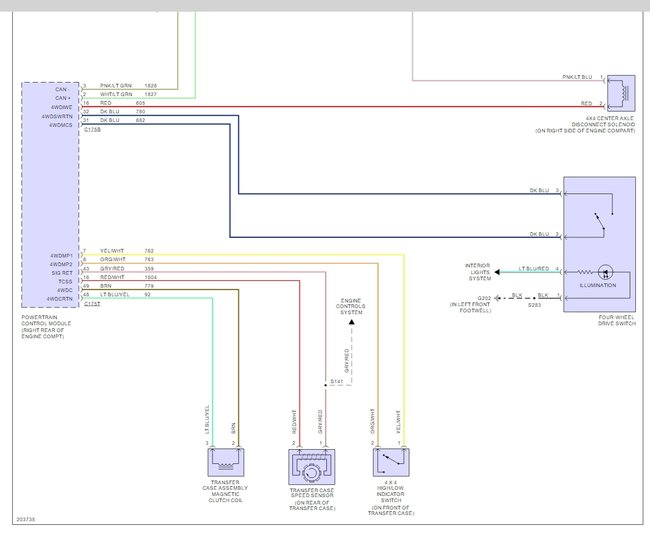

When driving the speedometer is reading eighty mph when doing about thirty mph. I have checked the speed sensor and gauge cluster, they are both fine. Rear gears have not been changed. What could throw it off this far?

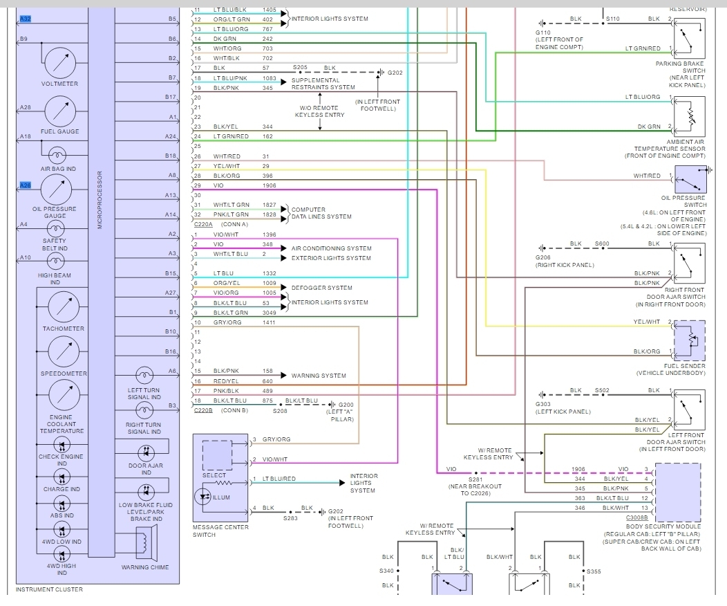

The speedometer has a microprocessor that goes bad in the cluster which feeds info to the transmission. I would try replacing the cluster first, here is a wiring diagram to show the cluster wiring. Check out the diagrams (Below). Please let us know what happens.

actually a friend of mine has the same truck and he let me switch gauge clusters with his to see if it would change anything and it didn't.

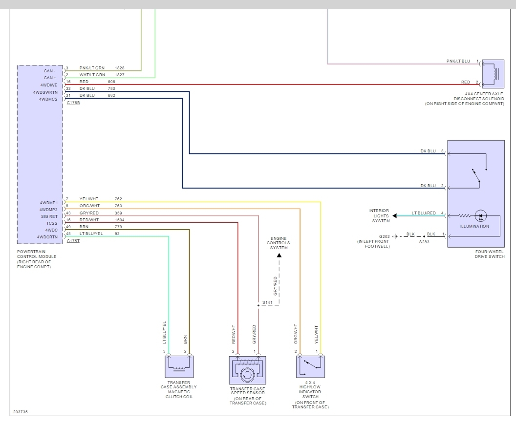

Okay, here is the wiring for the VSS is goes into the BCM so it's either bad or there is a bad connection somewhere causing high resistance in which case you will need to do a pin to pin check here is a guide to help you.

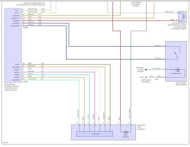

It's definently not a bad vss sensor as i've tried 3 different ones and none have changed anything. I'll look into the wiring link you gave. Also, do you know where I could find the wiring diagram for the electric 4x4 actuator motor?

Yep I saw that, I meant the BCM was bad, here is the rest of the wiring you needed, let me know what you find out.

Okay, so I've done some testing and learned some stuff. I used my obd 2 reader to check the speed and it corresponded to the gauge cluster so it's definitely an issue at the pcm or before it. Also I tested the 2 wires in the vss plug for ohms like you said above and they both came back with about .5 ohms so they should be fine. If these wires are fine then doesn't that only leave the pcm to be at fault? Or is there something I'm forgetting?

Its sounds like you got everything and the PCM is the fault. It happens, please let us know if that fixes it so it will help others

Got my new pcm in. Swapped it all out and now it is working thank you.
