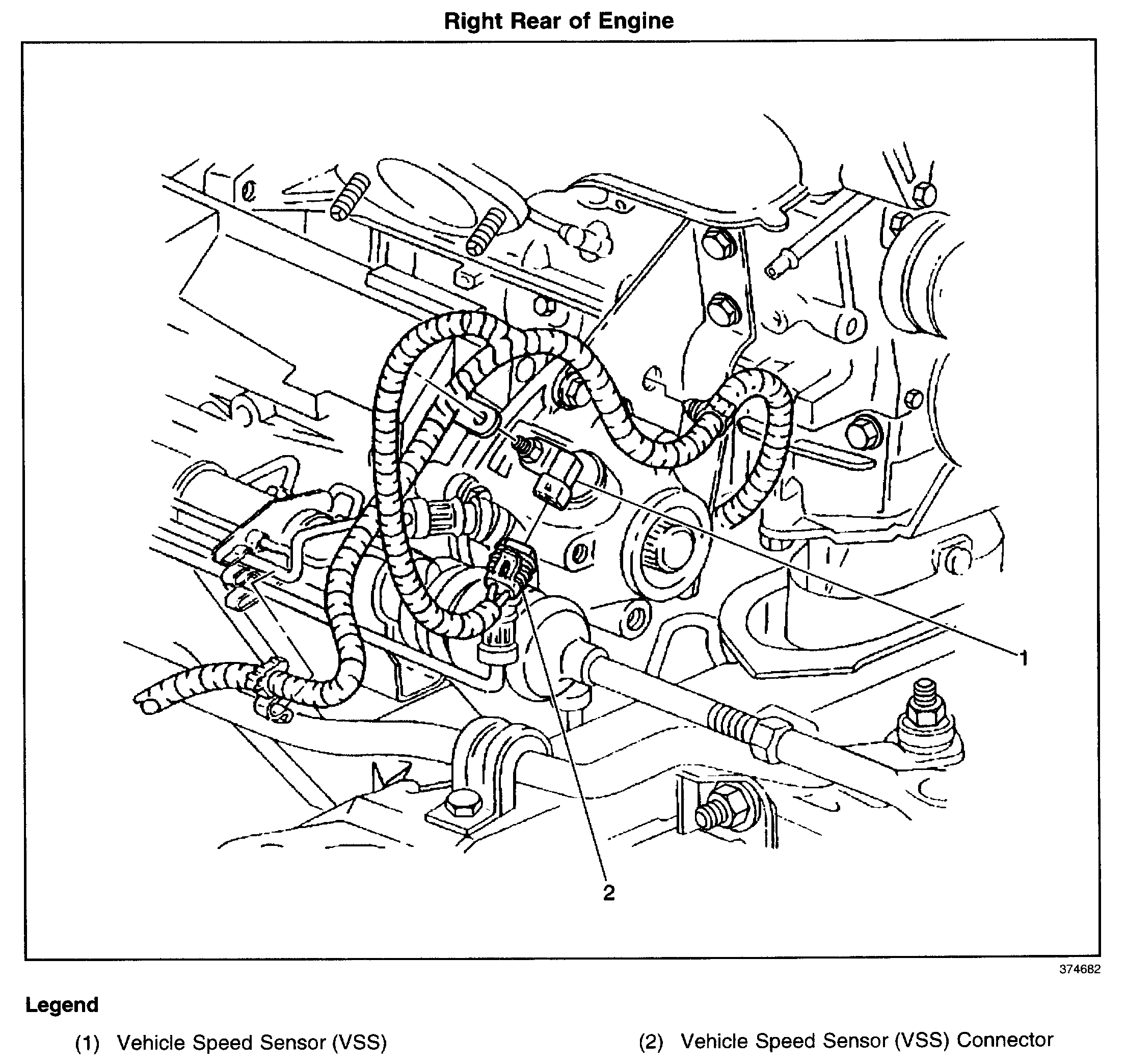

Two speed sensors, one i replaced behind transmission and axle, but second sensor is for speedometer cable VSS. I can't locate that one. I have the part picture I sent you. where is it located and can you show me diagram?
Apr 16, 2019 at 7:00 AM
  • 110,244 POSTS
Welcome to 2CarPros.
The VSS is located at the rear of the engine/trans-axle. See the attached picture and let me know if that helps. Check out the diagrams (Below). Please let us know if you need anything else to get the problem fixed.

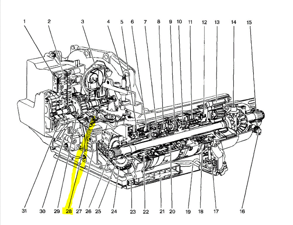

The input speed sensor on this vehicle is located internally. You will need to remove the pan. In all honesty, if I recall correctly, the transmission needs to be removed.
If you look at pic 3in, it shows the location of the sensor.
Here are the directions for removal. The attached pic correlates with the directions.

22. Input Speed Sensor Removal
Vehicle Transmission and Drivetrain Automatic Transmission/Transaxle Service and Repair Overhaul 4T40-E/4T45-E Automatic Transaxle Repair Instructions 22. Input Speed Sensor Removal
22. INPUT SPEED SENSOR REMOVAL
see pic 1
1. Remove the wiring harness connector at the input speed sensor (46).
2. Remove the input speed sensor bolt (15) and the input speed sensor (46).
3. Remove the wire retainer clip bolt (15) and retainer clip.
_______________________________

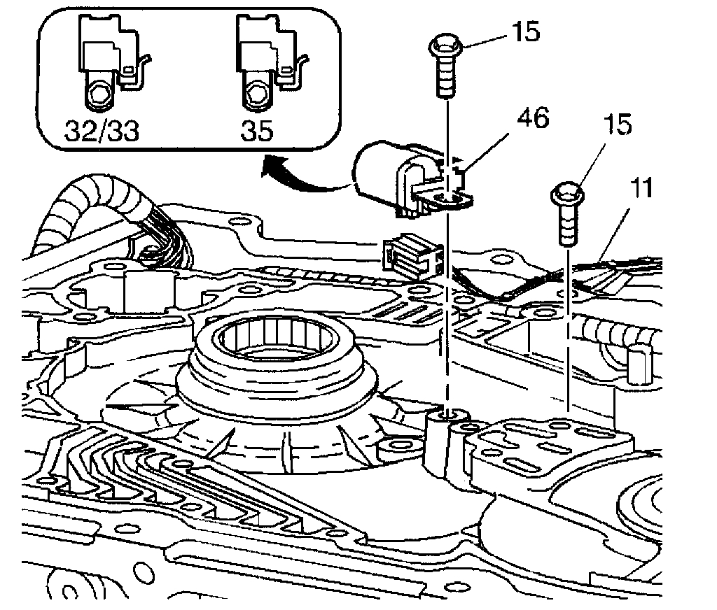

2000 Pontiac Grand AM L4-144 2.4L DOHC VIN T SFI
85. Input Speed Sensor Installation
Vehicle Transmission and Drivetrain Automatic Transmission/Transaxle Service and Repair Overhaul 4T40-E/4T45-E Automatic Transaxle Repair Instructions 85. Input Speed Sensor Installation
85. INPUT SPEED SENSOR INSTALLATION
Important:
^ The tab on the sensor housing (46) fits into the recess on the case boss.
^ For drive sprockets with 35 teeth, use a black sensor housing. For drive sprockets with 32 or 33 teeth, use a natural colored sensor housing.
pic 2
1. Assemble the input speed sensor (46) to the transmission case (51).
Notice: Refer to Fastener Notice in Service Precautions.
2. Install the input speed sensor bolt (15). Hand start the bolts.
^ Tighten the input speed sensor bolt to 12 Nm (9 ft. lbs.).
3. Route the input speed sensor wiring harness in the case channel.
4. Connect the input speed sensor connector to the input speed sensor.
5. Install the wire harness retainer and wire harness retainer bolt.
^ Tighten the wire harness retainer bolt to 12 Nm (9 ft. lbs.).
