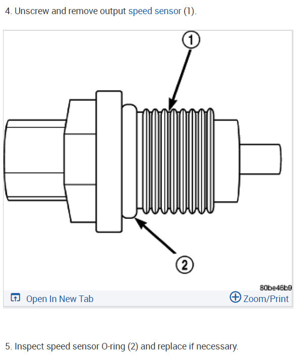

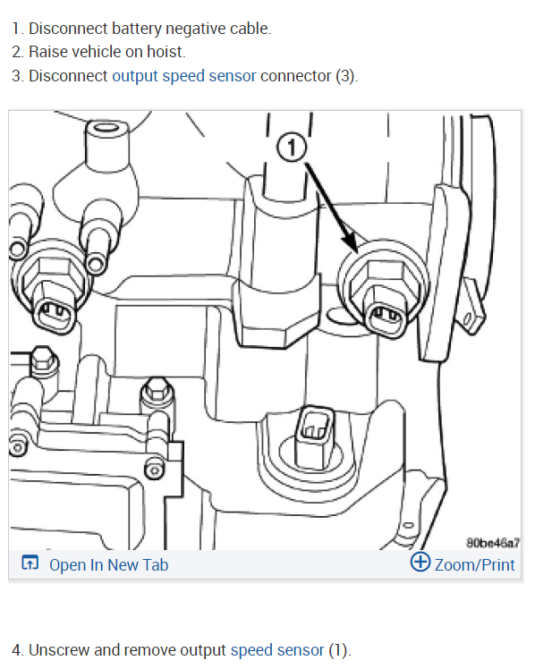

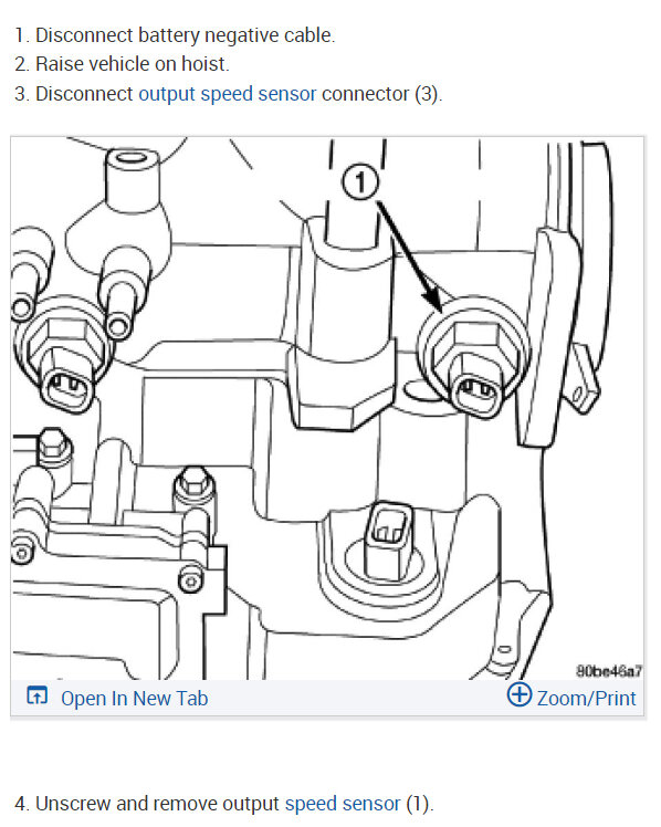

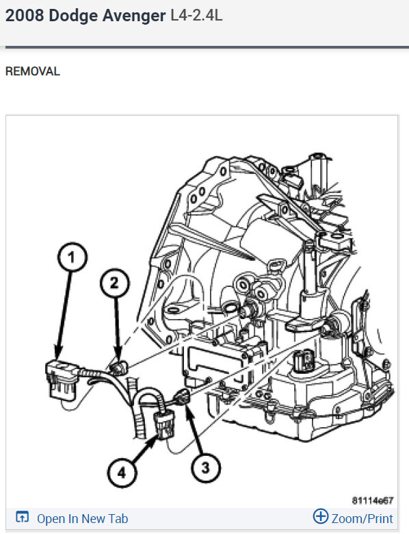

This could be caused by a couple of things. First, there is an output speed sensor on the transmission that could be failing or even have a faulty connector. Inspect the wiring and connector. Physically disconnect it and inspect it for damage, connector pin damage or excessive corrosion or dirt. See pic below for the location.

Here is the location of the VSS sensor so you can check it out. Check out the images (below). Please let us know what happens.
