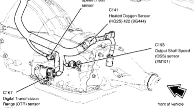

The transmission went out on it I went to the junkyard got another one the transmission speedometer sensor is not on the transmission that I bought will it still start and run without the sensor?

Sure it will start and run but it will not shift the transmission and you will have a check engine light on. Is there no place for the sensor? Every transmission should have one. Check out the images (below). Please upload pictures or videos in your response

Thanks you guys saved me a lot of work.
