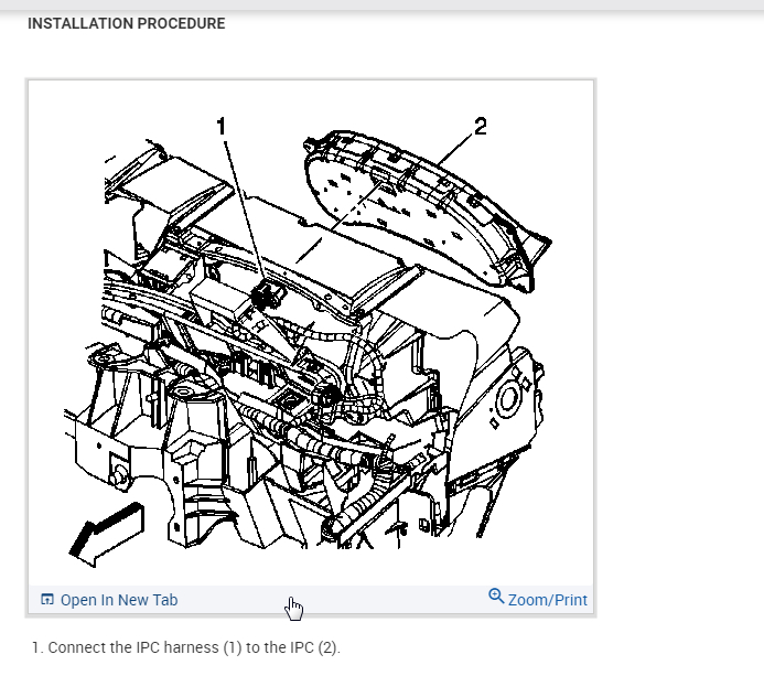

At first the speedometer was stuck at 65, then it started moving, but was higher. When doing 70 was reading 120.
Nov 3, 2019 at 5:22 AM

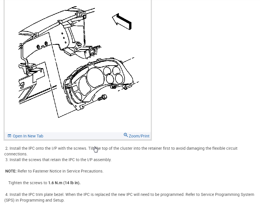

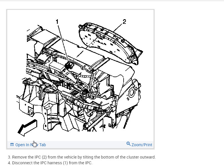

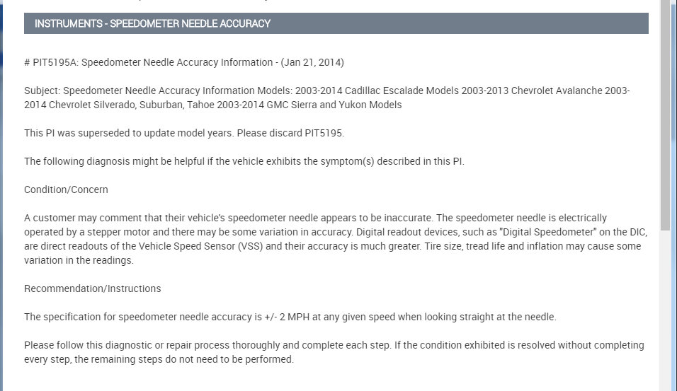

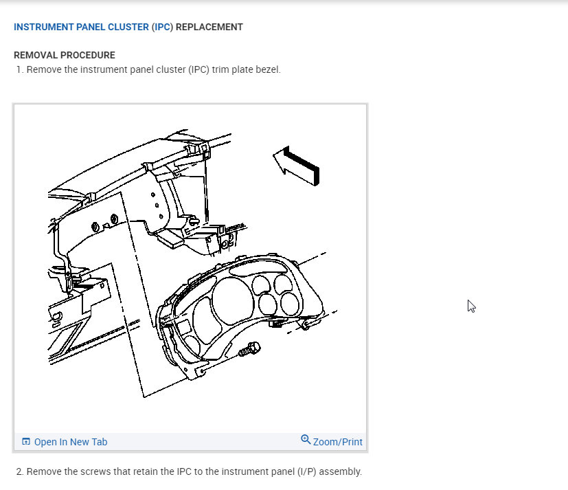

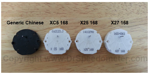

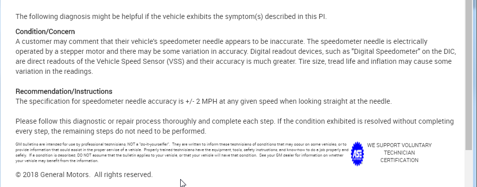

More than likely this is the stepper motor in the cluster that controls the gauge. Normally it starts with one gauge but then the others will most likely follow.
I attached the process for removing the cluster and some TSB information that explains the motor is the most likely cause.
Here is a video that shows how to replace the stepper motor once you get the cluster out:
https://youtu.be/UkbLsuKs5Lo
Let me know how you make out. Thanks
