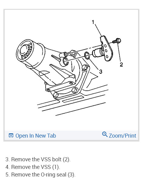

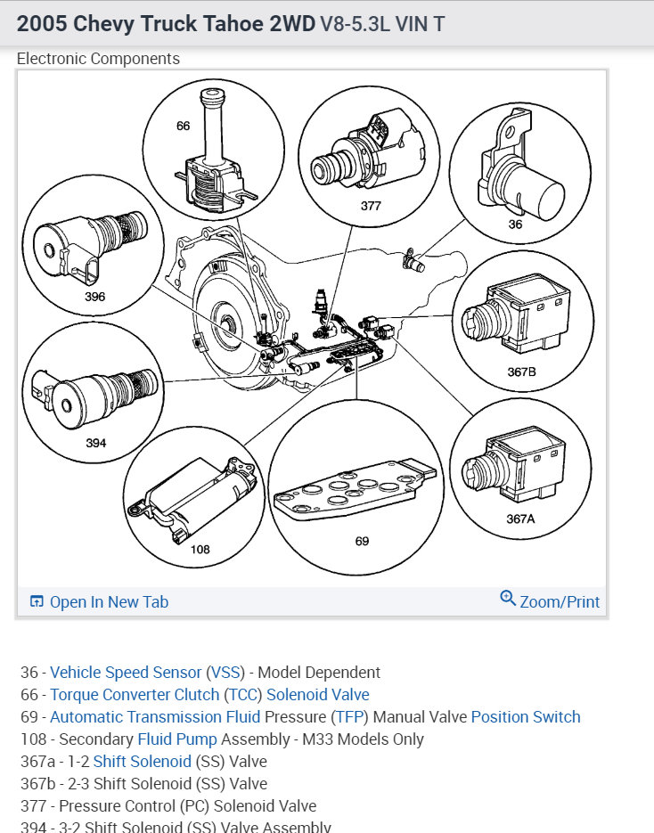

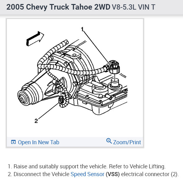

The vehicle speed sensor (VSS) is located on the right rear of the transmission. Check out the diagrams (Below). Please let us know if you need anything else to get the problem fixed.
Images (Click to make bigger)

I just bought a used 2004 chevy tahoe z71. I drove off the lot and made a stop to get something. After I got back in my truck and started it up I noticed that the speedometer gauge was on 80 but I was parked. As I drove off it increased like it should but it was registering way to high. As I got up to highway speed and got home it was buried at 120. I already called the salesperson but I can't get it back in until monday. Can you please tell me what is wrong so I know what to expect before I get there monday?

More than likely they will hae to replace the cluster assembly. I have ran across this a few times but it has always been on the trailblazers.

Thanks for the advice and knowledge. I took it in today and thats exactly what they said, it needs a new cluster assembly. I appreciate the knowing what to expect going in. Thanks again.
