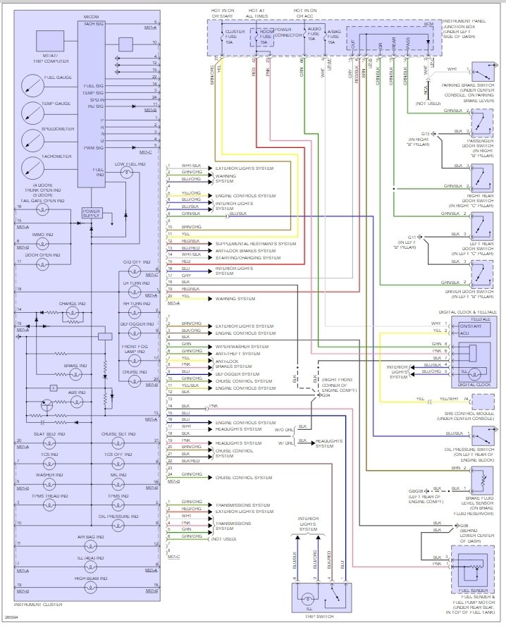

So, replacing the cluster did nothing. It is the same issue. Today I drove back from a place 2 hours away with my old cluster still in. When I drove it this morning, the old cluster did just fine all the way home for 2 hours of continuous highway driving. It is when I got closer to home where it was stop and go, that it quit working. I replaced the old cluster with the new one I purchased, and the speedometer is still not working. Once I let the car sit for an hour and cool, it will work again. It seems that it goes out in normal stop and start commute driving. When I go on the highway, it does just fine, as long as I get there before it quits working. Any ideas on the situation now?
Apr 30, 2016 at 7:18 AM
  • 55,782 POSTS
Hey Chris,
It looks like the speedo is feed by the cruise controller, this unit maybe heating up and then failing, I wanted to ask the the VSS still show a reading when the speedo is not working? if so the cruise unit could be at fault, here is a diagram.
May 2, 2016 at 3:37 AM
CHRISTOPHER MICAH ST CLAIR
  • 5 POSTS
When the mechanic plugged in his reader and drove the vehicle, he could see the speed reported on his device even though the speedometer was not working. This, he says, means the VSS is working properly. I saw another post saying that there is a short in the signal wire that goes from the speed sensor to the back of the cluster (through the firewall). Apparently when they cut that signal wire and replaced it, the speedometer worked properly again. Problem is, I have no idea where that wire is or how to replace it through the firewall.

I have seen a similar problem on the Saturn's 1991-1994.The speed signal that drives the speedometer goes thru the electric power seat belt module then goes to the speedometer.So when that part of the module we bad you could lose your speedometer reading.
May 3, 2016 at 5:19 AM
  • 55,782 POSTS
Thanks saturntech9,
It looks like the speedo feed goes through the cruise control unit, grn/org wire, I would try a new wire locate it from the sensor to the cruise control unit first, or replace the cruise control unit.
May 3, 2016 at 6:41 AM
SATURNTECH9
  • 30,868 POSTS
Or get some of those bullet style male female connectors so you can bypass the cruise control module to see if it's bad.Before investing in a cruise module.
