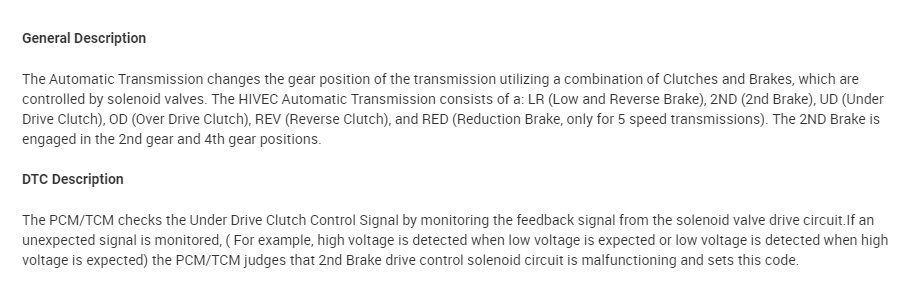

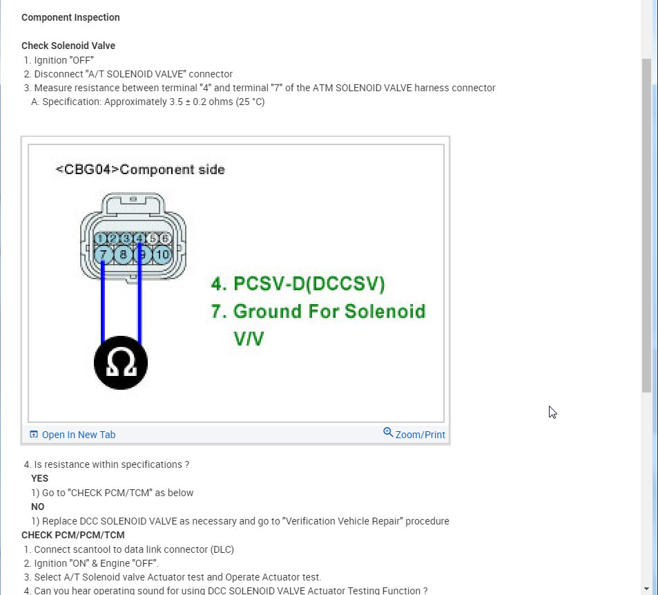

So the initial problem was speedometer/odometer stop working . That's when I noticed the shifting issue, which sounds like a limp mode because vvs not working but code reader shows speed when driving.
Total list of codes PO700 is under stored. And P0713, 0760,0750, 0743, 0707.
Oct 6, 2020 at 8:15 AM

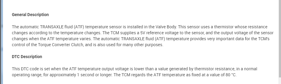

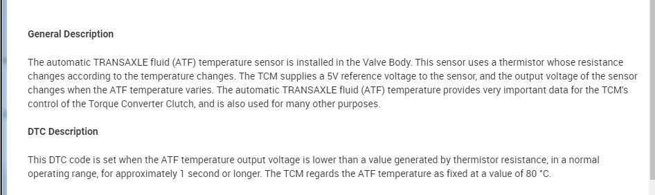

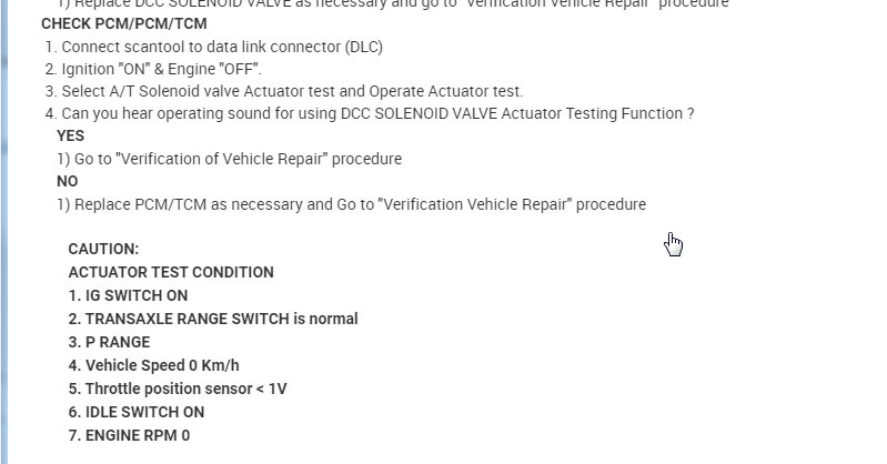

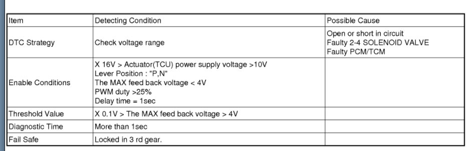

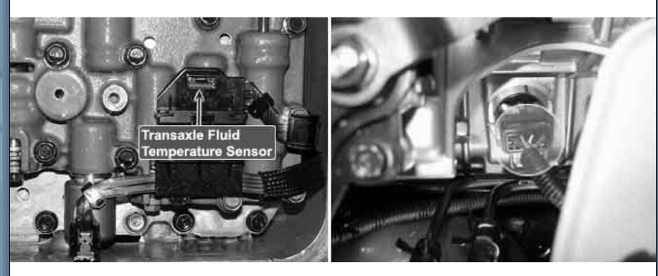

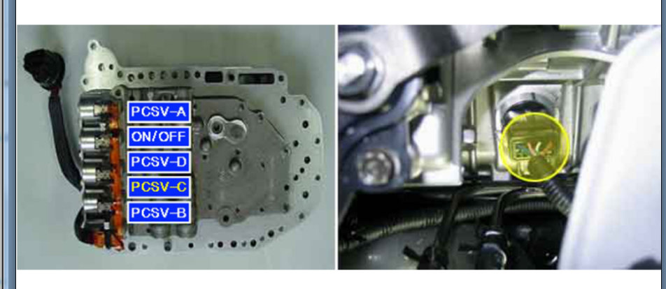

More then likely you have an issue with the connector shown in the attachments or the circuits for the solenoid valves. These codes are for the 2/4 solenoids, on/off solenoid, and the torque converter solenoid. Also a faulty PCM could be causing this so let's run through this info and see what comes up.
