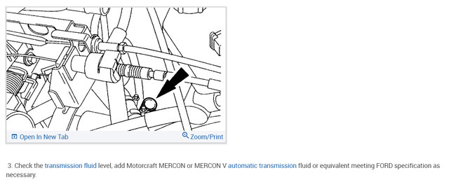

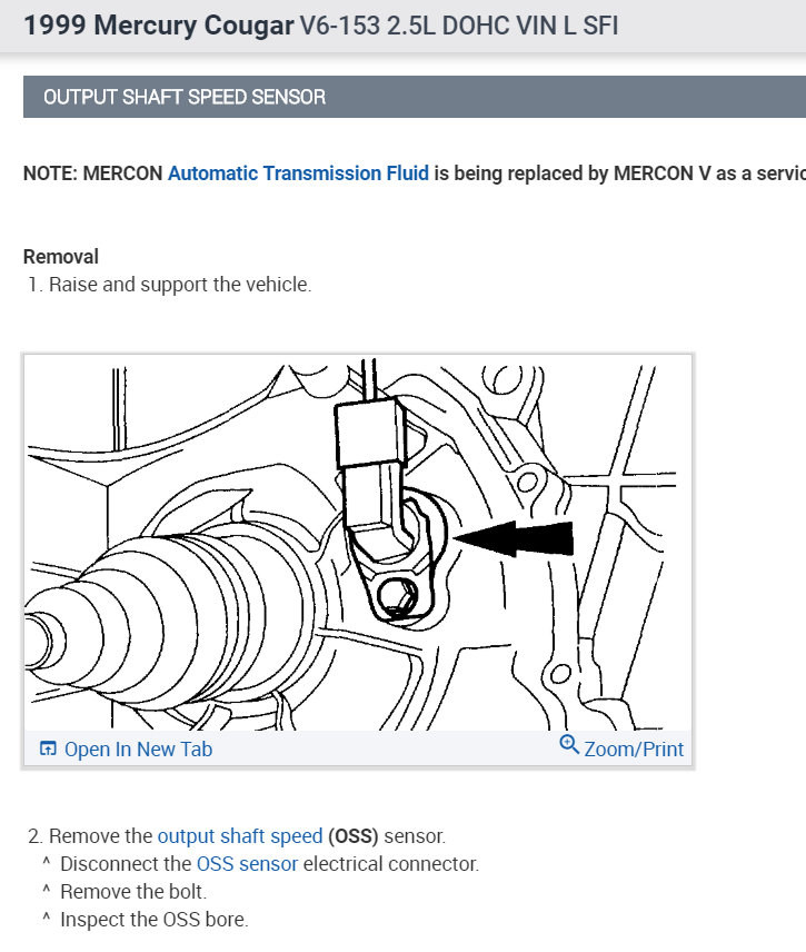

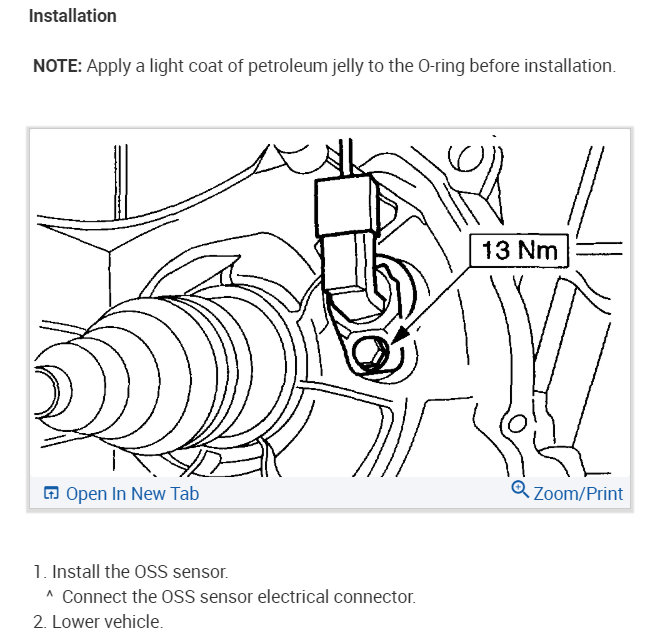

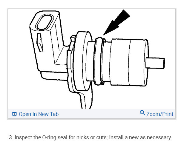

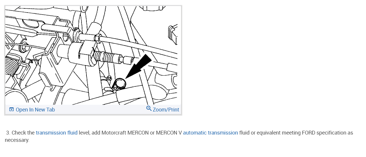

No speedometer no cruise control.
May 1, 2019 at 7:35 AM
Experienced Mechanic
55,743 POSTS
It sounds like the vehicle speed sensor has gone out (VSS). here are instructions and diagrams below to show you how to replace the sensor. Check out the diagrams (below). Please let us know what happens.
